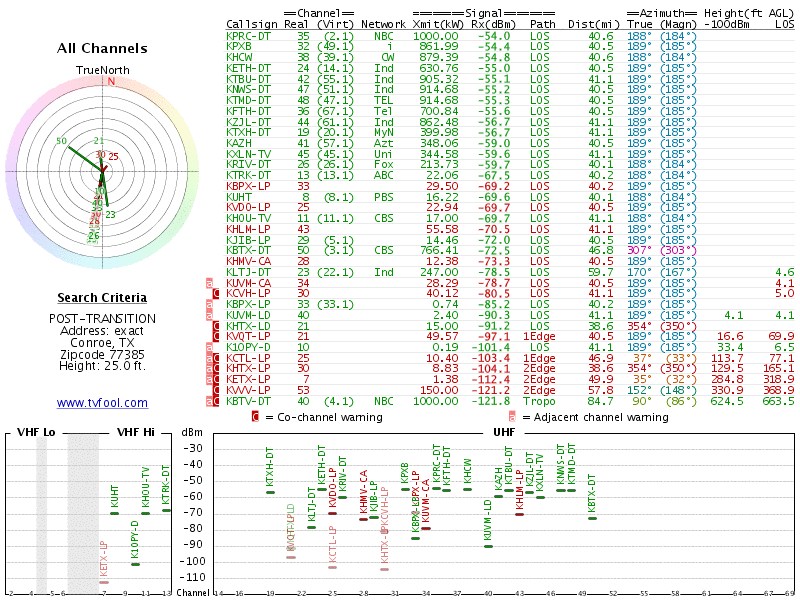

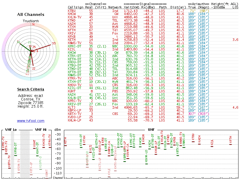

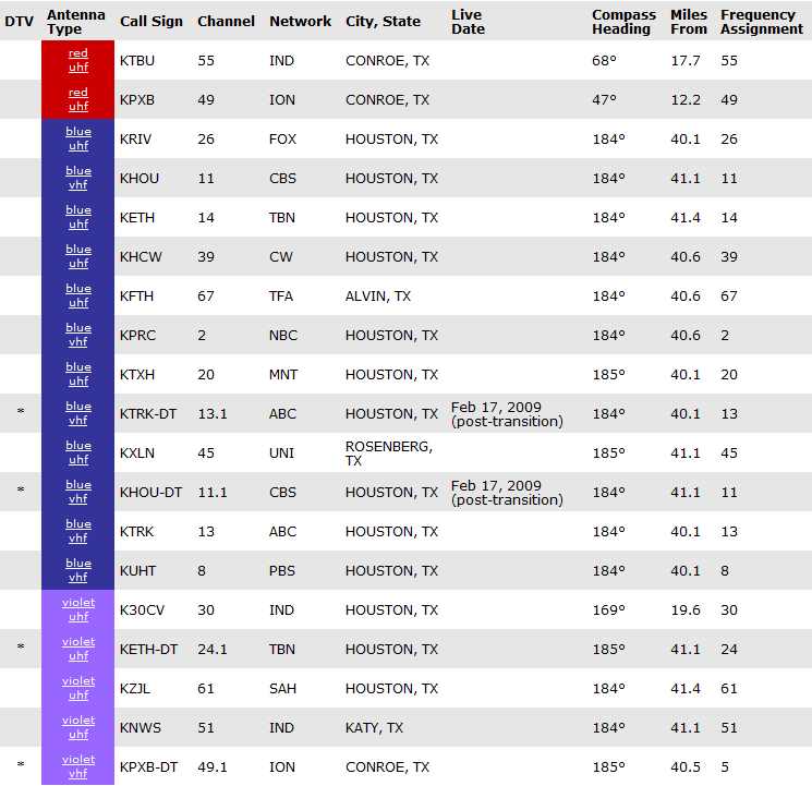

Here are two things that entered in. One from Antennaweb and the other from Tvfool. I don't know exactly what they mean. Can anyone recommend an appropriate setup? I am not too concerned with how much it costs and I don't have a whole lot of room in the attic to set something up and would rather not have a giant antenna on the top of the house.

I think if you may be looking at needing and unobstructed model mounted roof top; depending on what all you want. I see a distant NBC chnl 2, but you also have access to another NBC. If you want the chnl 2 you will also need VHF

Channel 2 NBC is a must. I'm not sure what you mean by another NBC? I could be missing something, but the only NBC I know of is channel 2. When I look on the TVfool data sheet, it mentions KPRC (channel 2) as 35.1. Would that be what you are referring to?

I checked Conroe, TX on antennapoint.com. There are a whole bunch of stations almost due south of you on a heading of 185°, including the major networks, all within 44 miles. Just buy a good medium range UHF antenna. Newer digital antennas like the DB-4 from antennasdirect.com are small and very powerful.

KPRC is transmitting digitally on RF channel 35. You do not need an low band VHF antenna unless you want to watch KPRC in analog on channel 2 between now and February '09.
