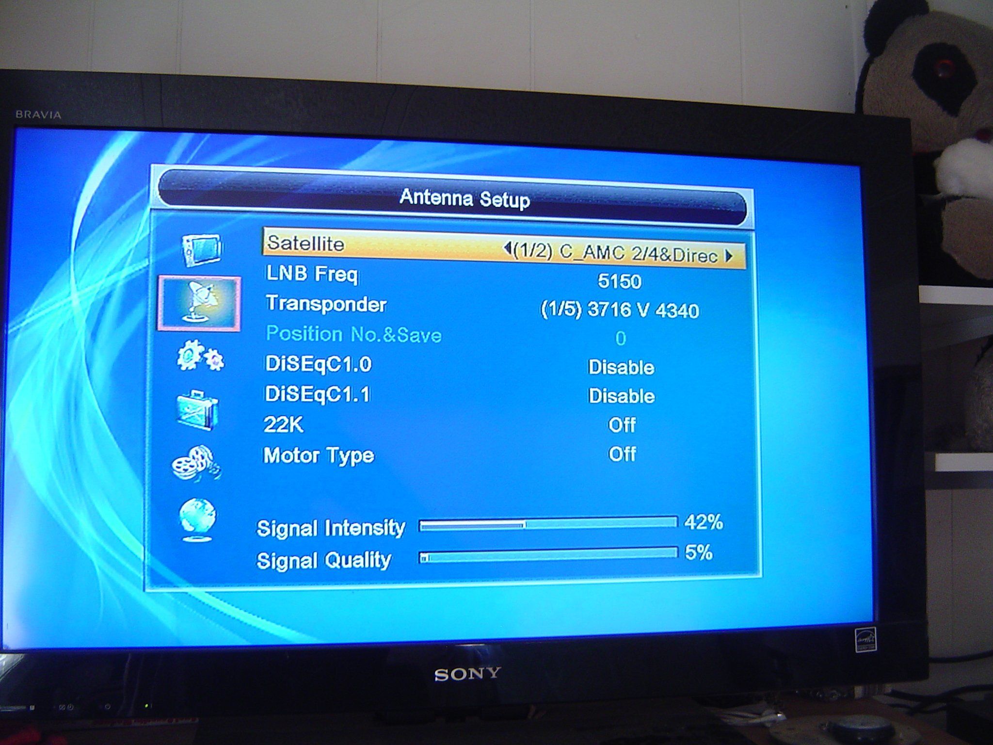

I tried to move the movable dish to scan another satellite, but kept getting the error “Out of Range.” I struggled with this little tidbit for several hours, thinking that I must have done something wrong to my motor. I even found the original book on the DG-280 motor, and read through that to see if there was a reset switch. Once I determined that the motor was moving by pushing the East and West buttons, I read the part on resetting the motor to original function, went inside and disconnected the cable, and went out to the motor and did the reset. Turned everything back on and still had the same problem.
THAT was when I went back into the menu and discovered that although I had set the numbers correctly for my location, I was in 114.41E rather than 114.41W. DUH. Only the first of many mistakes I made, and now look back on with mirth.
I have four dishes connected through my switch, one each movable Ku and C Band, and one each stationary Ku and C Band. When I went to scan in the stationary C Band dish, that was when I discovered the Ku Band dish moving. HUH?
Go back to the settings and go through all the C Band dish setups in the menu and mark each as “No Motor” and set to the 1st position on the switch. Now I’m getting there. I also went to the setup for the non-movable Ku and set THAT as position 4 on my switch, also no motor. It’s easier to set this way for me since this is only one of two setups I have at home, the other being in the living room and I wanted each to be as close together as possible in their settings.

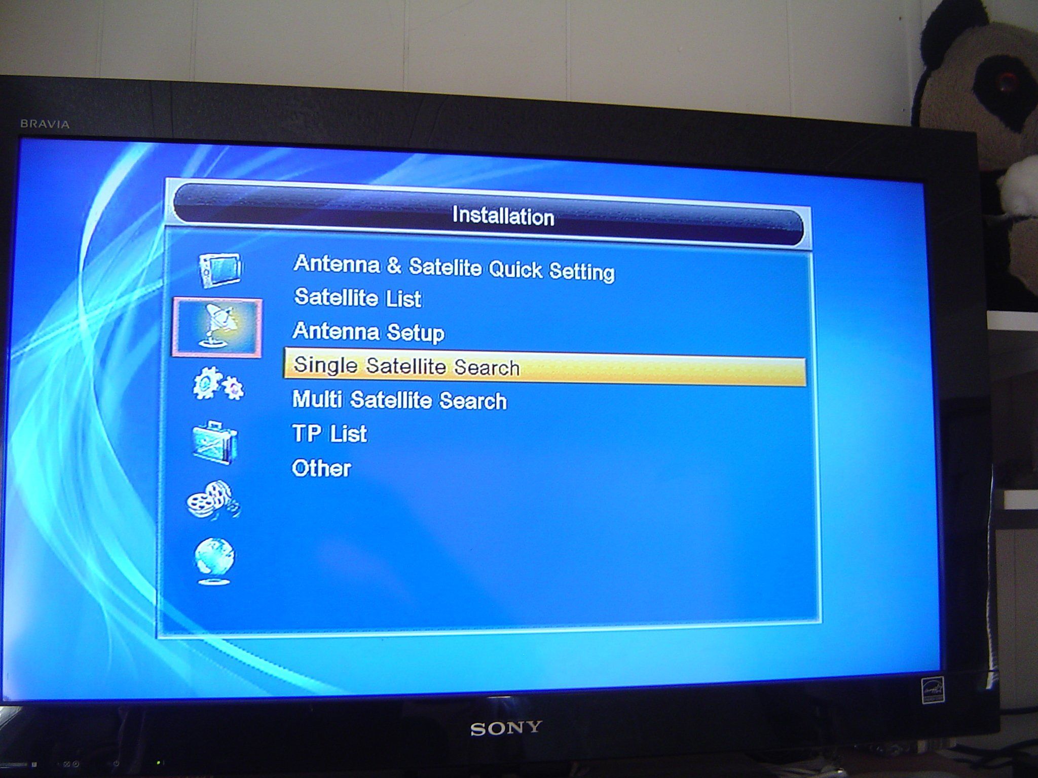

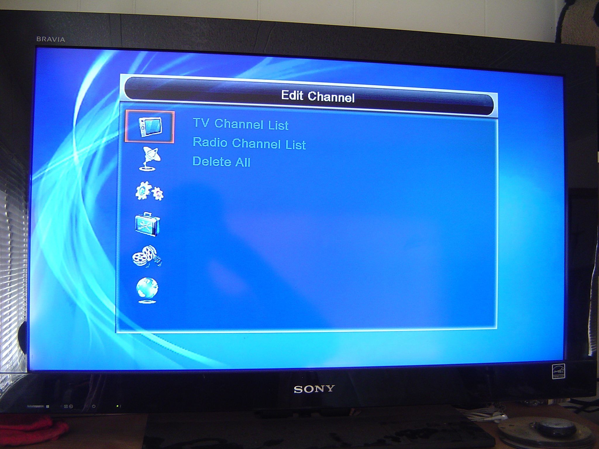

When you first turn on the receiver, the screen pictured in frame 1 of the enclosed pictures will greet you.

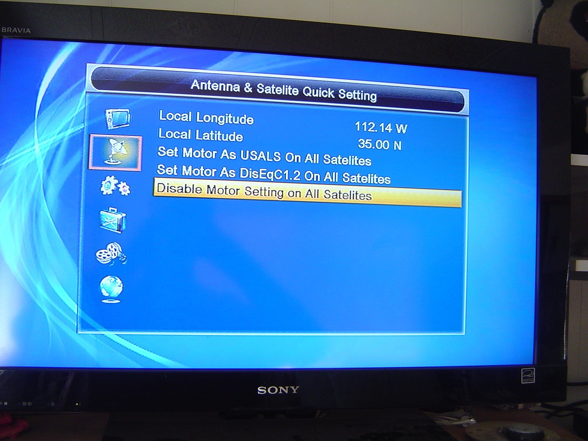

Using the remote control, with the center buttons, go down one item from the TV to the Satellite dish. (picture 2)
Right click to the next screen (picture # 3)

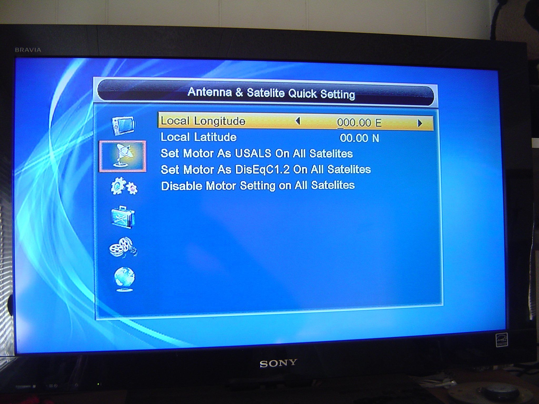

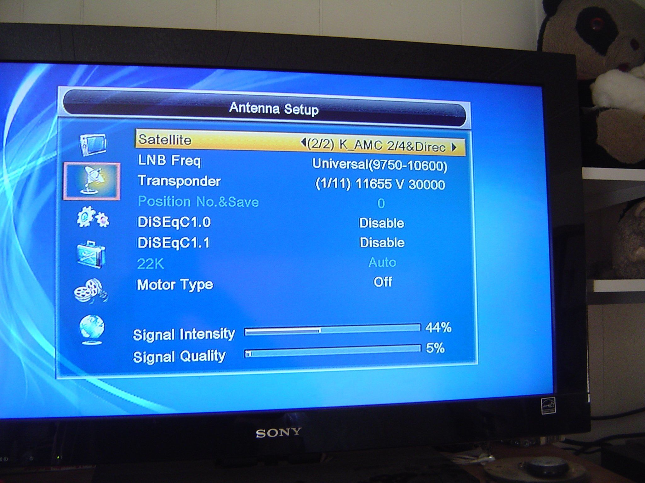

“Antennae and Satellite Quick Setting.” Here you will enter your global position. I used the city where I live. You can get this information in a lot of places on the Internet.
You will not be able to exit this screen until you pick one of the next three choices, either set up using USALS, DisEqC1, or Disable Motor Settings on ALL Satellites (Picture 4).
I chose USALS the first time around, but found it easier in the long run to disable motor settings and set them individually. It’s all up to you which way you go, but I recommend disabling all for now.
The reason for my choice was that when I wanted to change to a C Band Satellite, I found the motor on the Ku Band dish was moving. For me it just turned out easier to disable all, rather than allowing one control to operate everything. It is just as easy to go back and correct what you want later.

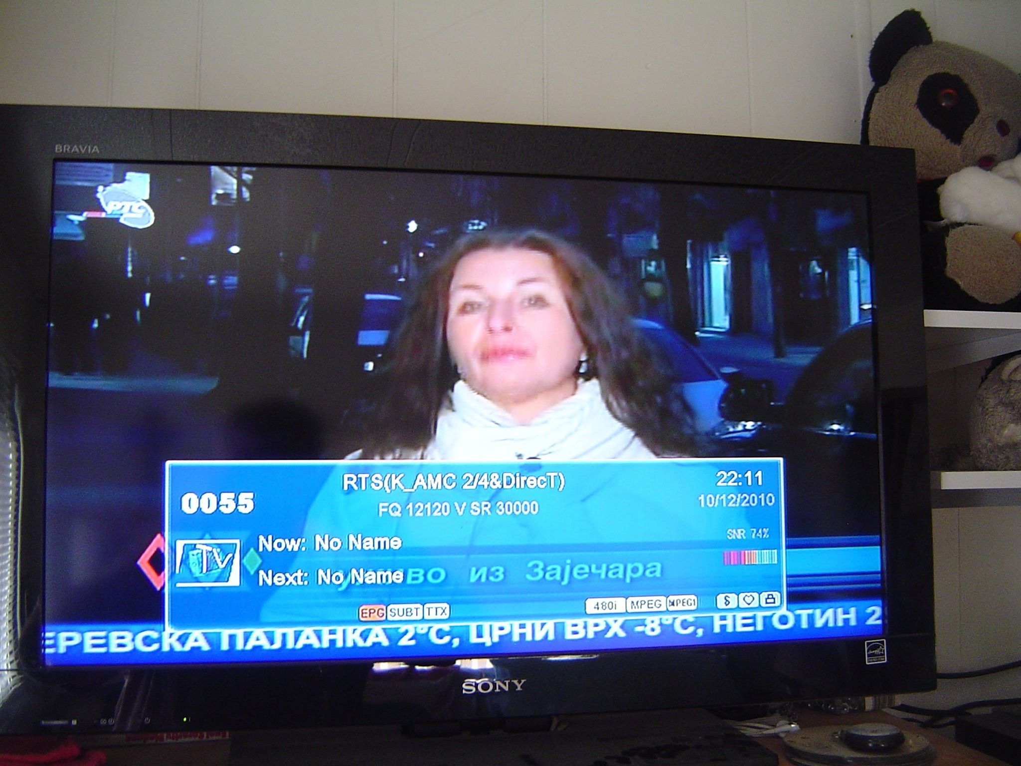

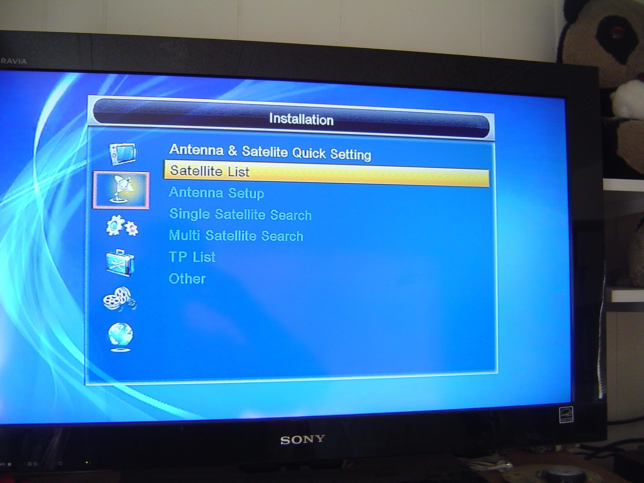

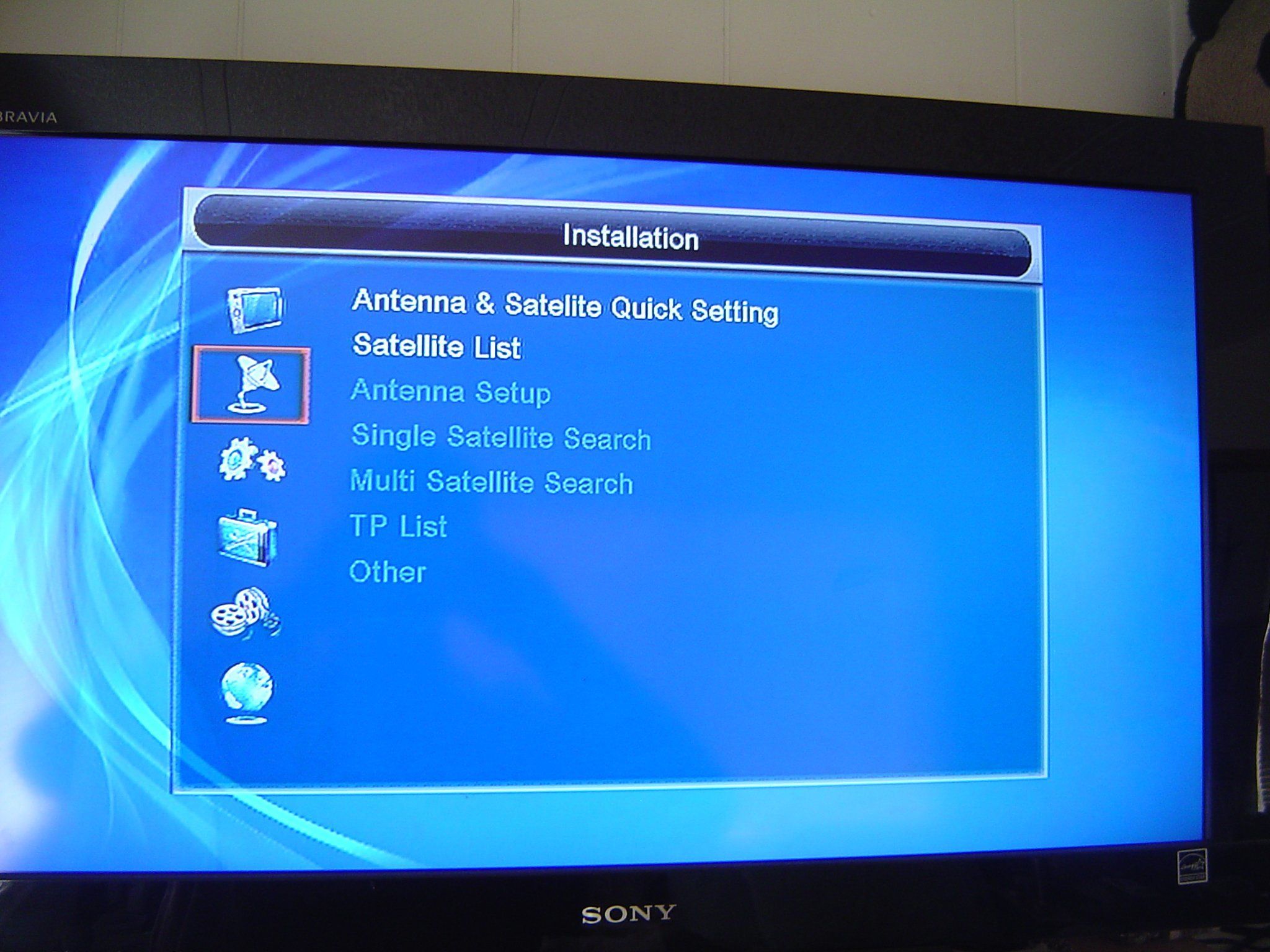

Exit out of this screen and you will be back to the TV again (picture 5) and this time you want to drop down one menu item, Satellite list.

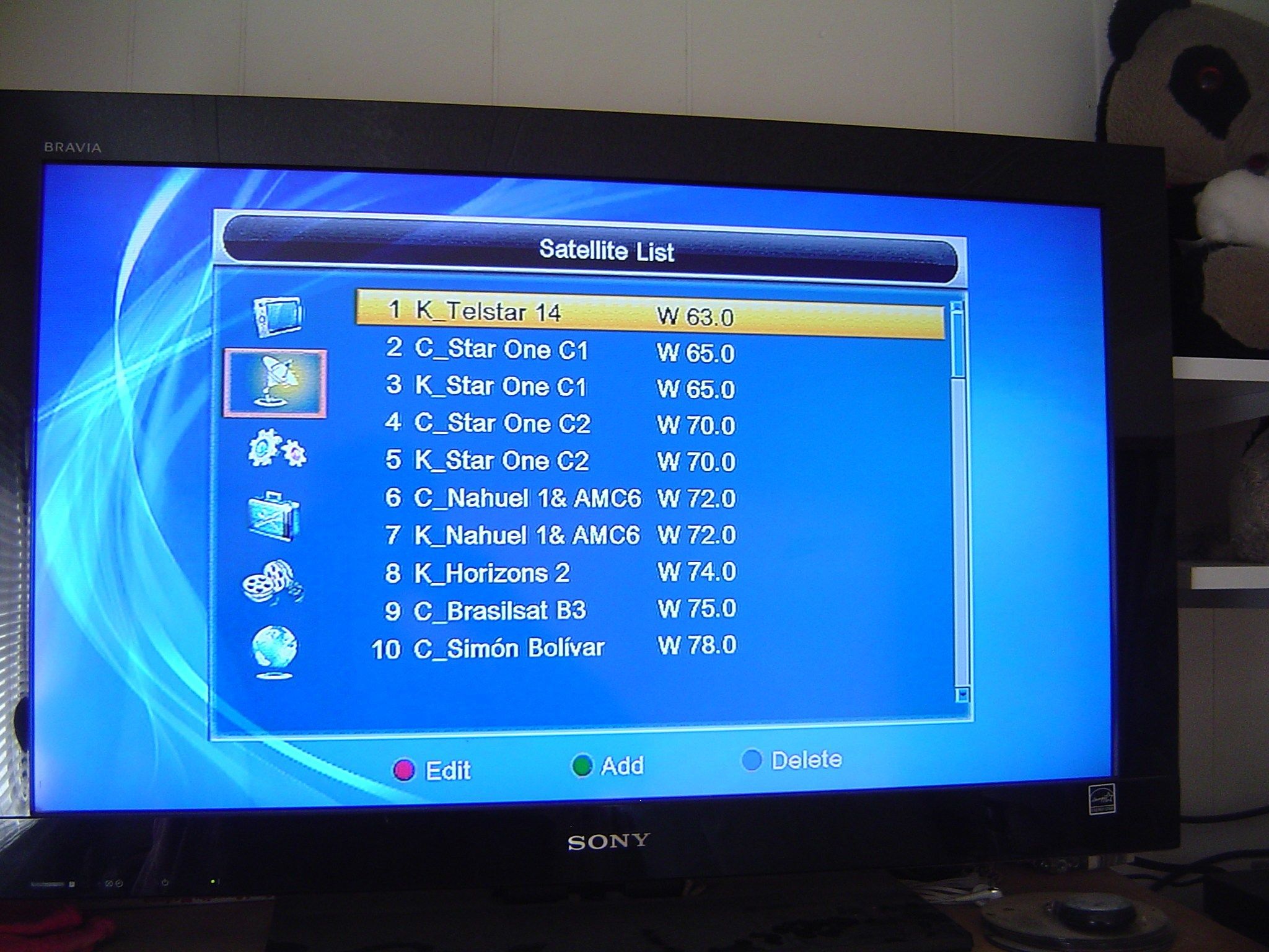

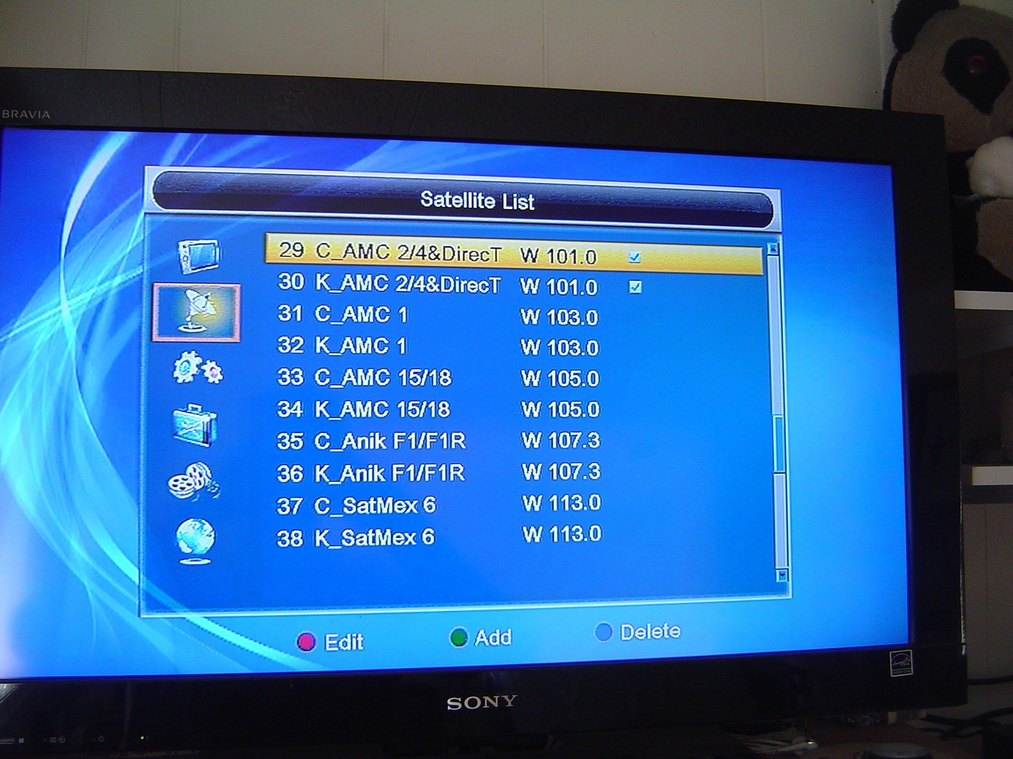

Here is where the fun starts. I’ll guide you through two satellites, one Ku Band and one C Band. After that you are on your own, but you may ask questions after the lecture.
Pictures 6
and 7
show us some of the satellites in the American edition of the newest updates. This version is available in many places on the internet, I got mine from HyperMegaSat.com.
As you scroll through the list, click on the satellites you want to scan, a check mark will appear next to each satellite you note, do this with the “OK” button on your remote. Once done, exit out of this screen to picture 8.

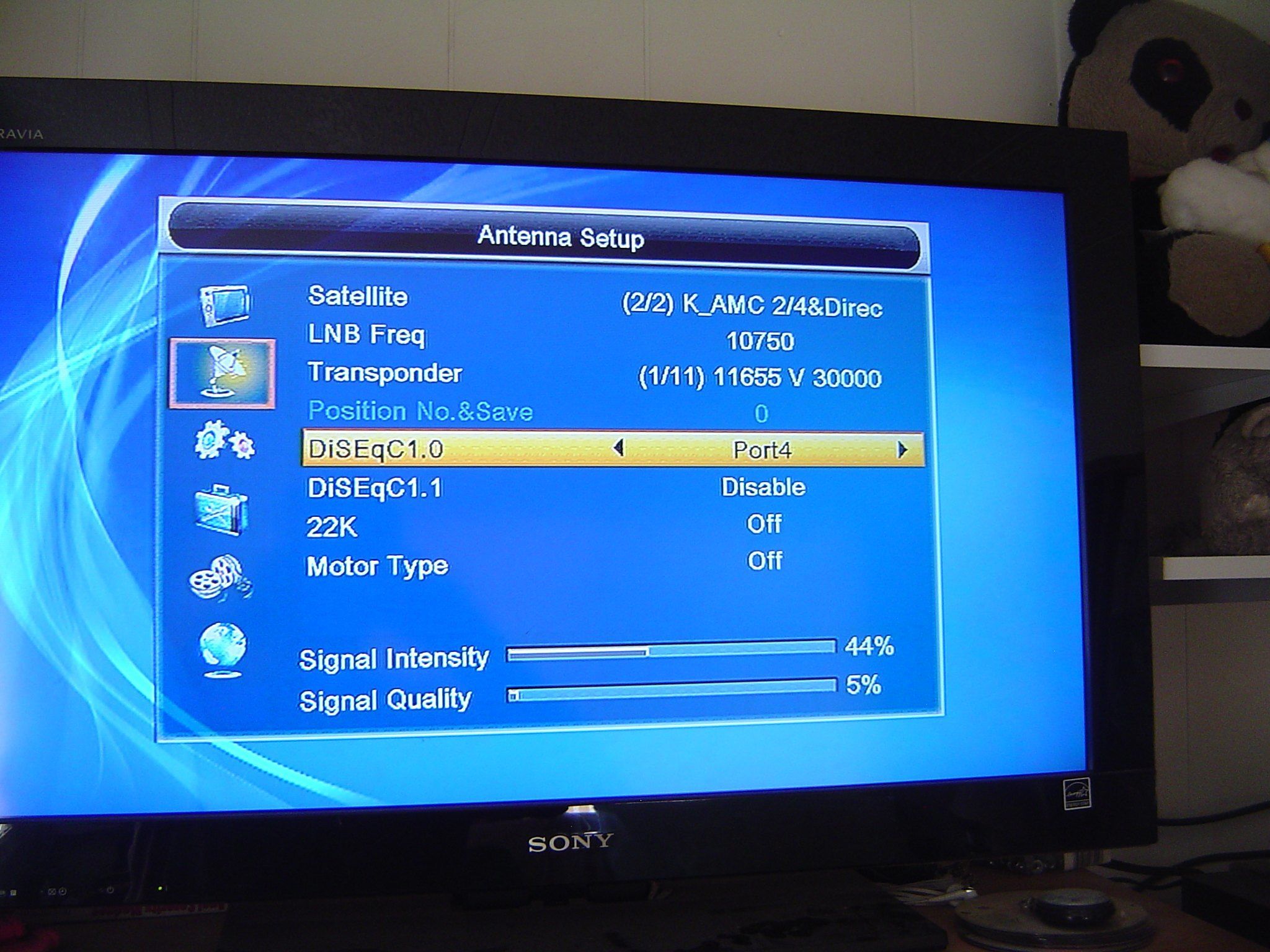

Use the “Left” and/or “Right” button on the remote to get to the satellite(s) you have marked from the previous screen. (Pictures 9 and 10)
Mark the switch setting(s) you want to use for the satellite you want, and then exit this screen.

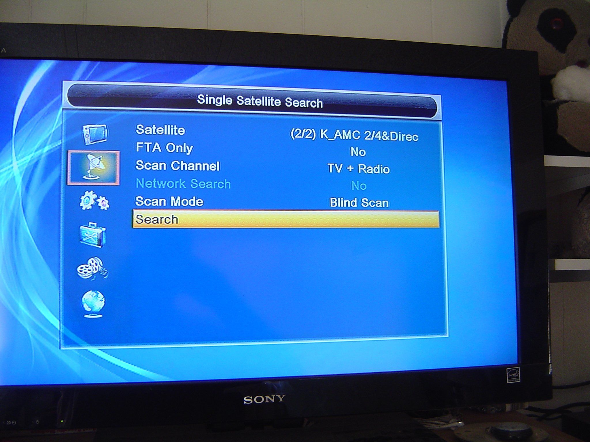

Picture 11, drop one place from the last screen you exited and go to Single Satellite Search.
Picture 12,
choose any satellite on your list, here I am using AMC 2/4, look inside each highlighted area as you go down the list of options, you can pick FTA or ALL, TV Radio or TV only, Blind Scan or Network Scan. Then go to Search and press “Enter.” In about two minutes I had scanned the entire satellite, and as you can see, I got 55 TV channels and 11 Radio channels. (Picture 13)

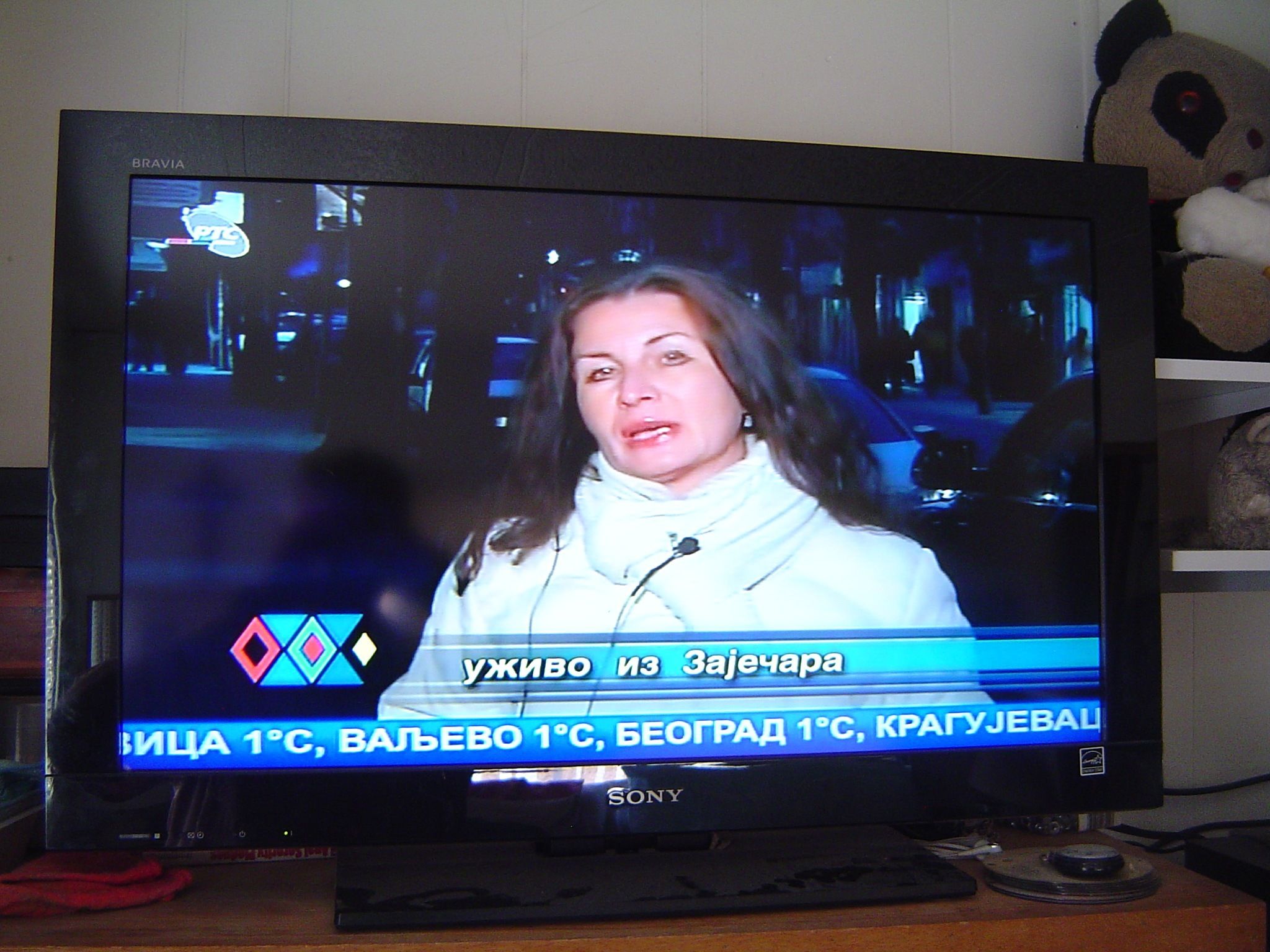

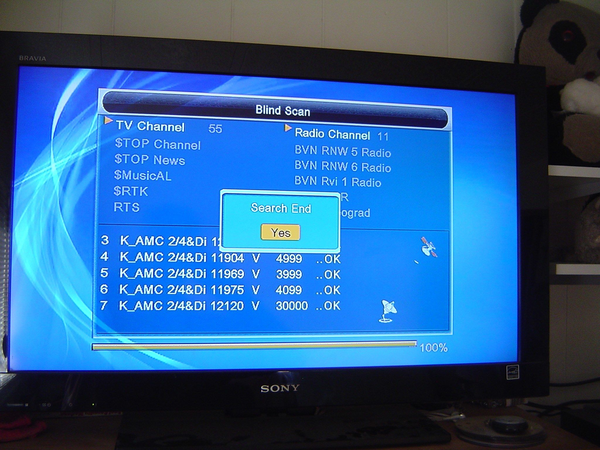

Exit out of the entire Setup Area when you finish scanning all your satellites, I exited after just one scan so I could show what I got with that first scan. (picture 14).

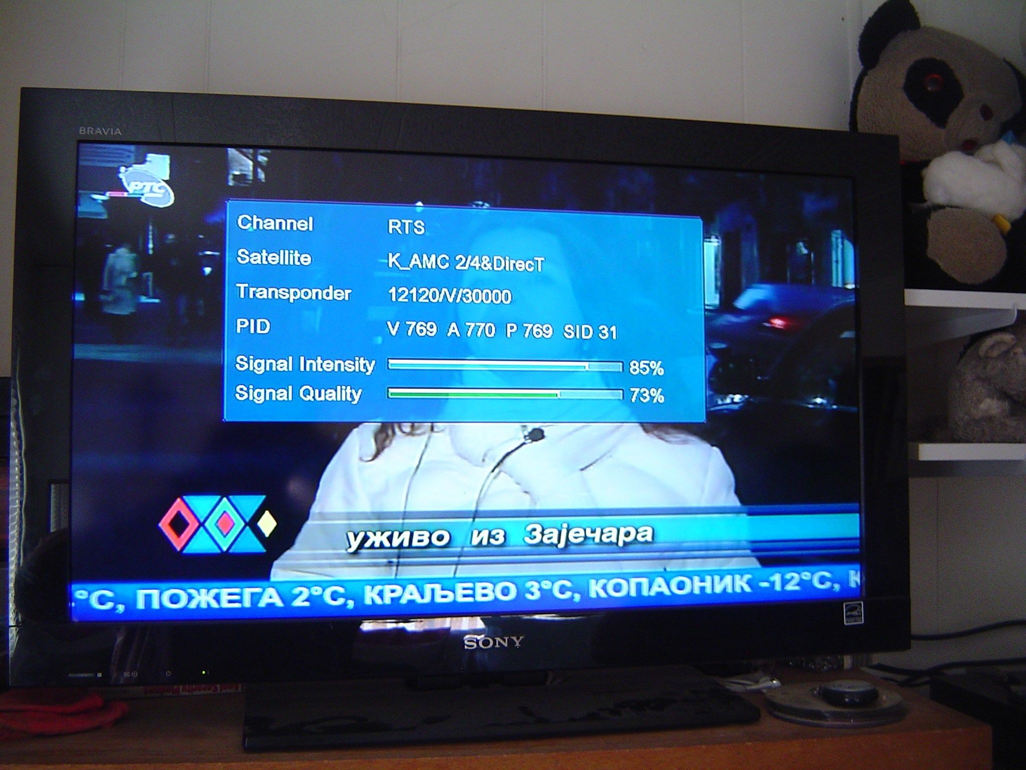

Picture 15 is after pressing the “Info” button on the remote, and picture 16 is two presses of the info button.
Pictures 6
and 7
Picture 12,
