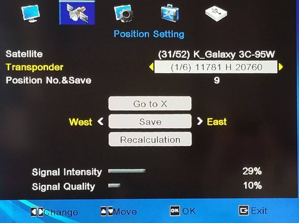

How do you do a Goto-Reference or Goto-zero command on a Openbox S9 ? I looked at the manual this AM and nothing is mentioned on how to do that. Even on the dish control screen menu set up is nothing mentioned about driving the dish by any means other that USALS or Digi....
Reading through this old posting. The answer to this question for S9 ops who don't know is set Motor Type to Diseqc1.2. Then cursor over Motor Setting (letters change to yellow colour) and press Enter on remote control. This opens a new screen. Select Position Setting. A new screen opens where you can drive the motor to Go to X and other functions. This secret screen is not easy to find unless you stumble on it.
