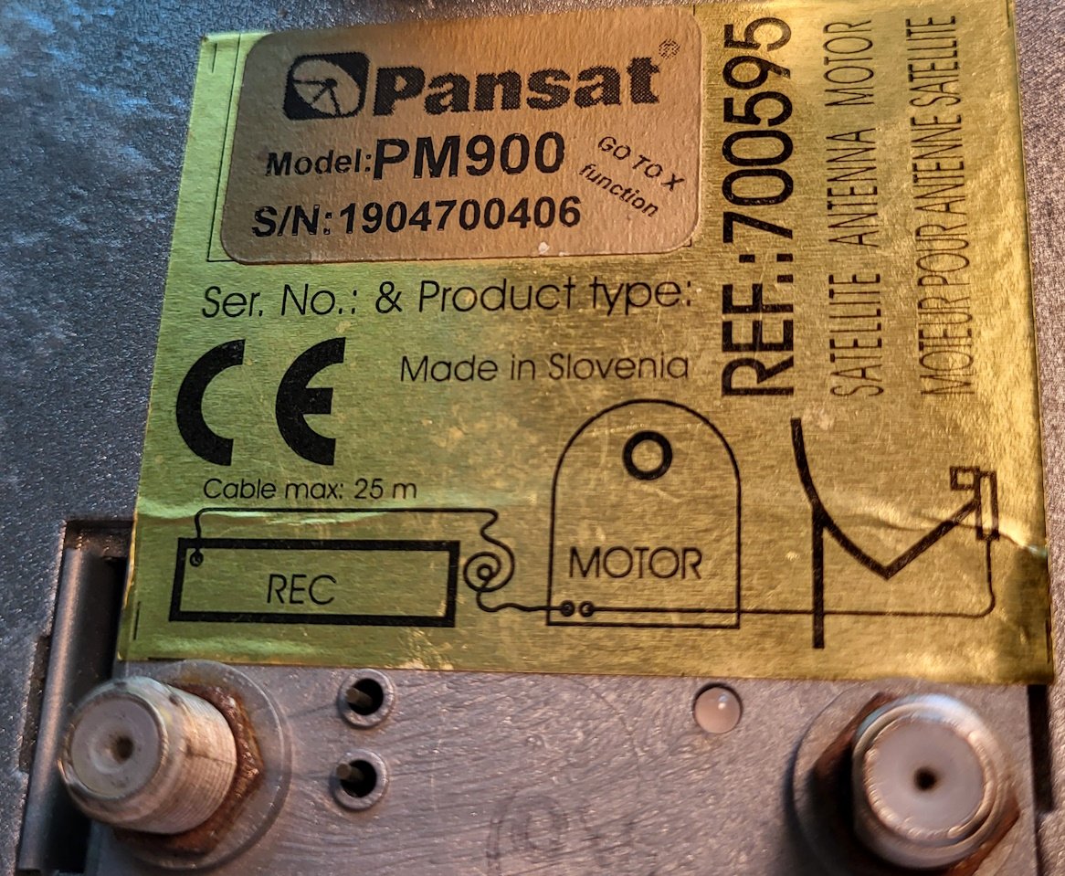

There is a note on a label on the motor that says you should use a cable no longer than 25 metres. My cable to the dish consists of two old joined RG6 and total length is a lot longer than 25m. The label also says it was Made in Slovenia.

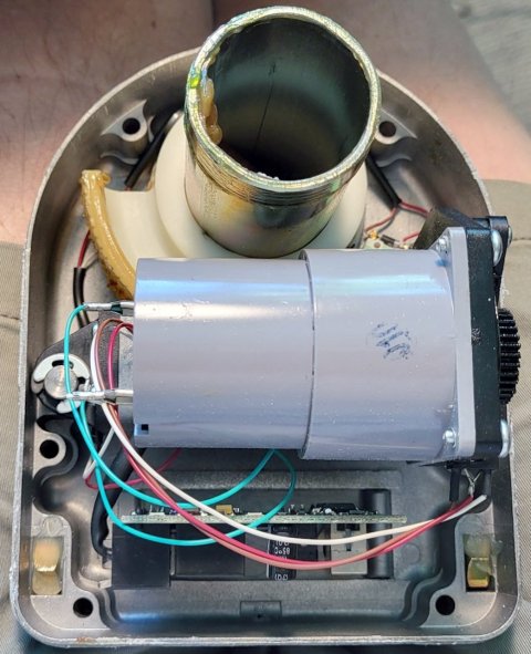

Wth am i looking at guys?
I just fried my meter, didn't I? Time for a new one?
