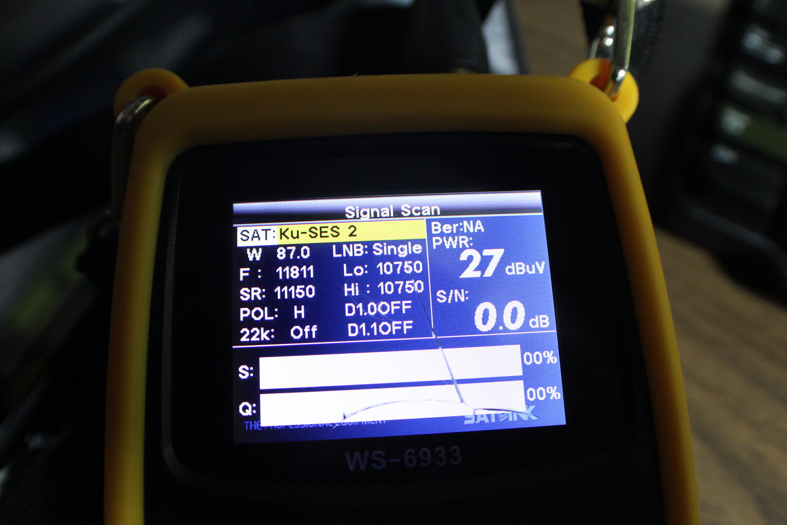

I was just on the roof trying to tune with my Satlink WS-6933, and the piece of coax I was using fell off the LNB. I turned off the meter, reattached, and the Signal strength was at zero. I attached to five other known good LNBs, and got the same results.
Is it toast? And if it is, what's a comparable meter in the under $100 range?

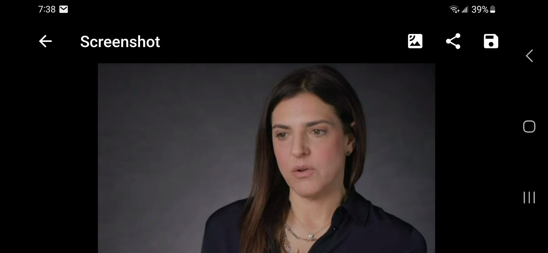

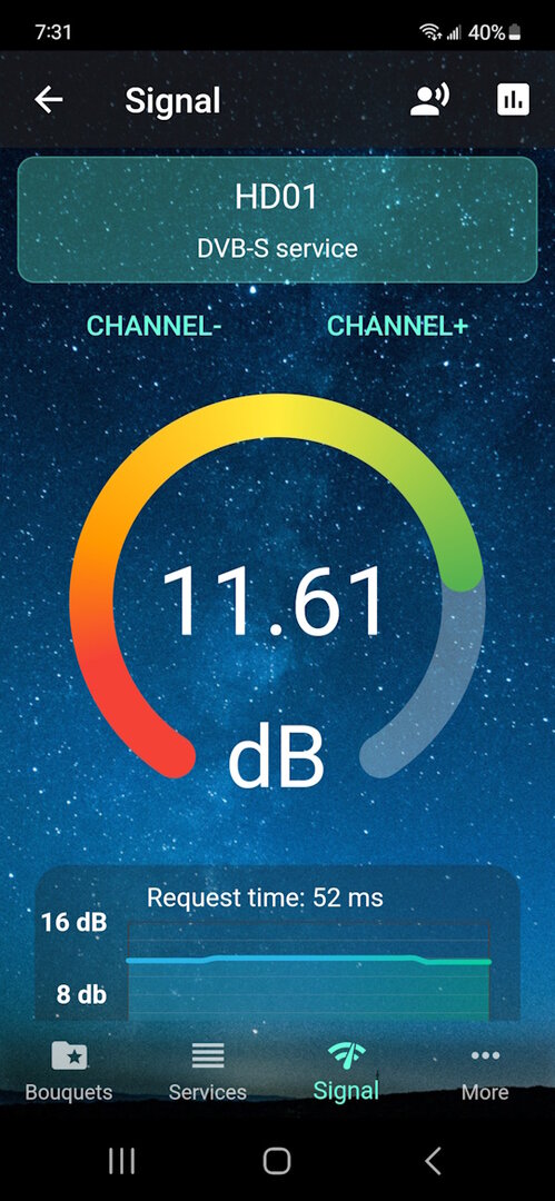

Before you buy a new sat meter, you should know that an Edision Mio+ sat receiver for about 2x the cost of that sat meter makes having a sat meter for a hobbyist obsolete. I use my smartphone at the dish with a free app running to remotely view the Edision receiver over my network wifi. It's better than a sat meter. I can even stream to the dish location to see the quality of signal being received.

The app I use called SignalMeter says it supports Android and iOS (Apple) devices. As long as your iPad can operate over wifi, I would think it would work.

Did you use the cable that fell off? Perhaps there is a short in the coax. Try a new coax and connectors if you haven't done so.
Excellent suggestion. I just tried another piece of known good cable and there's no change. Meter is toast, I guess. New one will be coming soon enough, and I must remember to use connectors with it that screw together instead of the quick-connect sleeve style.
In terms of problems, this really wasn't a major one. My screen was cracked and the battery life was not great, so although I wish I didn't have to spend the money, it's not a major issue.

The specs show LNB short protection. I'm not sure how that works, but did you trying going to the lnb power setting page and try turning the power off and back on for the lnb?

I don't have a Apple phone but Signal Meter is still on the Google Play store(Android). I just pulled 2 of my old android phones out of a drawer and checked to make sure the app was still working. Yup.
I've a android tablet. I might see if I can load it on there also. Bet someone has a old android phone they will give you. All you need is WiFi for it to work.

This won't help with an IPhone but I just fired up a ancient Google Nexus tablet and installed Signal Meter(by krkadoni) on it. I input my Mio's address in it and it works!
