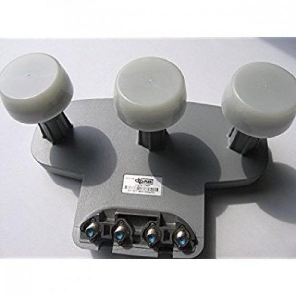

I have an oval dishnetwork dish HD with a 1000.2 DISH PRO PLUS INTEGRATED LNBF (see attached file)
which I know it can get three sats at the same time.
I don't care about getting the 110, 119 and 129 birds. I just need the 118. Is that lnbf capable of doing so? If not can someone suggest the right lnbf for that dish?
No. You need a 1000+ dish with a DPP500+/DP Dual lnbf which will get you all four satellites. The DP dual is for the 129. If you only want
The 118, you can use a DP 500+ with a single problem connecting to the F1 port on the LNBF, which you can't connect to the input on the LNBF that you have now, and when you run a check switch on the receiver it will see you all four satellites
