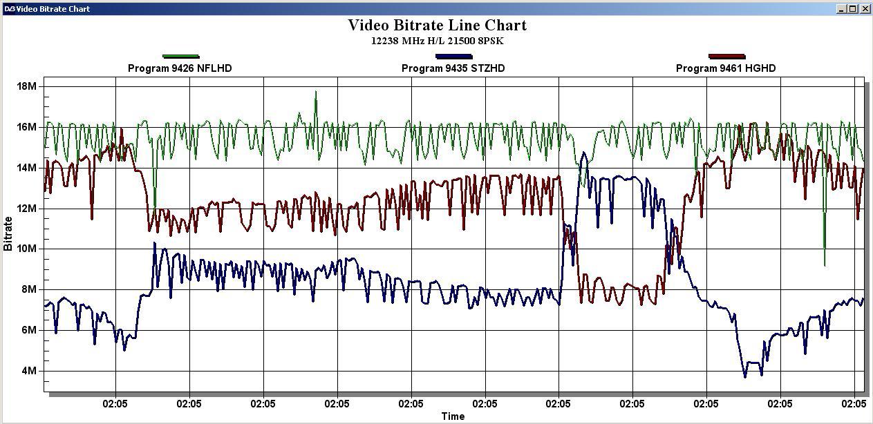

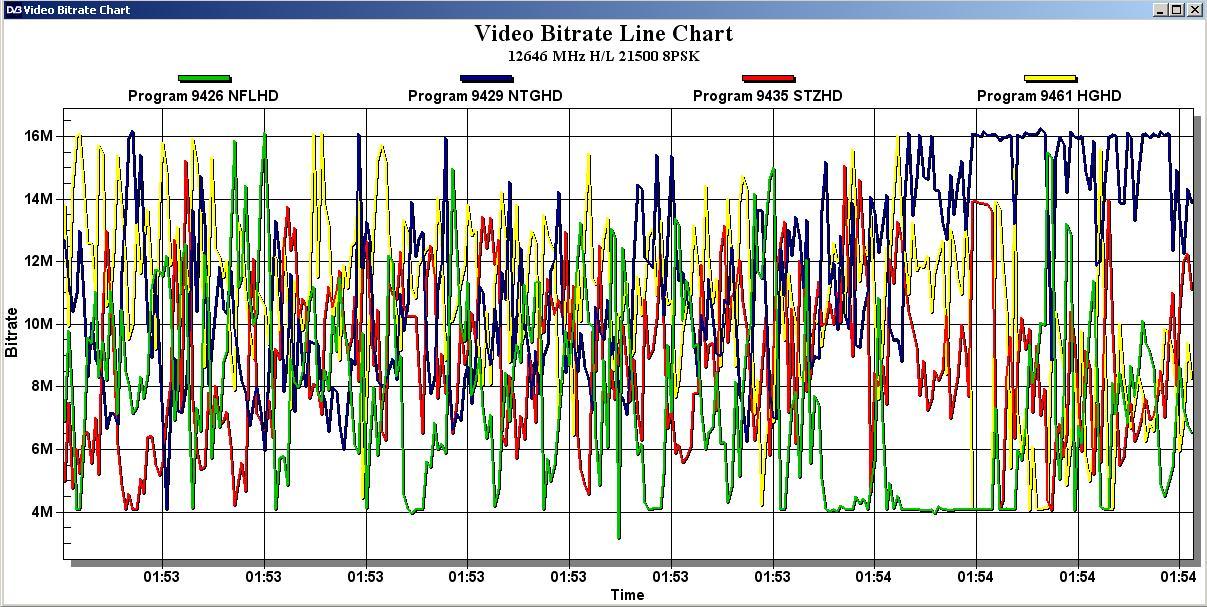

Attached is a screen shot of the instantanous bitrate of each video stream. You can tell there is a hard cap of 16Mbit in their statmux, no single stream ever goes above 16Mbit. That sucker is working overtime trying to cram those 4 channels into little over 40Mbit total transponder bandwidth.
The second attachment shows NFL, STZ, and HGHD (mpeg4, 1440x1080i) from 61.5. Notice there still appears to be a hard cap of 16Mbit, but there is much less variation since there are 3 streams instead of 4 competing for the same amount of bandwidth. Supposedly the picture should look better at a lower bitrate as well since they are using h.264 instead of mpeg2.
As you can see, there could be quite a difference in your picture quality depending if you are pointed at 129 or 61.5...
