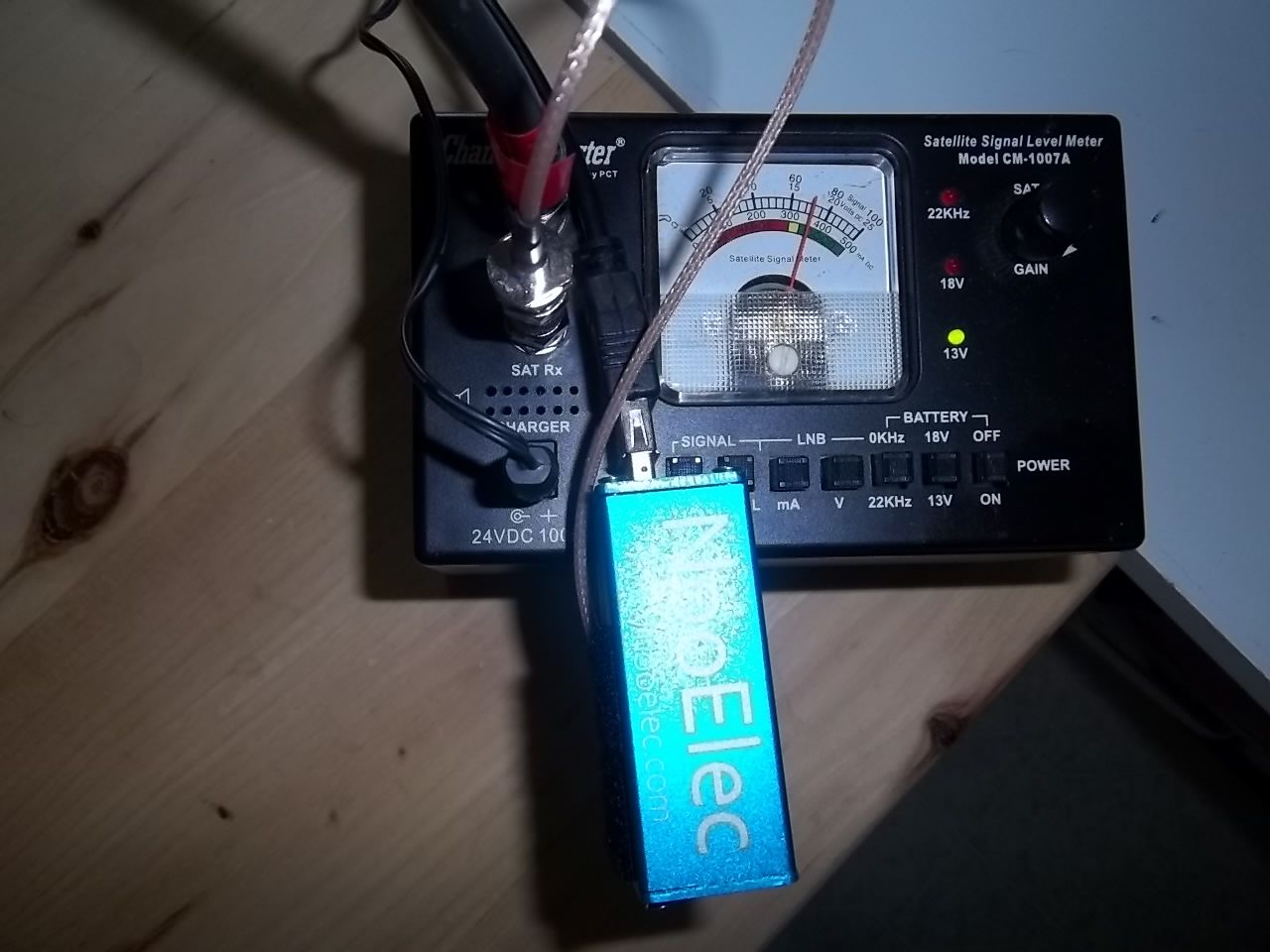

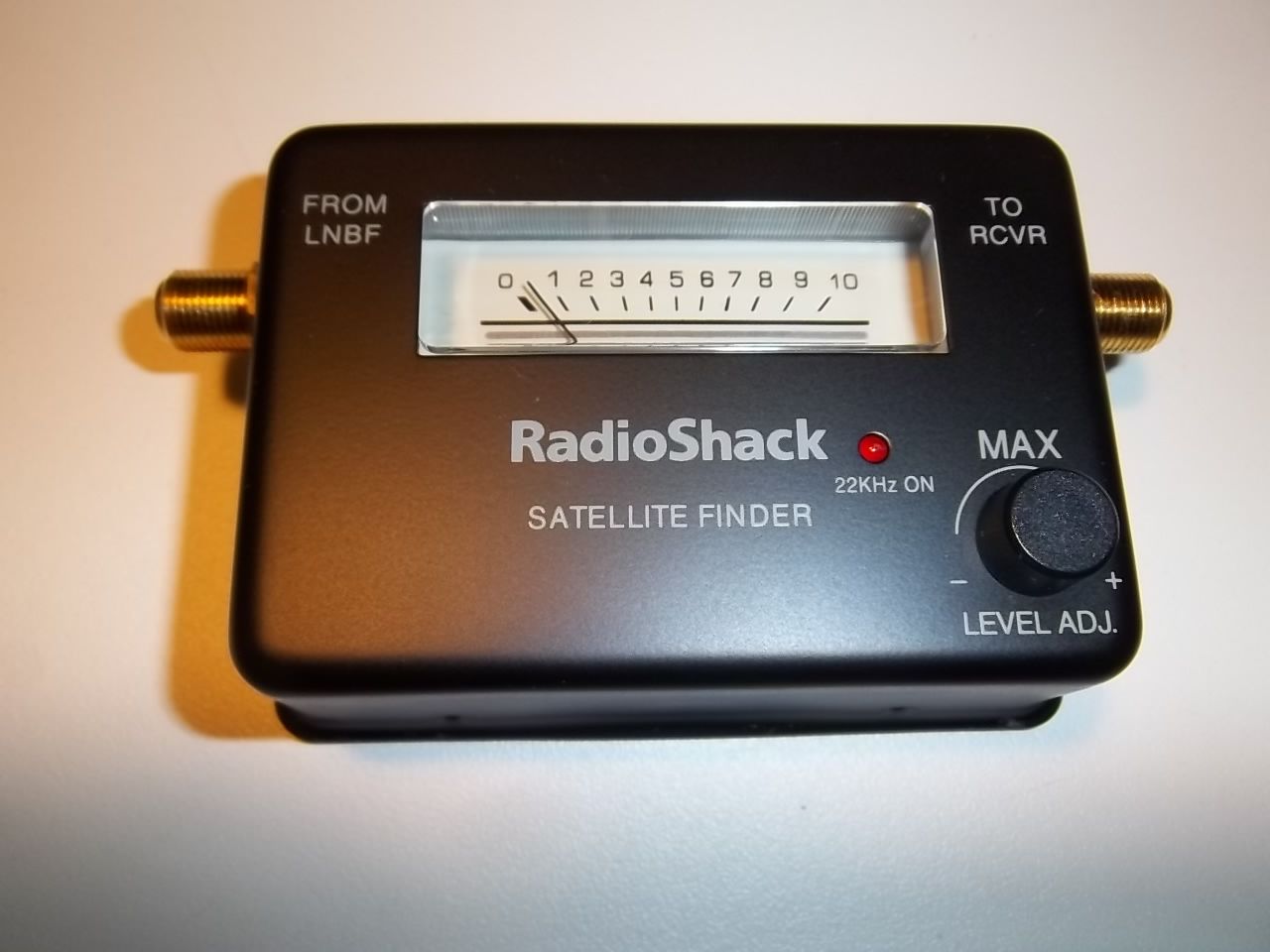

I use a Radio Shack satellite finder first, to get a meter swing, it's very helpful. The RS meters were made of metal and are sturdy. Then I use a handheld satellite receiver to optimize and see the actual FTA broadcast. The other inexpensive satellite meter is my Channel Master that I use for satellite finding, it has a built-in power supply and more options. (Disregard the Nooelec gadget attached).
And yes, the Eastern sky east of 65W Ku, at least here, does not have many FTA sats of interest other than 34, 30, and 15W Ku. For a while 45W had two FTA channels but those left the air. I still like to fish around for signals though.

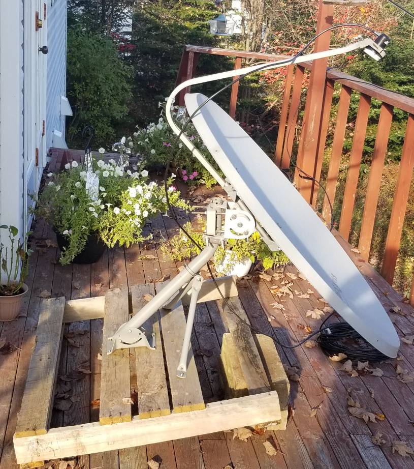

One additional note..tipping an offset dish upside down does give you a much more manageable elevation angle compared to normal position when tuning in low elevations, but it does have one disadvantage. Higher pitch in elevation upwards tends to catch more rain, which stays on the dish for a few seconds during a downpour and can knock out the signal. It also has the bad result of clinging snow when you have an accumulation. A "normal" offset mount in its conventional system will point into the ground, causing an increase in noise picked up by the dish at low satellite elevation angles, but with the sometimes benefit of either shading the reflector from any snow staying on the surface, or catching any rain at all. Your mileage will vary.

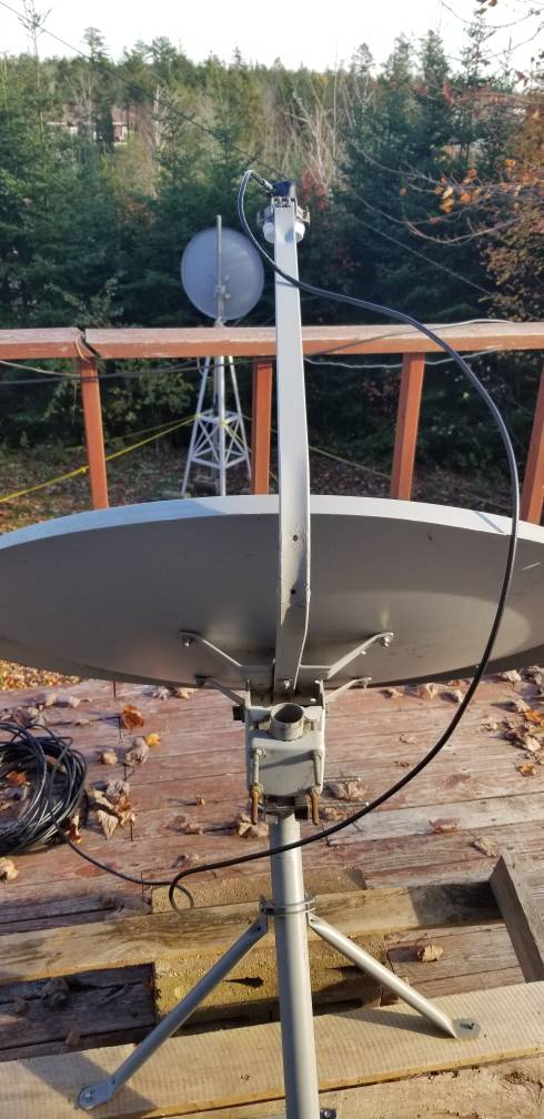

In my case, I must use inverted so the dish bottom doesn't hit the balcony boards. I even put a cinder block under the front of the pallet for a little extra height.
Dish is pointing at 22W. View of the direction from behind dish to 22W.
