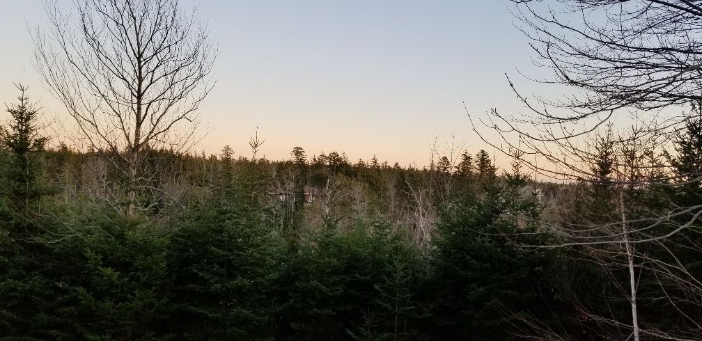

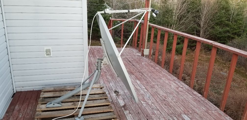

"Laboratory" was set up today with an inverted 1.2-metre dish on a second-storey balcony about 12 feet above ground with a universal PLL LNB. Now I am ready to hunt tomorrow in the daylight. I can see down to the eastern horizon (about 3 degrees elevation @ 63 degrees W longitude) so any eastern satellites with a footprint here should be detectable. Tonight I will enter transponders into my receiver in preparation for tomorrow.
View attachment 141903 View attachment 141904
Good luck happy hunting, I also like messing with fringe reception ive built a fold down wind up tower the wind up part to try and get me more arc.
Interesting. You're in the UK. How far west can you receive anything? I don't have much confidence I will see anything tomorrow. Using manual method without USALS it is very difficult to find signals when there is no reference signal in the region of the sky you are searching.
