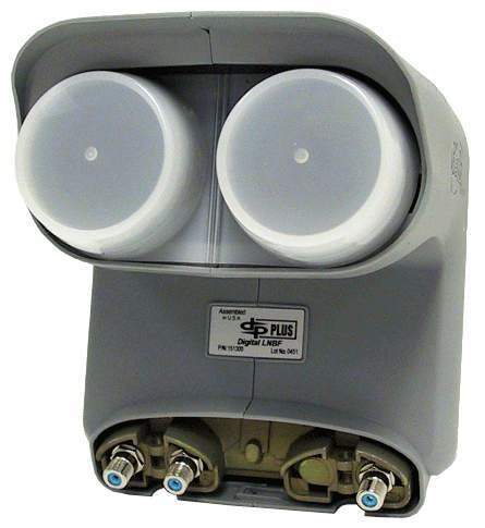

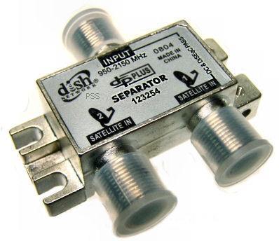

If you can oly use one cable you can get a Dish Pro Plus Twin LNB. All you need is one cable fed from the LNB, and at the receiver end you use a DPP Seperator. Read the attached file for more info.

Hmmm, any ideas where I can find the Dish Pro Plus Twin LNB in Vancouver Island BC? Thanks,

The problem is he only has one line going into the RV. He also wants 82W & 91W. No power inserter is required for a Dish Pro Twin LNB ,the receiver will power it no problem & it has it's own internal switch for 82W & 91W. Really the Twin & the seperator is the perfect solution to his situation.
Thanks for the help "someone" is pretty wise :) I was wondering about the LNBS, they have only one port on each while the one in your image has 3 in total...tow on one, and 1 on the other. Not anything to worry about in my application?

Check out the pdf I posted and you will see that the DPP Twin LNB has on the left side Port1 & Port2, and on the right side it has LNB IN. You can use either Port1 or Port2 to send to your receiver. Inside the DPP Twin LNB an internal switch exists that the receiver will recognize and allows you watch both 82W & 91W from the same coax cable. If you have another receiver you could use the other free port on the left for it. The LNB IN on the right side of the DPP Twin LNB will let you add a third LNB for incase Bell ever adds a third satellite postion.
On the receiver side you need to connect the cable that came from either Port1 or Port2 of the DPP Twin LNB to the INPUT port of the DPP seperator. The two SATELLITE IN ports of the seperator feed the two tuners on your 9242.
In the pdf look on page 3, table 2. The 2nd row is your situation; a dual tuner receiver, with a dpp seperator, 1 cable from the twin lnb, supporting 82W & 91W (in your case) & will allow an additional LNBF.
One thing to note is that Bell TV as a company does not officialy recognize Dish Pro Plus equipment, but it works just fine on Bell receivers the same way is does on Dish receivers. I have used Dish Pro & Dish Pro Plus equipment for many years without any issues with Bell TV's 5900, 6141 & 9242 receivers.
I would highly recommend going the Dish Pro route with the DPP Lnb and separator as I have done so myself on the 9242 and 6142 and works great. It's so nice to be able to use one run of RG6 and not have to mess around with legacy equipment. I don't know why Bell doesn't come up to speed and officially sanction Dish Pro equipment as it's so far superior IMO.
