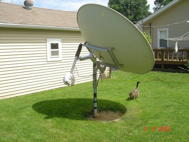

When I first got ole BUD I could not get the satellite that was on the far east, Satcom 4. I called the installer and I watched what he did. He loosened the u bolts that hold the 24" arm in place and slid the arm down about a half an inch. That did it, it moved the arc a hair to the east giving the arm more room to go that way. You can have the longest arm made, but if it is not secured at the proper place it will shorten the arc. Look at my photo and you can get an idea of what I am talking about. You can see the u bolts about half way up the arm just below the rubber protecter on that flat peice of iron. Loosen them and move the arm, thighten it, go in and check it. Repeat it until you get the satellite you want. I get everything from AMC 7 @ 137 to AMC 6 @72.
Thanks for the info, Jim.
First, as for the u-bolts, I randomly selected a spot near the rubber boot and tighented it. Didn't know there was any science to it.
But now you've really got me thinking. Your actuator appears to be on the EAST (left) side of the mount...and actually contracts to "pull" the dish east?
My actuator is on the right (west) hand side and extends as the dish goes east. Is that my problem?
On the east coast it should be on the right, and set for linear west on the 4dtv, if on the west coast it should be on the left and set for linear east.
Jerry,
Believe me, there is no science to it. It's just eyeballs to the sky. If your arm is on the right side and pushes to the east, just loosen it and push it up a little bit. Just the opposite of what I had to do. If I was a gamblin' man I would bet my first born that if you do this you will get SBS 6. The only active TP on SBS 6 is the Newborn Channel on 101. In the early evening there are a few live feeds, so you shouldn't have any problem locking on.
