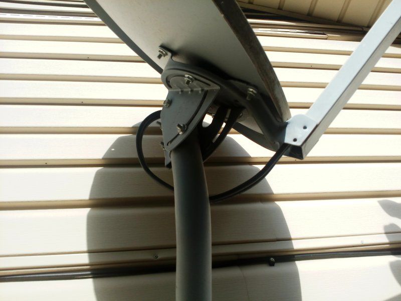

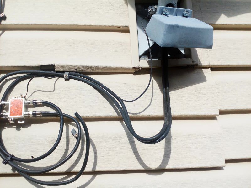

The image is the cable I pretty sure having problem with. Instead of just cutting the one cable not being used and leaving it hanging there it should of been replace years ago when it went to one cable. With all the signal problems I have had can't believe it was never replaced.

It has not been used for several years since going to one reciever. The tech just cut it off and left it. It is part of the cable I am having trouble with and going to replace it this weekend. At least now I know how to get my signal back until then.
The first picture reminds me of what I found out when I was messing with my Dish 1000.4 last weekend. Since the dish was installed six years ago, I only had two cables running into the house. On Sunday, when I ran a cable to connect to the third output on the LNB, I was surprised to find that there was already a cable connected to it. I am assuming that it was the cable that was connected to the signal meter when the technician was aiming the dish, and then when he was done, he just shoved the other end of the cable into the arm of the dish so it wouldn't show. The two cables that were actually in use were connected to port 1 and port 3 on the LNB, and the short extra cable was connected to port 2. Since I had plenty of length on the cable that I had just run to reach all the way to the LNB, I unhooked the extra cable and tossed it aside. I just thought it was funny that I had an extra unused RG-6 cable in my installation this entire time and I never knew it.

In the first picture, you have a cut cable which can cause in-gress as it will act like an antenna. Is that cable needed? If it is, replace it. If not, it should be properly terminated with a terminator.
That cable that is cut will not cause ingress because it is also cut inside the LNB. That is a hybrid solo hub which means it's using a hybrid LNBF which only uses one output port. I would guess at one point there were is a dual cable coming from the dash and whoever installed the hybrid system just use one of the dual cables to go from the new LNBF of to the solo hub.
It's my guess that the problems you are having is due to poor installation by a poor technician who did not sweep the entire system to make sure that all connectors and all cabling is up to spec. I also have to say that beating the LNBF with a broom probably damaged it
That is exactly what that extra cable is for and fortunately on a .2 LNBF, Those ports are self terminated when not in use
This was on a .4 LNBF. Is it done the same way as a .2?
Yes. The only difference is that most of us use port three for the jumper. I'm not sure why that guy used port 2. Not like it matters because both have internal switches that work like the outputs on a 44 switch

Yes, that is what I was expecting once I found the loose cable. So, I disconnected the cable from port three and pulled on the other end of the jumper, and it did not budge. Then, I disconnected the cable from port two, and I was able to pull the jumper out of the arm of the dish. Next, I took the cable that had previously been connected to port three, and moved it over to port two. Finally, I connected the new cable that I had ran to port three, like I had intended to do in the first place, and put the LNB back on the dish. I ran a Check Switch on all of my receivers, and everything works. (I realize that the Check Switch probably wasn't necessary, but I do that every time I change any cabling, just to be on the safe side.)
