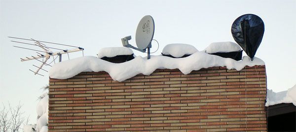

In my area a dish pointing at 110/119 is a catchers mitt for snow. A dish facing to 129 gets nothing. But a 33 Gallon Lawn & Leaf with cinch ties works great on a 500. The vertically oval shape in conjunction with the dark bag is great. It flaps in the wind shaking the snow off and the dark bag absorbs heat from the sun, aiding melting. Up until a couple of months ago I had a 1000.2 the oval is horizontal and thus no peak at the top and the bag would just fill with snow. DO NOT USE PAM or WD-40 or any other kind of spray other than one made for this. It will only gunk up the dish and make it easier of the snow to stick after the spray attracts dirt and bugs. But then there is this from SolidSignal:
Dome Magic Rain-Fade Protecting Spray for Satellite Domes (1830) - King Controls - 1830 - 660045018301. The title it says "dome" and "rain". But in the description is says any DTV or DISH dish for snow too. I haven't tried it yet, because we, in Denver, have yet to have any snow. May have to turn my sprinkling system back on and water if we don't soon. Plus, I'm back with the 500 dishes that I can bag.
Hope this helps.
