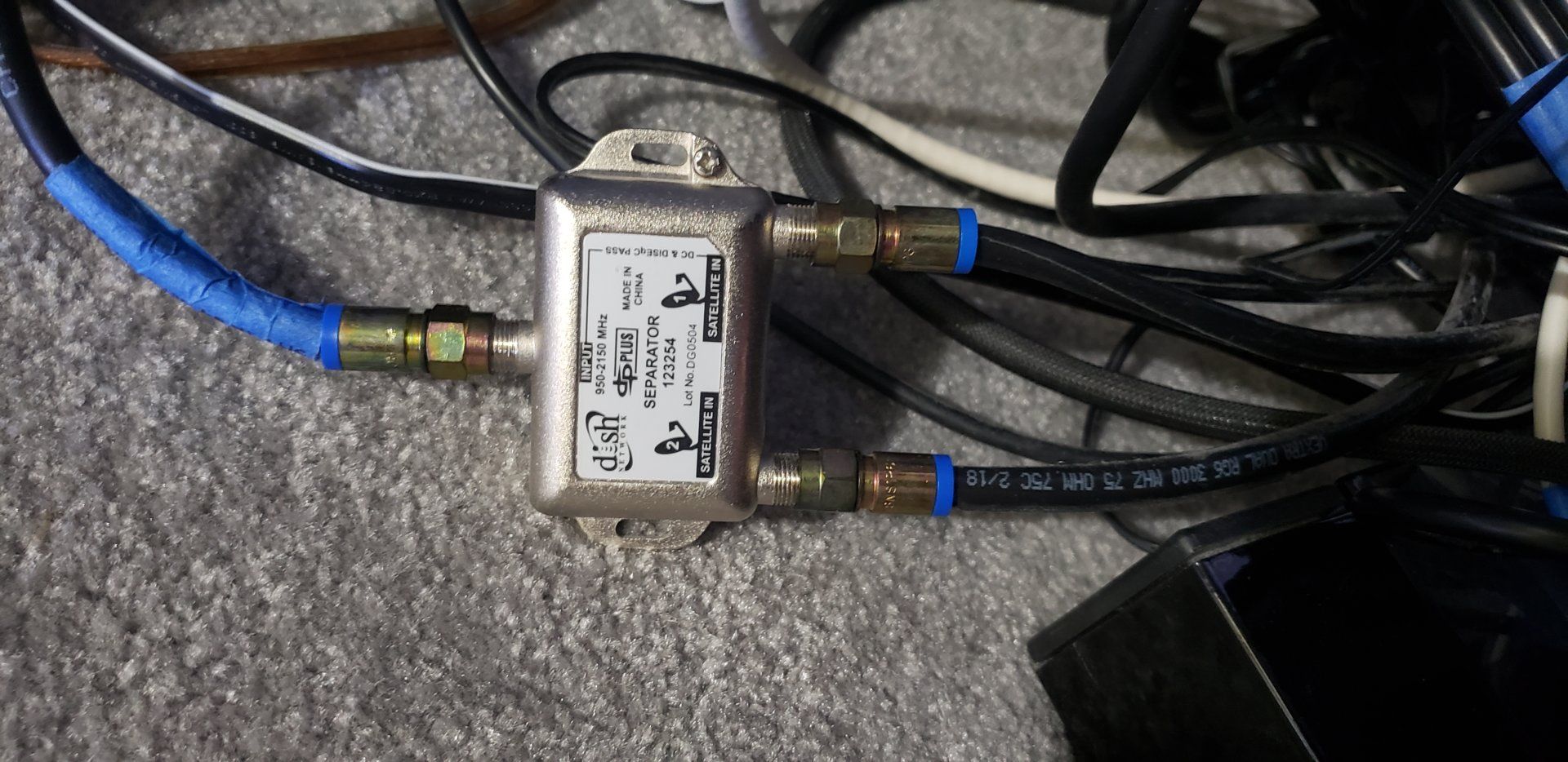

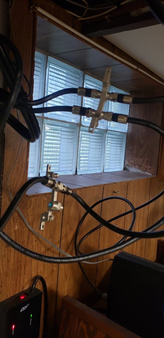

I'll definitely give that a try dare2be. On another note, referring to what HipKat mentioned above....I'll admit I don't know exactly what a "diplexer" is or where it might be found in my system. I have a Dish "separator" behind my receiver, and those connections are obviously dry and they are good and tight. I went up on the roof earlier tonight and I can't actually see where the three coax cables connect to the 3 individual LNBs, as they sort of disappear into the long arm. I did find something in my basement though that looked kind of shabby. I can live without an installer screwing the connecting blocks/couplers to the ceiling joists, but there are NO grounding wires connected to either of them. I plan on getting this all cleaned up and done before the new receiver gets here in a few days. One quick question though...when doing a "check switch" test, where exactly is the "switch" that I'm testing? On my old dish, there was this massive contraption hanging off my roof mount called a DP44 Pro Plus. On the new 1000.2 dish I have, is this something that is now internal in the LNB arm or somewhere else? Just curious. Thanks!

Your check switch on 722k should be DPP 1K.2 w/separator
