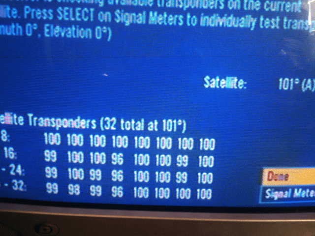

Will it make a difference on signal?
I'm not sure. I always re peak it anyway. I guess it might throw it off 1 or 2 on the TP's.
The reason I re peak it is b/c I want all my customers to have this.
