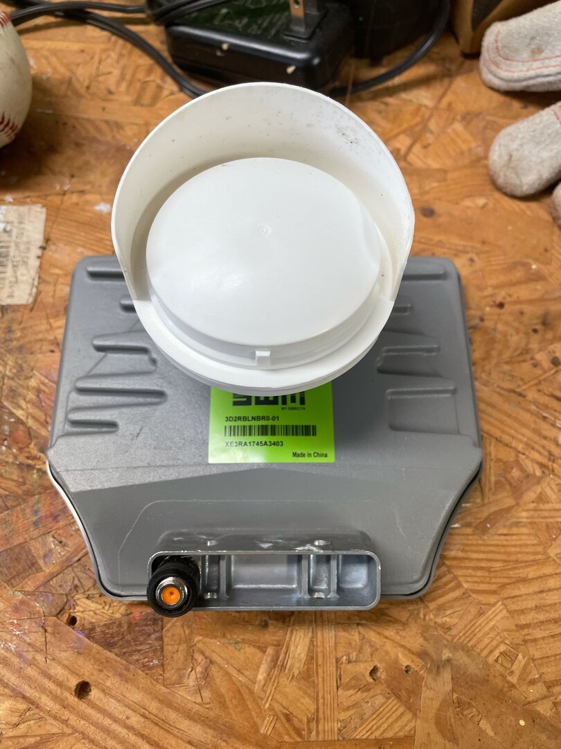

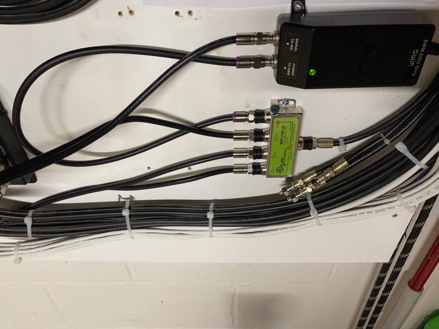

For about a year, I have been struggling with signal issues on my system. Since I mostly use it for NFL Ticket, I haven’t spent much time troubleshooting it. But now, I am “ready for some football”. Well, not really.
System Deets
*SL5 dish with 4 port LNB.
*4 wires from dish to multi port.
*Two HR24/500 dual-tuner receivers hooked up to the outputs using B-band converters.
A year ago, I lost HD version of my locals. At that point, I gave up until a couple weeks ago.
My first step was to replace my multi-switch. Nope.
Re-peaked dish. Nope.
LOS is good. Actually cut down an adjacent tree that was kinda in the way. It was dead anyhow. Nope.
On receiver #1, I have good signal on all transponders, except 101 which is ZERO.
On receiver #2, I have no signal on any transponders. If I remove the b-band converters, I only get 99a, 119 and 103.
Next step I am thinking is a new LNB, but wondered if there were any other steps I could try.
Is it possible that I am not centered on 101?
