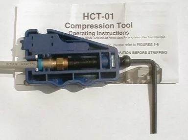

However, stay away from the stripper/crimper combo that I bought on eBay...see attached photo. I only paid like $30 for it, so with 50 connectors as well, it wasnt such a bad deal. I was able to make about a dozen connections before it crapped out.
