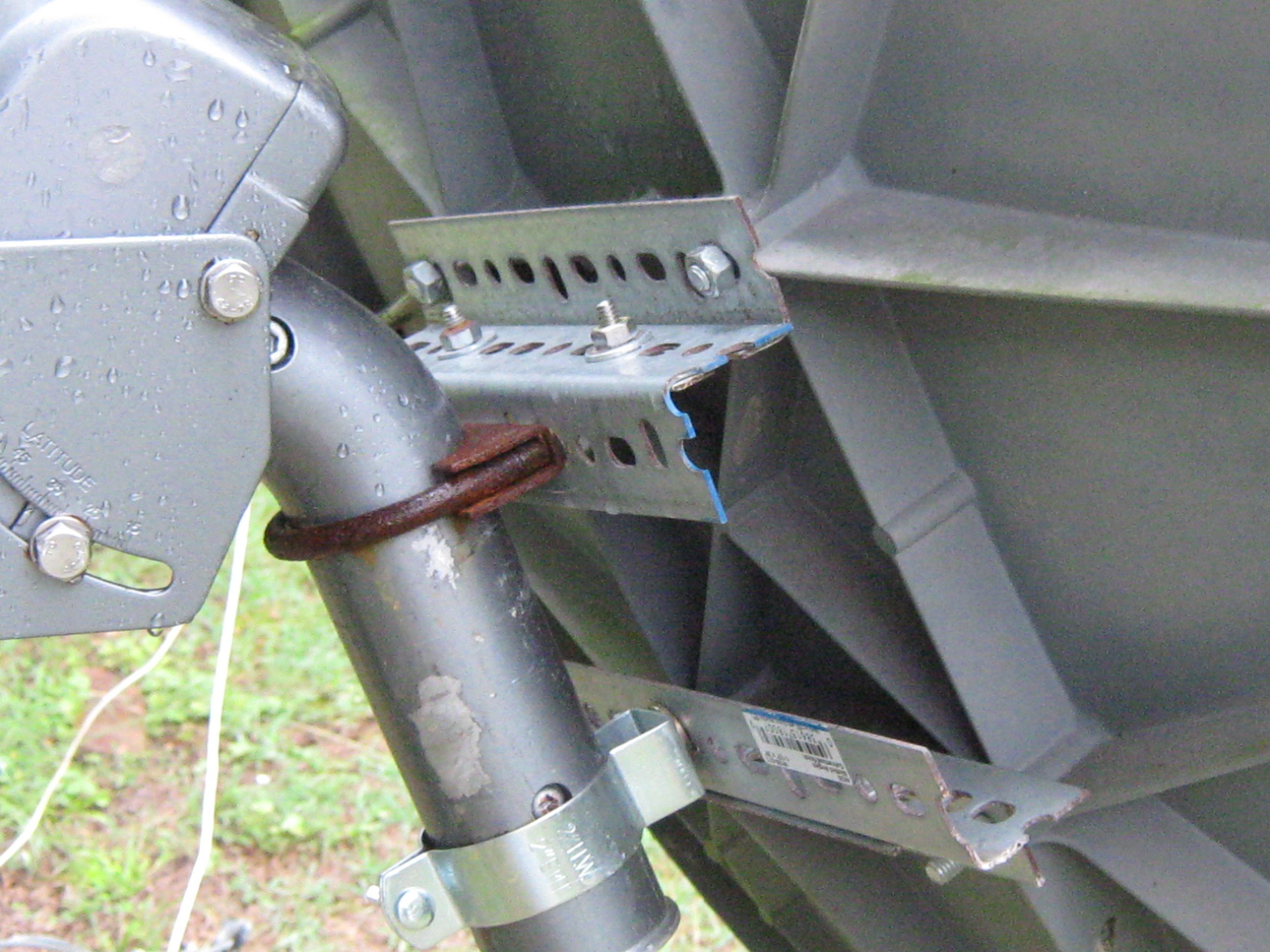

cosmo did you really tote that thing with the pole still on it? Must've been tough,especially if it had a chunk of concrete on it, lol. Good find though. You can make your own bracket to hold that dish to the motor shaft and lose a lot of weight, 2100 should handle it ok. Here's a picture of mine, with some simple bracket material from the hardware store, a muffler clamp and a conduit hanger.

I see something in your motor bracket I always wondered about: Can you set the bracket "declination angle" [if that's the right term] and also use the bracket to set the dish elevation and have it still track the arc correctly, or are you just fortunate enough to live where both angles are the same? I hope you can follow the question, I'm not sure I'm wording it right. Sorry Cosmo I don't mean to hijack your thread, great find on the 84E, I use mine for Hispasat and it booms in.

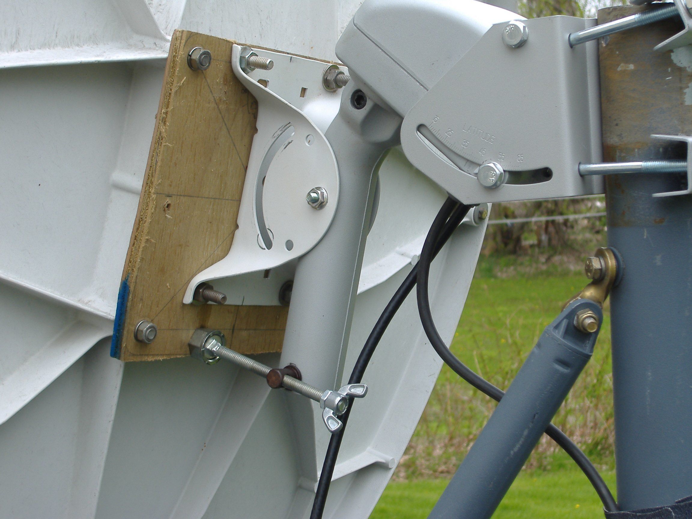

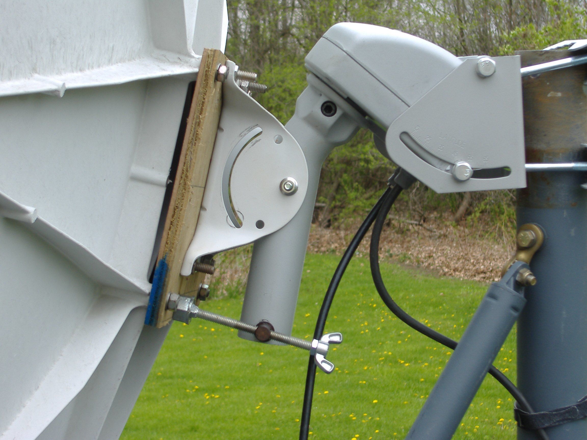

I have a homemade bracket on my 90cm P* dish. What I did was first set it up without the motor and measured the angle on the front of the dish once I found my true south and had it peaked. I then used this angle when attaching the dish to the new mount with the motor. It took very little time to find my true south then and it also tracked the arc perfectly.
But it took a lot of experimentation before I figured that out!
edit - Here are a couple pics of my mount.

An outstanding solution Larobpra, I can clearly see you have separate adjustments for dec and el, what threw me was that it looks like Turbosat is using his motor bracket to adjust both, I didn't think it would track a full arc that way, might lop off extreme east and west.
