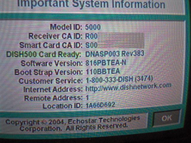

I was trying to update the software on my old 5000 (not active but works good for aiming dishes) :D and the software on it is 2 updates behind (819 is current, I have 816)
Right now I have a cable that is just hooked to 110 so I plugged that cable into the box and did all the normal stuff (check switch, verify signal, upgrade without my permission) and I do have channel 9900 active.
Turned unit off and waited 1/2 hour...no update
turned it back off and waited another 15 mintes..nothing
I know it will take updates (which it has done before) but is the software updates only on 119, 61.5 or 148 (obviously the wings would for Int'l only)?
Or is it because the unit still has an old blue card? (I didnt think that would make a difference)
Right now both of my ports on the 119 LNB are tied into my FTA system for NASA and the audio so I can't hook the box to that (119 is through a Diseqc switch) but 110 I didnt have anything hooked to. These are Legacy dual LNB's

Here it is....R & S #'s deleted for obvious reasons :)
Scott I dont think it was a BETA unit...Used it for 5 years :D:D
oh wait...the unit worked fine...maybe it is a beta unit
Your receiver should get it; look what was a couple days ago:
PID=0875h Sat Jul 15 23:56:03 2006
New FW:'819P'
Upgrading FW:'AAA1'-'BDC1','020P'-'818P'. [8/8]
IRD Model: 5000
List of BootStraps, BuildConfigs and Serial Numbers:
100B BTAA [2] 1-4000000000
100B BTBA [2] 1-4000000000
110B BTAA [2] 1-4000000000
110B BTCA [2] 1-4000000000
110B BTDA [2] 1-4000000000
110B BTEA [2] 1-4000000000
110B BTGA [2] 1-4000000000
120B BTFA [2] 1-4000000000
Or 2 weeks ago:
PID=0875h Sun Jul 02 23:24:32 2006
New FW:'819P'
IRD Model: 5000
so in simple terms, hook it up and leave it hooked up and in a couple days or so it will download the software?
