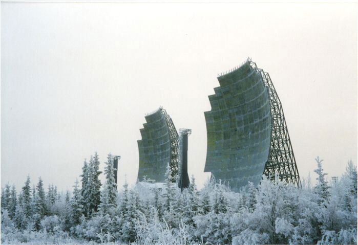

The antennas in my avatar are Tropo reflectors, 120 feet tall. They were part of Alaska's cold war military communications network but they used the "brute force" method for reliable point to point comms up to 250 miles or so, the longer shots used 50 Kw. Off topic but really interesting technology. It was made obsolete with the first satellite systems.
Your avatar is too small for my old man eyes. Can you post a bigger picture of those 120ft antennas?
Sure, they were located in Fort Yukon, Alaska I took them around 1990 before they were demolished. If you want to read more about the technology look up "White Alice Communications System. They used frequencies around 900 Mhz.
