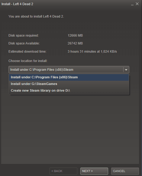

Also, as far as your games go, don't forget with each game you specify where they are installed. Yes, games get a nice performance boost when on the SSD, but don't feel like ALL your games need to go there. If you have games that are like 3+ years old or you know aren't very "intensive" (like say, Brothers or Gone Home) you can set up a directory on your bigger HDD and just throw those games there. If you try and put everything on your SSD you'll run out very quickly.

Thanks! This is a much better price. The Corsair drive hadn't shipped yet so I was able to cancel that order and grab this one instead. I didn't know I could split my steam library between drives. That makes me feel much better knowing my fairly new 1TB won't be useless.
Yup. Just remember to check the drop down that comes up when you tell it to install your game..
