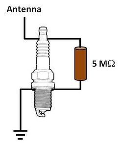

I have had some telephone, forum and email discussions with some members of the forum about lightning and static build up on or dishes. I have measured over 1000 volts between the ungrounded center conductor and earth (single point) ground. I used a 470K ohm resistor tapped in with a tee across the co-ax to ground, but I ran across this solution and it is so much better calculated than my solution, I felt I should post it. For our purposes the gap should be about as close as you can make it - definitely a business card or less. With the 470,000 ohm resistor the voltage never went over a couple of volts, here.
The graphic shows a method of draining charge from an antenna while also providing some protection against high voltages from static electricity. The basic idea is presented on the K2AV Folded Counterpoise antenna website. The value of the 5-Mohm resistor is not critical and just needs to be high enough to minimize its effect on antenna impedance while surviving normal operation. Power ratings of 2 watts or better are generally recommended in this application. The spark plug can be mounted directly to a grounded plate, as well.
An ordinary spark plug and a high-value non-inductive resistor (carbon composition or metal oxide) provide some inexpensive protection for static charge building up on your antenna. (Thanks, K2AV) ImageProxy.mvc.jpgFrom an ARRL newsletter, today! That is a 5 meg-ohm resistor. My 470K was a 2 watt as that is what I had.

Great idea for antennae where ground coupling is an issue. Usually here in heavy clay soil there is no problem but this year it has been very dry so I might have to re-think that issue.
The spark plug idea has been around for a while. I set the gap really close until I start seeing increase in SWR or peaks cutting off (1kw or more). The plug is best close to the antenna feed point where the voltage seems to be lowest on the peak of the sine wave. It has saved many arc plugs in my lightning protection system by keeping a lid on that induced voltage. Snow is the worst offender as it can build up really high charges over a long period of time. I never thought of using a resistor though. What about resistor spark plugs?? Might have to try one...

A resistor plug has the resistor in series with the gap, and therefore will not drain the slow buildups.

Currently I'm repairing an antenna pre-amplifier for my TV antenna (not satellite) that has gone bad and it has two diodes across the input coax connection (in parallel, one in each direction) to limit the input signal to the amplifier. Reading this thread, I thought this would also do a great job of bleeding off the static once the voltage built up to the diode junction voltage.
Yes that's absolutely right! It will do nothing... the parallel resistor will do the job.
