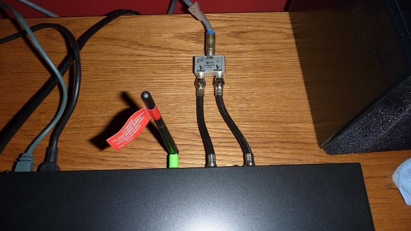

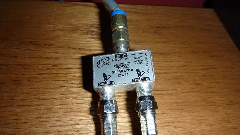

I have a single coaxial feed from the dish to a splitter at the receiver. The splitter has two feeds - one for TV1; one for TV2.
Please see the pictures - is this setup correctly?

That isn't actually a splitter. It is a separator. That is how most dual tuner installs are done and should not be a problem at all.
