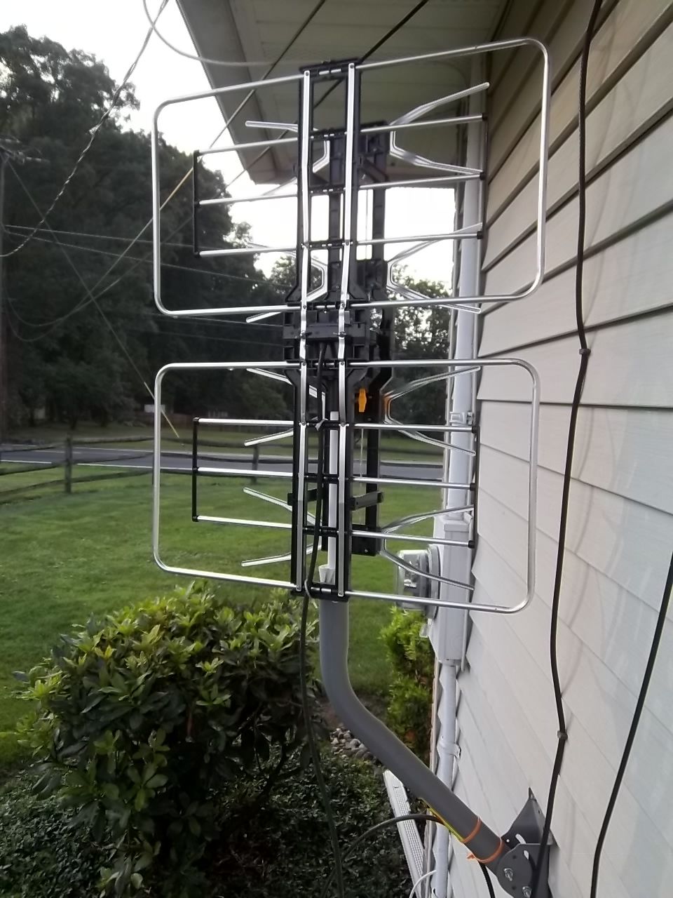

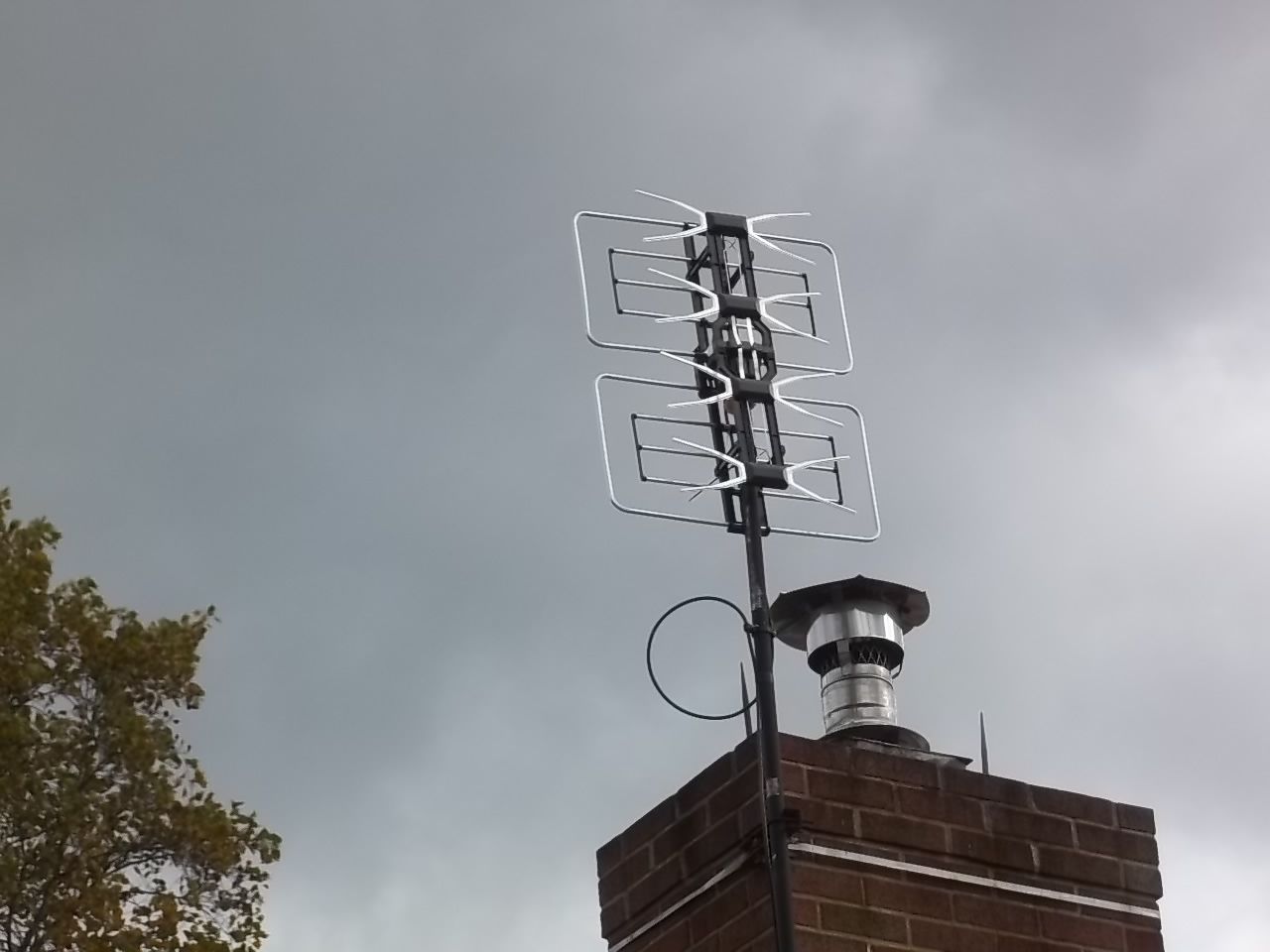

My first outside TV antenna mounted where the pay TV satellite dish was on side of the house. Wasn't too bad. Has a great preamp. Later moved it to the roof, even better. Has a quirky rotator though, sometimes it gets stuck and have to get a 22 foot painter's pole to "nudge" it a bit from ground level.
When first purchased it looked kind of flimsy but its been on the roof through wind, rain, ice, snow, hasn't fallen apart yet.
