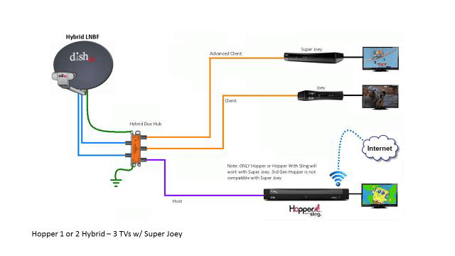

Done and done, I'm thinking the super joey was installed on the wrong port of the hybrid duo hub and it was just working correctly until we lost power for a few hours todayReboot everything. If that doesn't fix it check the wire going from the dish to the integrator.
It's been plugged into the center that doesn't say host like the hopper one or the one going up the joey in the game room, could this be the cause of the troubleDone and done, I'm thinking the super joey was installed on the wrong port of the hybrid duo hub and it was just working correctly until we lost power for a few hours today

Yup the tech had it hooked up wrong thanks jsheridan
