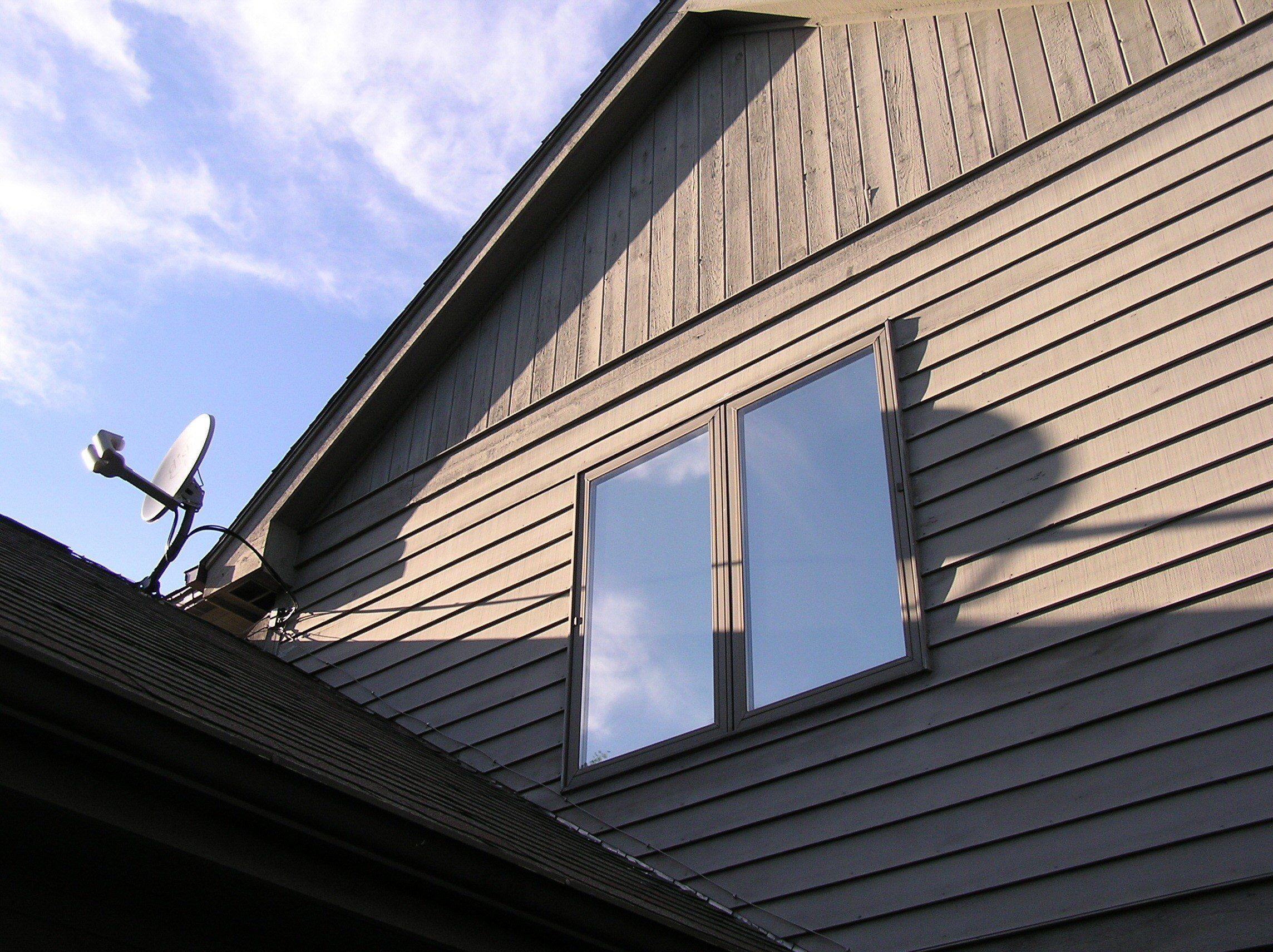

I have been a Dish customer for seven years and have just decided to upgrade to the 721 and SuperDish (ROC locals). Currently my D500 is mounted to the roof, see photo (if I did it right).
My HOA has REQUESTED that new dish installations be mounted to the vertical surface to minimize rain leakage problems. If I go that way I need expert advice as to whether to mount it to the cedar* siding by using an inverted piece(s) of siding to make the surface flush OR mount it to the vertical 3/4" cedar* siding above...both are backed with 1/2" CDX plywood. I believe that the 3/4" siding will make it much more difficult for the installer to find the studs.

The SuperDish weighs a heck of a lot more than a Dish 500. That's gotta be your primary consideration.

Well, just be aware that a SuperDish wall mount requires a lot more holes - to do it right requires 2 extra support arms.
Superdishes are best pole mounted... if your house has touchy shingling, i wouldn't want a superdish on it. I'm sure it can be done if ALOT of time and care when into it. Predrilling, maybe even putting a rubber gasket in between the feett of the stabilizer arms and the shingling.
I'm just thinking the wind loads and flexing stresses might wreak havoc on your siding.
