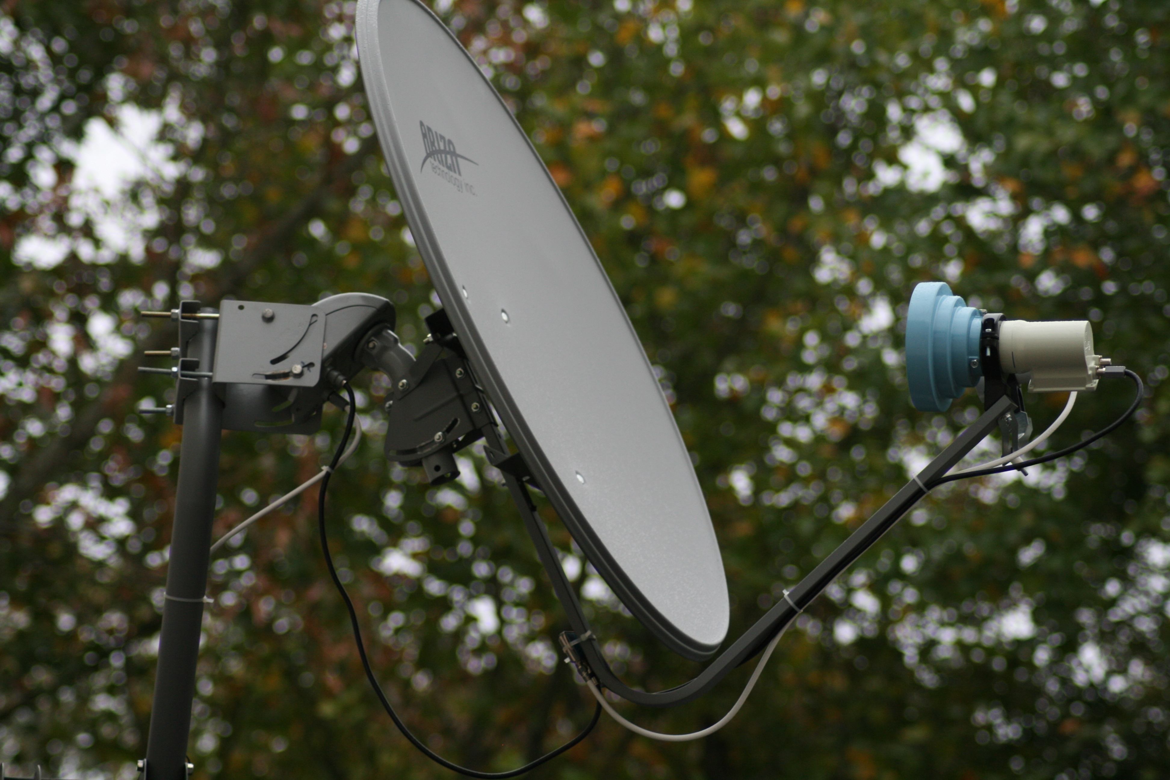

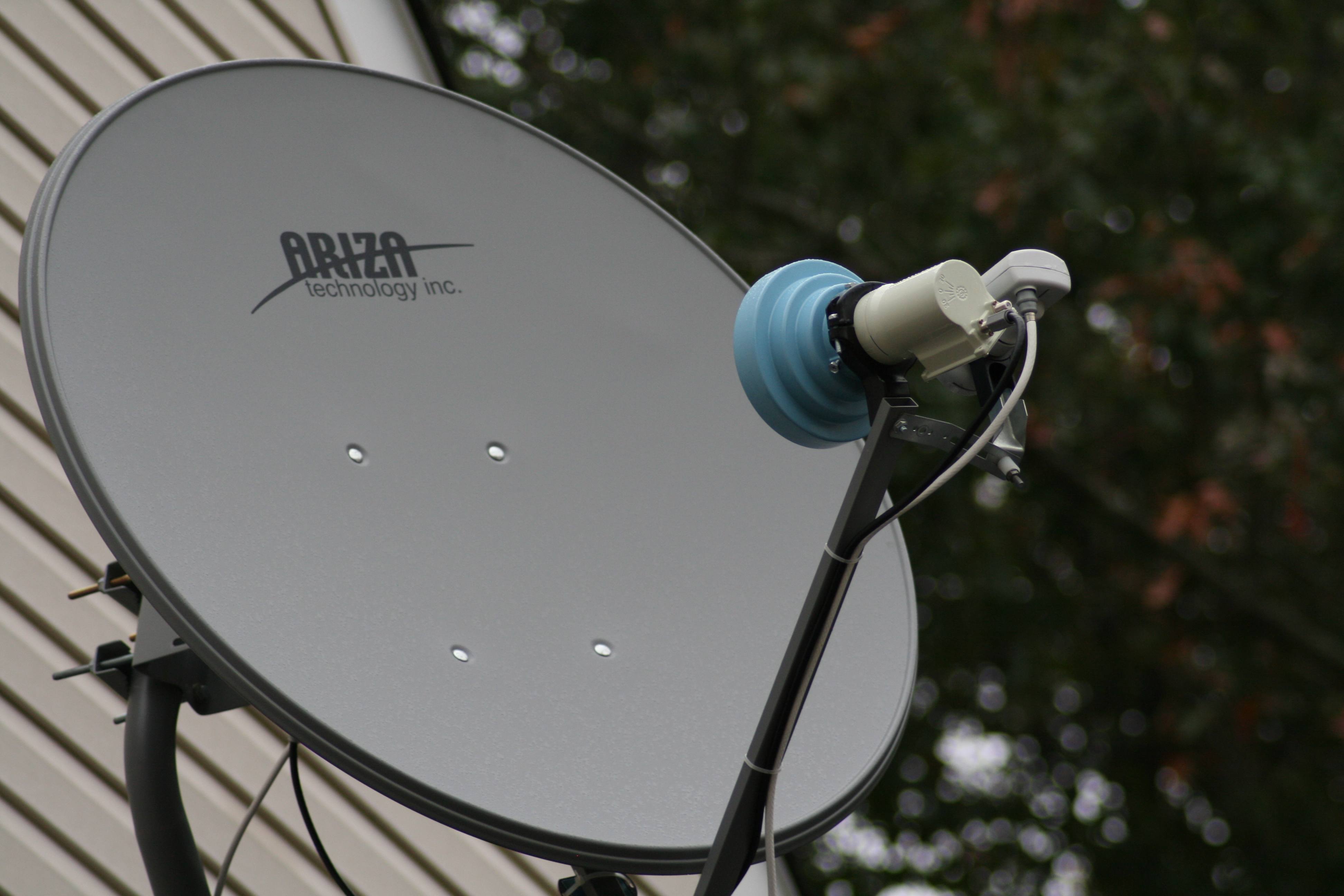

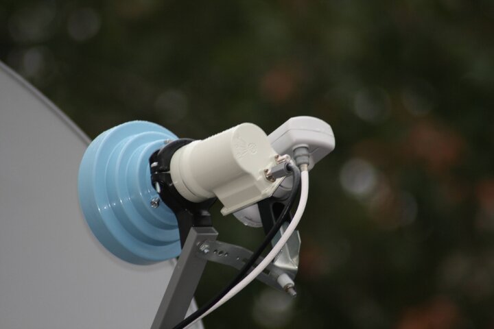

Hi i did try hitting 3820 on the Lnb with the meter and i had a very strong lock. Making some progress. After resetting my reciever i was able to hit some channels on my reciever but only a few and i am getting anything to come in on the channels.

Don't expect a whole lot . That dish is small, and being motorized , it is probably not quite as well tuned as a fixed dish could be , for a single sat. The 3720 tp is strong, and you will probably get the CW mux fine, once you figure out how to manually enter the PID info. You are only going to get the strongest tp's with that setup, but that may work well for you, at that.

Hi can you clarify something. when i have the meter on the LNB i can hit vertical signal but i have to rotate the LNB to hit the Horizontal on the same transponder. So when i do a blind scan on my reciever is it going to pick up both or am i limmited to just vertical or horizontal. Also i was told the dish i have is identical to the Hotdish90 and should be able to get the C band. Is this accurate or just wishfull thinking.
if your dish is less than 6 feet you will be lucky to pickup any c-band at all.....doesnt really matter who makes the dish....
The receiver selects either V polarity or H polarity , depending upon the voltage it supplies to the lnbf ( 13V or 18V) . A 90cm dish is just a toy for C-band reception. The typical minimum size for C-band is 6 foot, although you can reliably get the stronger tp's with a 4 foot mini-BUD, but believe me, a 4 footer only makes you want a 6 foot dish.
The typical minimum size for C-band is 6 foot, although you can reliably get the stronger tp's with a 4 foot mini-BUD, but believe me,a 4 footer only makes you want a 6 foot dish.
Truer words have never been spoken. Unless there is just a specific channel or two you want to get on C-band, I wouldn't even bother with a small dish. It's just too much of a headache for minimal results.
