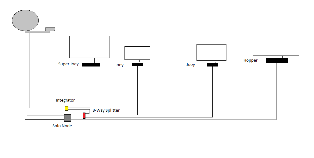

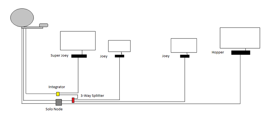

You will need a cable from the Dish to the Super Joey. You will also need an Integrator in the line that connects the Super Joey to the Node. Here is my drawing of the wiring for a Hopper with Super Joey and two Joeys.
