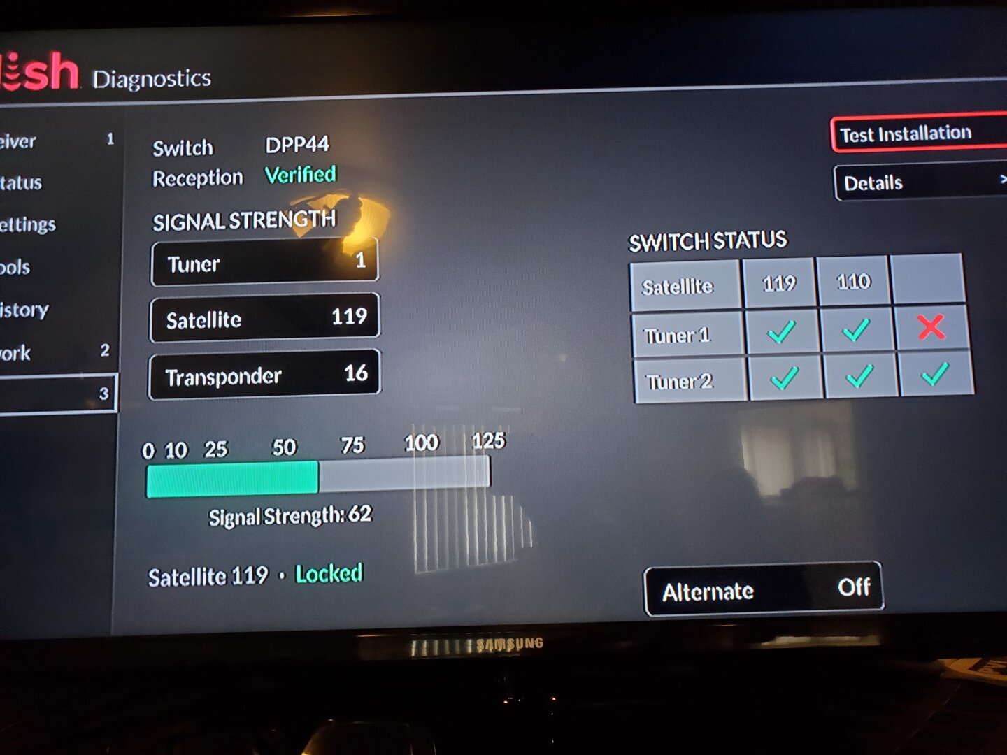

I don't really want to get off on this tangent, but the software that runs Wallys is the worst I have seen since the 7100/7200 WebTv models... And those were HORRIBLE. Not so much on the face of it, it is pretty and functional, but when dealing with connectivity to the dish and switch matrix, it can be a nightmare. The worst problem is the "Tuner 0" glitch.
This is results of a check switch we ran on our test bench (Wally brought in by customer). We disconnected the 129 feed from our 44 switch when it was retired, but still....
They are just glitchy AH... It is stuff like that ^ that causes all kinds of issues, especially in commercial installs.
