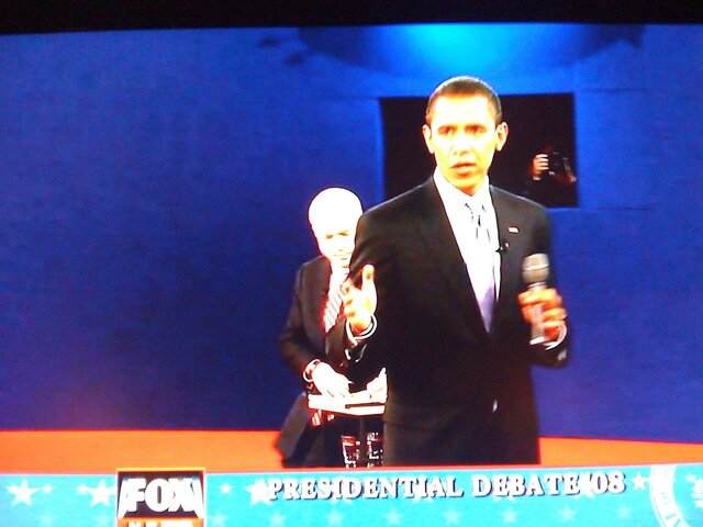

1) all pictures seem soft, lacking crisp detail
2) intermittently, I will lose sound for around a second.

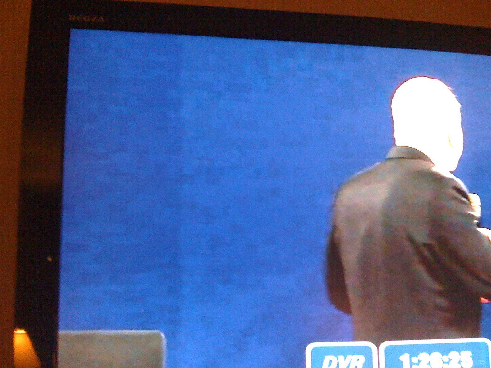

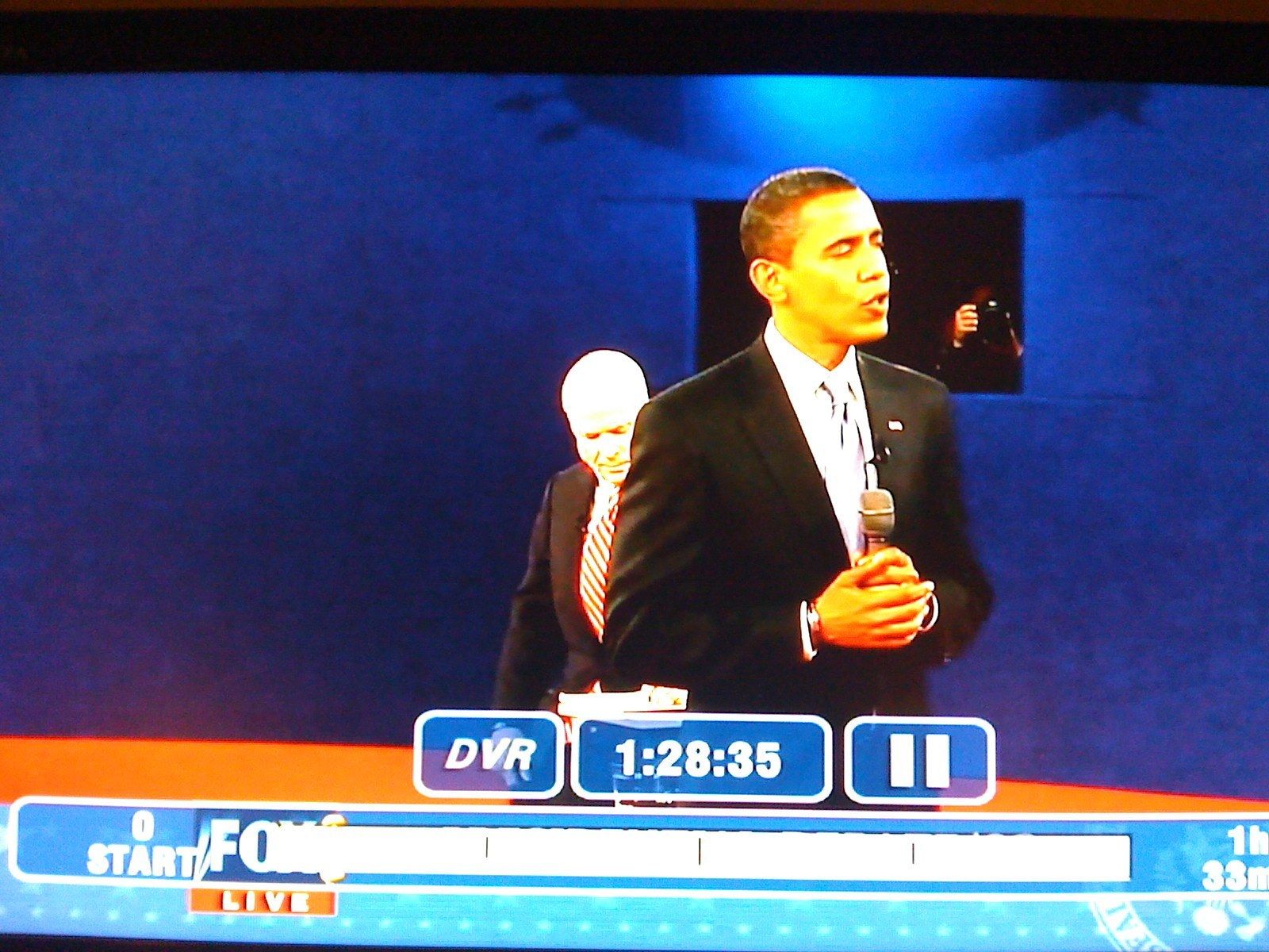

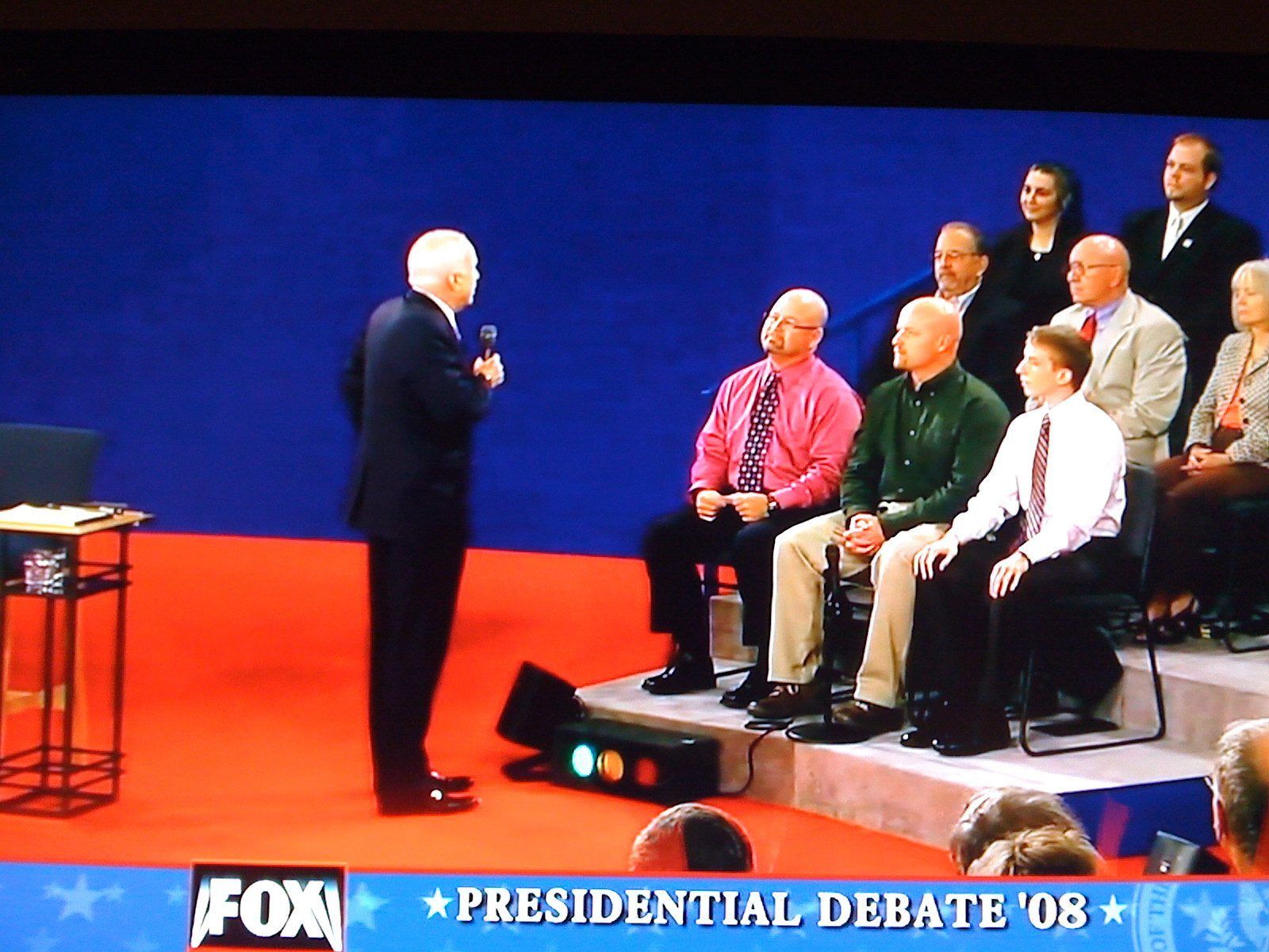

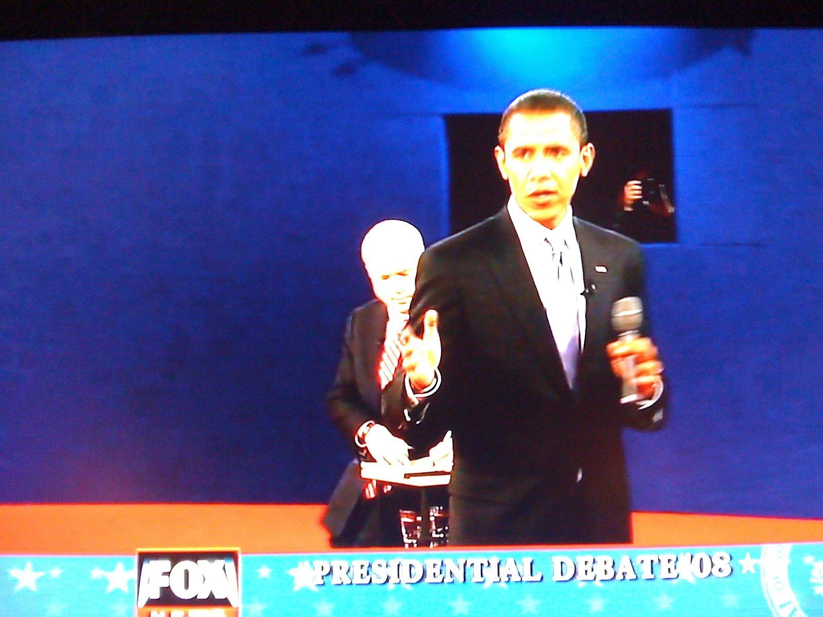

3) very often, I will see "blocky" artifacts in dark solid backgrounds or extremely grainy detail. See these examples from the Presidential Debate.
I find this to be unacceptable and really hope that there is just something wrong that is very correctable. I find the picture quality overall to be slightly less than my upscaling dvd player (!).
I have my 722 connected to my 1080P tv via both composite and HDMI - both have similar problems.

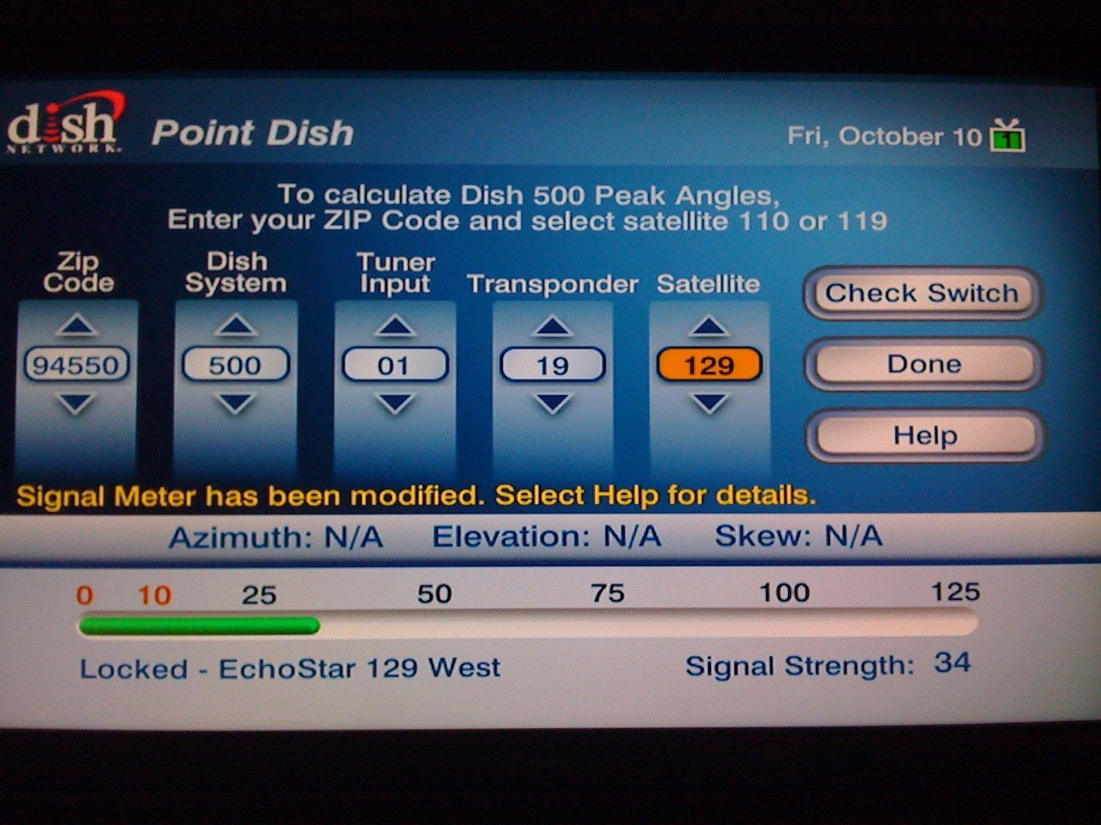

The signal strength on one of the transponders IS low (less than 30) and dish is coming out this weekend to investigate. However, as I understand it, a digital signal you either get or you don't - there are no variations in strength.
What can I do to make the quality better? Is everyone simply living with this level of quality? Can I epect a stronger signal to remedy any of this?

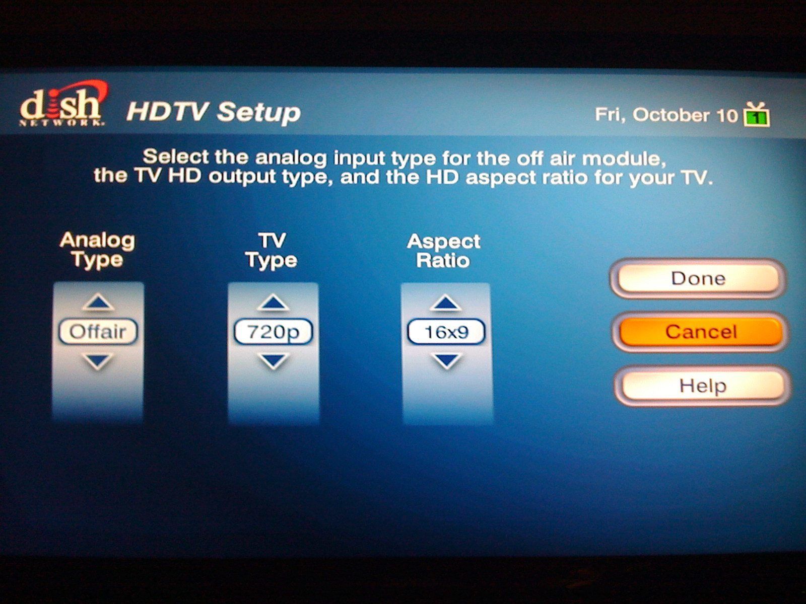

"blocky" artifacts are very common on any live feed, MPEG real time encoding is not yet up to pre-recorded encoding levels. Hit the "info" button on your TV to see what resolution your Dish receiver is outputting. Looks like Dish may be using a SD feed from your local FOX station.

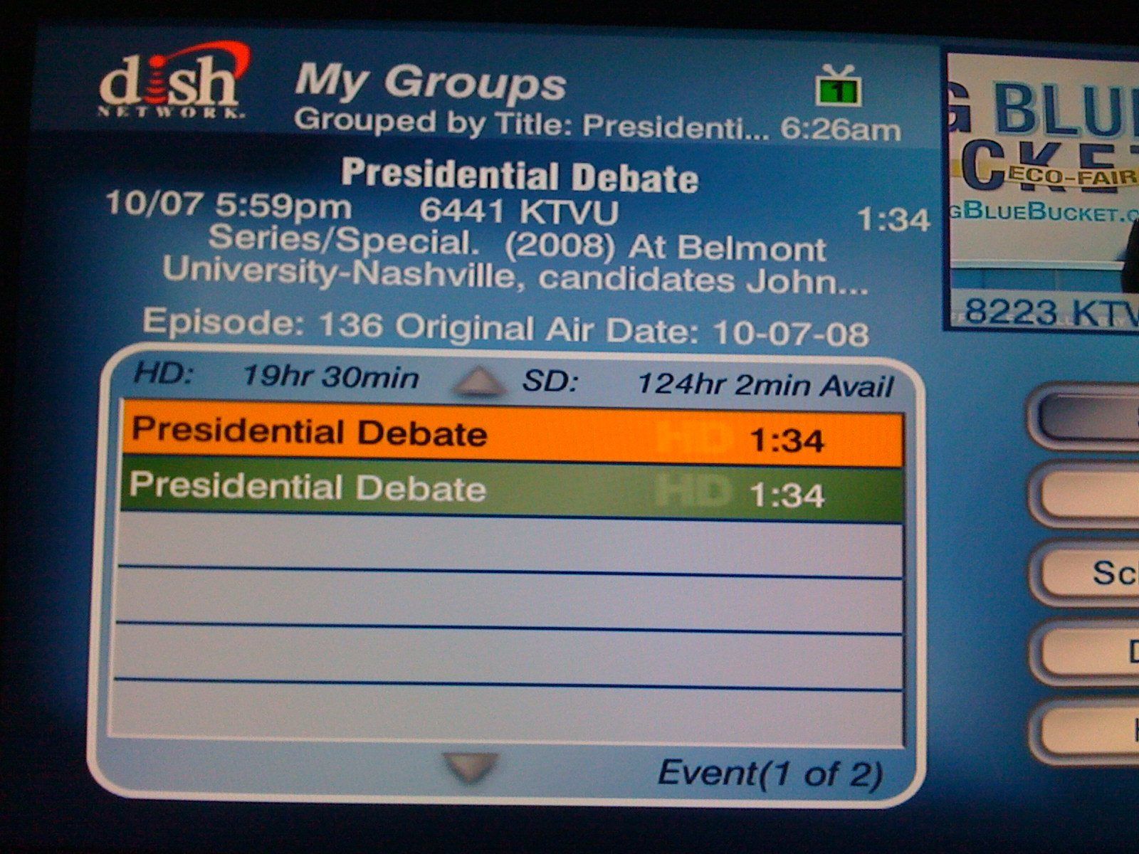

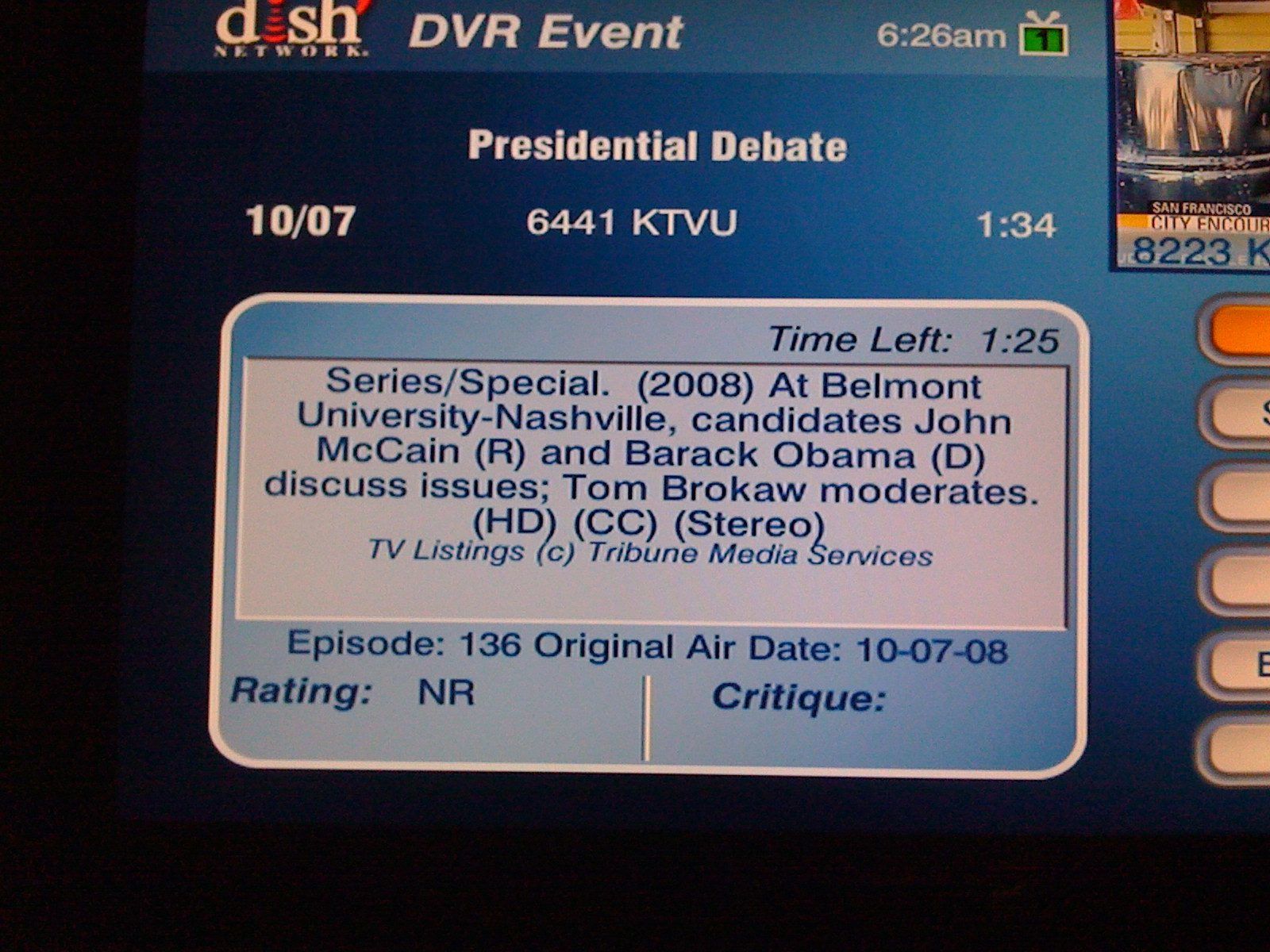

The debates were broadcast in HD. I've attached screen shots of the event details.
Even if they weren't, I don't think the output would be acceptable.
I have my output set at 720p. It looks the same at 1080i.
I'm also attaching a pic of one of the diagnostic screens.
I am encouraged to hear that this doesn't seem to be the norm...
@ Jim S. - I've attached pics of both the program and my output settings showing HD
@goaliebob99 - I was watching my local FOX channel in HD
@digital echo - comcast signal looked fantastic.

I don't have HD locals via Dish. But I can say that Comcast may or may not look better than Dish, depending on how greedy your local system has been about packing multiple signals into one carrier. Speaking of which, do you know how many subchannels your local Fox station is broadcasting? They could be broadcasting enough of them to be detrimental to the HD quality.
In your pictures of the debate, I can't tell whether the picture quality is really that bad, or whether your TV is not calibrated right, or whether it's just the photography making them look washed out like a bad analog signal.

Our Dish Network HD locals come from 119 not 129 and looking at your signal for 129 that's pretty close to the best you're going to get in our area. Once Ciel 2 is launched, we should get better signal from 129.
Yes but I don't think Fox passed the HD, even if they did they had the poorest PQ out of all the locals in my area for the debate. For the remaining debate compare ABC,CNN,CBS and NBC to fox.

- Your color adjustment on your TV is set too high (like 90% of people).
