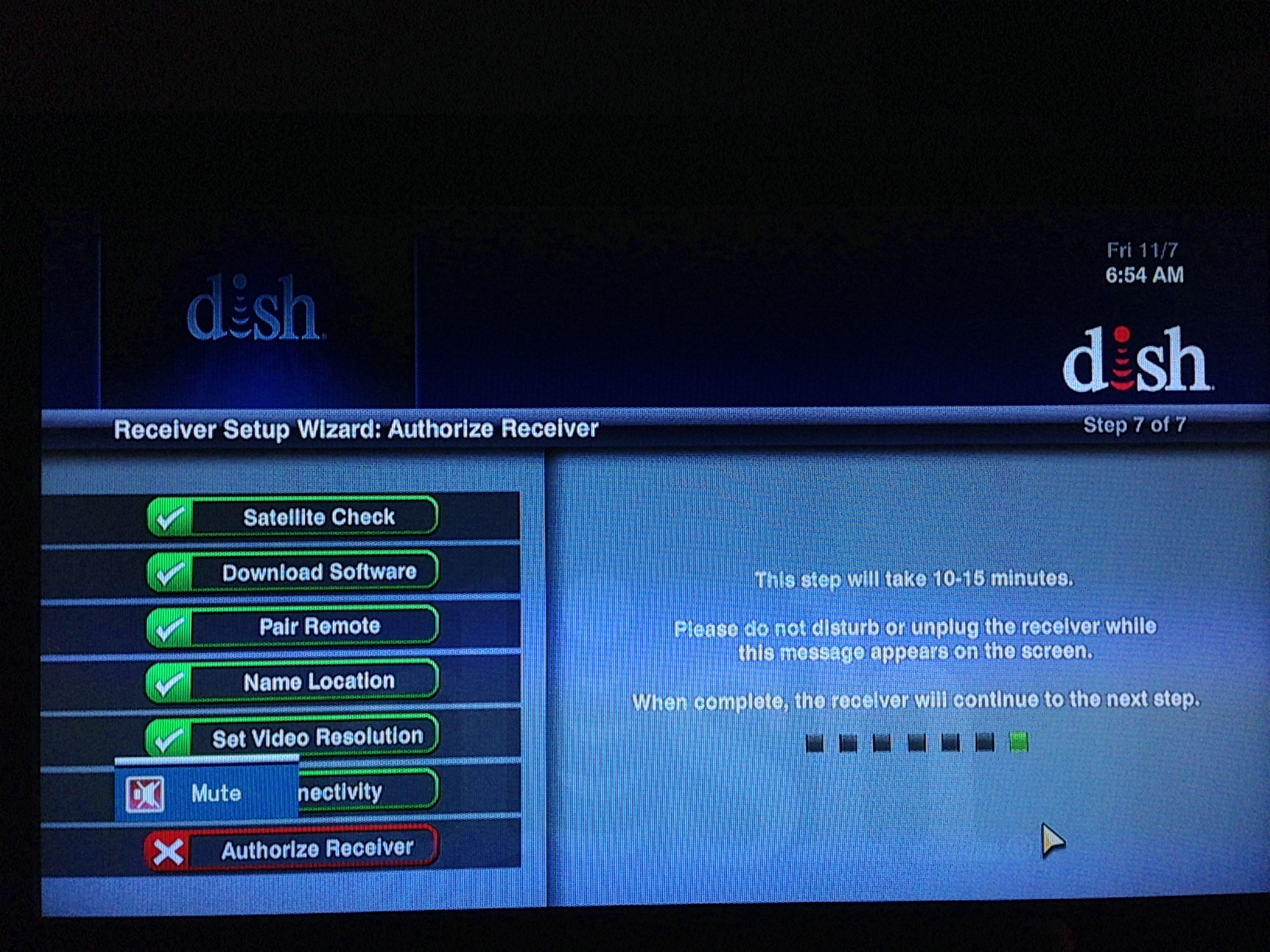

I am swapping out my two original Hoppers with two HWS. I disconnected the old Hoppers and hooked up the two new HWS. I followed the steps, downloaded the software updates, paired my remote and got to the step to authorize the receivers. I called Dish to authorize. I worked with the guy on the phone for 45 minutes but the receivers never did start working. I checked my Dish account online and both receivers are now authorized but still not working. The attached image shows the message that I have on both receivers and this message has been displaying for over an hour after getting off the phone with Dish. What do I need to do?

Yep hit didn't go through the first time for some reason, or they didn't push "the button".
Actually i've ran into this a couple of times and a simple reset fixed it. Nothing to worry about. Unplug for ten seconds then plug back in
Yup. We see it from time to time on new installs and a reset will usually fix it.
Hmmmmm. Well the guy on the phone tried to "hit" it several times but it did not work. He also had me reset the receiver and it did not work. He was at the point that he was going to send out a tech but I can't imagine why I would need a tech for a simple hopper to hws swap out.
The guy did not seem real knowledgeable so I said lets give it over night and I will call back if not working. Well, it is still not working.
Call back and get a different csr, tell them you'd like to verify the receiver and smart card numbers, then have an activation hit sent. First guy might not have typed the numbers in correctly...
I called Dish again and the rep sent a "Hit" and promised it would work.......but it didn't.
I then contacted Jason with DIRT and he got it working.
