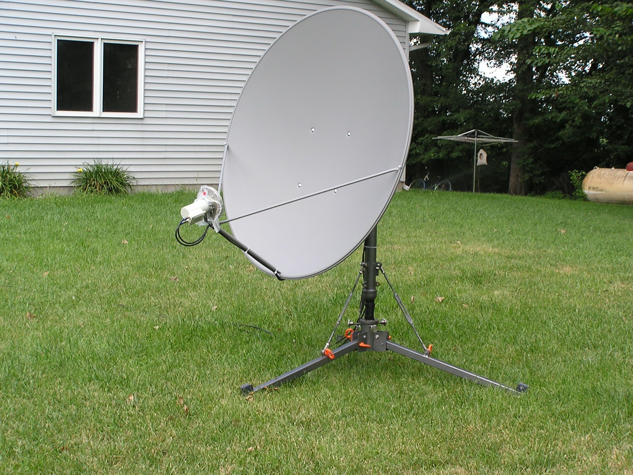

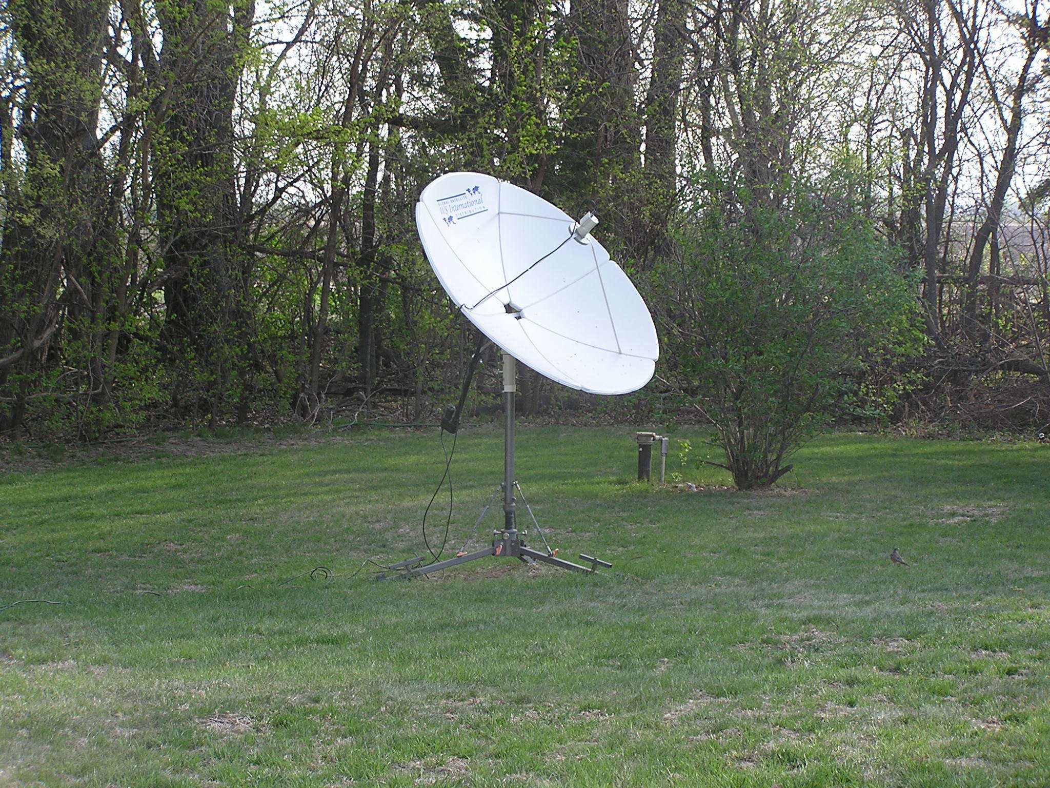

I hope the channel lists from my S9 Openbox attach properly. Maybe this will help answer any questions as to what a 4 ft offset dish can receive for C-band channels, and what a 6 ft solid panel prime focus dish can receive. I had the 4 ft offset dish set up for several years in the back yard, just last week I set up the 6 foot prime focus on the same tripod. I haven't the time to tweak the new dish so I maybe able to get in more channels, waiting for a calm day before attempting any dish adjustments. However I very much doubt I can get in the NBC channels on 105W.
I would also like to thank "Magic Static" for the Uniden actuator, it works great with this dish setup.
The attached channel lists require a channel editor to open and view, believe I use the PVR800HD editor. The TP_PROG4ft zip file is from the 4ft offset dish scans, the other is dumped from my receiver this morning using the prime focus 6ft dish. Disregard any channels listed east of 55.5W as I can not view them at my local due to trees, I believe I manually added a view channels during winter testing when there was no foilage on the trees but wasn't able to detect any signals at the time. Some of the channels on the lists may no longer be in broadcast as the list was a work in process over several months. Actually I am loosing most signal now from 55.5W as the trees are almost completely leafed out and obstruct that sat.
I have attached photos of both dish setups, the dish location is on an acerage just outside the small town of North Bend NE.
