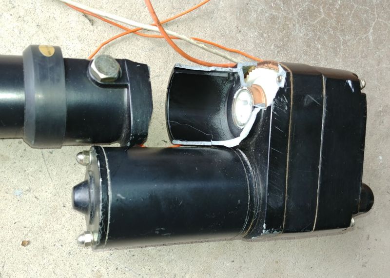

Well, it was nice while it lasted. The nearly new actuator I bought is toast thanks to UPS so it's back to shopping. :mad:

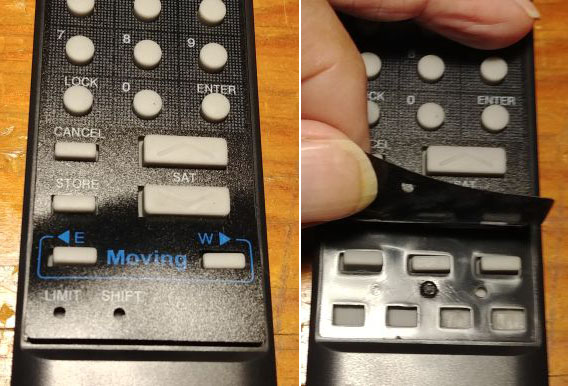

Got the refund, found another actuator, should be here next week. The PR1200 V-Box arrived today. Surprisingly heavy for it's size. What's up with the remote? The template shows an East & West button but the template is lifted and underneath there's a 3rd button in between but no opening in the template for it? Is this normal?

I wasn't sure folks might have understood what I meant about the remote so here's a couple of pics. Note the bottom inch or so of the overlay is not glued down to the remote. If it were it seems to me it would depress that middle button and I have no idea what it might do, like a hard reset for instance. Is everybody's remote like this? Seems odd. o_O

my guess is that the remote is a fairly generic remote that the manufacturer of the PR1200 did not design, and it ended up with unused buttons. As we all know the market for such dish movers is a bit narrow, and it would be understandable that they did not spend much time and money on design . Same thing with the inverted buttons mentionned earlier. Still kinda lousy, I think it would have been better to have th eproper hole in the overlay and leave it unlabled and unused... This sure is no ASC-1...
Reactions: FTA4PA

I am happy to post this update - Rick very kindly sent me a correct replacement remote so all is well.
