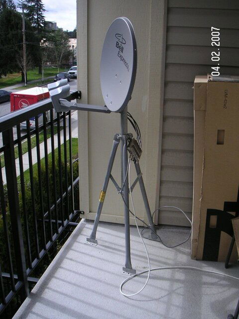

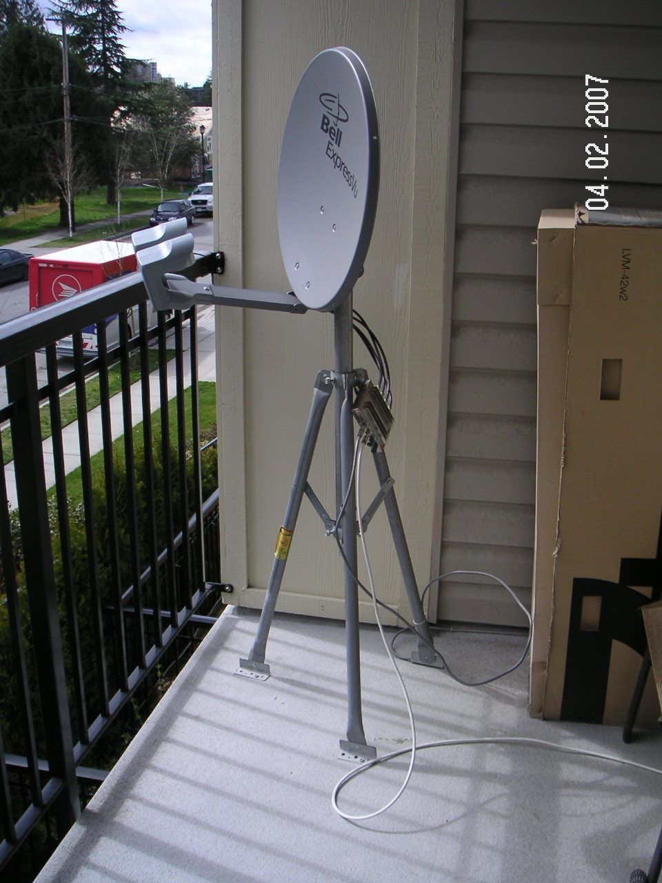

Hi there, can someone tell me whether I will be able to use the following to attatch the 5LNB satellite dish?
Should be an attatchment to this post...at least I hope. ;)
Thanks
Likely no.
1. Looks like a common tripod found at Radio Shack. Doesn't look like you can use the require 2" diam mast. (chk it)
3. It is not very stable.
3. The vast majority of USA apartment/townhome/rental mgmt companies, do not accept drilling holes or bolting into their property. So know you landlord VERY, VERY well and get things in writing BEFORE you do anything.
Hmm never any problems with my current dish under this set up. I checked the pole and hmm it maybe under 2inches, seems pretty close.
Thanks
Your current dish is a totally different provider and not made to the exact same specs. So you are not comparing apples to apples.
Almost any standard tri-pod will accept a 2" OD mast. ALMOST any.
An option we use is bolt the tripod legs to a sheet of exterior 3/4" plywood cut in a triangle that matches the spacing and placement of the legs. Then place concrete blocks on the plywood. Works OK.
I still prefer using a non-penitrating roof mount with a 2" mast (or 2-3/8" mast with reduction adapter) and several concrete blocks as ballast. It has a much larger foot print and the dish is lower, but if you can, it is a better method.
