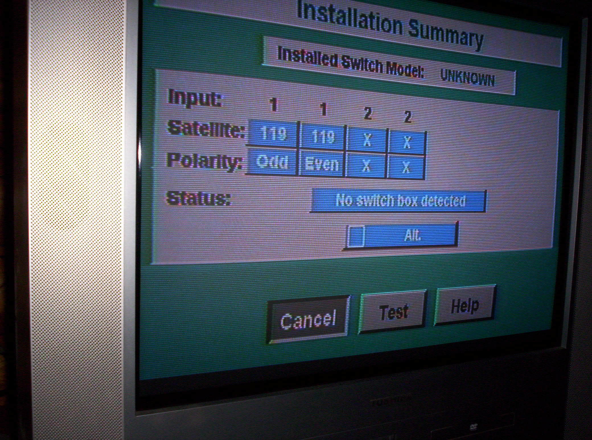

Switch round II - Photo as requested
Thank you, thank you for your quick reply! Please see photo. I see what you're saying now....I mistakenly though I was getting all the satellites I listed but it's only possible to get 119 & 110 (and only 119 is registering) with the one dish that's present. Another question came up too....I saw on the screen that pops up just before the photo was taken (when you can select the 4 satellites & transponders) a box to check that says "Dish 500"...should this be checked on 119, 110, both or neither? I may be mistaken but I don't think either was checked at the moment. So, what are your thoughts now? PS When I'm unable to view a channel it'll say (error message) " 002 Satellite signal has been lost, signal acquisition is in progress. Please wait or press the (up or down) arrow button to change channels. Satellite 119 Transponder 3"

First of all, a switch check tests only odd and even transponders (no specific numbers) on all satellite locations. The picture you attached shows that 119° switch check is fine. However you cannot receive any other satellite at this time.

if you could make another picture of previous screen selecting sat 119 and tp3; what SS value there ?
And a picture like Tony posted will help too - you missed 110W somehow.

I can take a photo of the screen like I did before but when I put it on Sat 119 transponder 3 there is no reading...it simply says "not locked"
