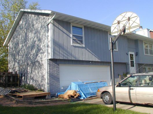

I want to install coax in my 70's home for my dish. I already have a setup with RG59. But want to upgrade for HDTV in the future.
My Satellite guy will sell my the cable and inform me how many cables to run. But Im doing the work. I ran the RG59 on the outside of my home in areas which will be covered by the vinyl siding I will install. But while looking at installing the RG6. I noticed the city somehow ran a water meter cable through my finished duct chase in the basement to the outside wall for the remote read. If I can do the same. It will save me from running the new cable in a routered groove on the outside before the new siding. Problem is I need to pull or push down this chase. Then jump up into a joist space and make a left. I have seen fiberglass pole system which are used to push and pull wire. Is this what the city guys did? I would need two snakes and push from both ends and somehow hook together where I need to go down the joist space. Can anyone recommend this super snake?

Yes I have 4" insulated walls and Im in cold & hot Iowa. Single story split foyer with basement.
I dont have any duct work going to the attic. But I think I can pull through the B vent chase maybe. The only thing hooked to the B vent doublewall pipe is a water heater. No furnace so it wont get to warm on the outside.
I already have a few coax outlets in the TV/ livingroom area with rg59 and I dont want to take the chance of disturbing the insulation rewiring them from above. So I either need to drill the bottom plate in the wall for one, or come in from the outside. It all depends if I can get through the god forsaken areas. Mainly the basement ductwork chase built from 2x4's covered with drywall for about 5 feet. Then up into a joist space and over about 10 feet.:rolleyes: It will be fun. And into a addition TV room area which has a unfinished ceiling thank god.
Thing is ,I need 3 coax cables for Direct over the 2 for Dish. Running 3 on the outside routered into my plywood siding may be more challanging than one rg59. So Im pushing for inside.
