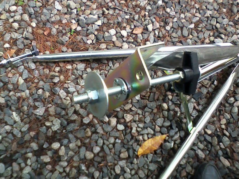

I modified a basic $25 tripod roof mount with about $15 in additional hardware to add adjustable leveling feet and handwheel shaft locking. I use it with an easy to adjust/aim 1000.4 dish, but the slightly smaller 1000.2 would also work. I've been using the tripod extensively since 2008, and other than an occasional spritz with WD-40, no maintenance has been needed. I anchor the tripod with either a 5-gallon bucket 1/2-2/3 filled with water or one or two "dog tie out" screw in anchors and adjustable tent tie downs.
Here's a stupid question. Where'd you get the $25 tripod
And what additional hardware did you get?

I found mine on eBay about 10 years ago, but the $35 Winegard SW-0010 is identical except mine included the 1-5/8" shaft for the dish mount. The additional hardware consisted of fifteen pop-rivets, three 5/16" threaded inserts for furniture leveling feet, three 8" x 5/16" carriage bolts, three 5/16" plastic handled 'T' nuts, three 5/16 lock nuts, six 5/16" hex nuts, three 5/16" wing nuts, and three 5/16" fender washers. The only tools needed were an electric drill with a 1/8" bit, a pop-rivet tool, and a couple of open end or adjustable wrenches. All of the hardware was purchased at a local True Value hardware store. The photo shows the leveling foot assembly, but not visible are the two pop-rivets that lock each of the swivel feet in a fixed position. Assembly time was about an hour, and no machine shop was needed... ;)
I'll also add that in 10 years of using this tripod, I've only needed to stick boards under the feet twice. Once due to a steep side hill location that was beyond the range of one leg, and once due to extremely soft, wet ground.
