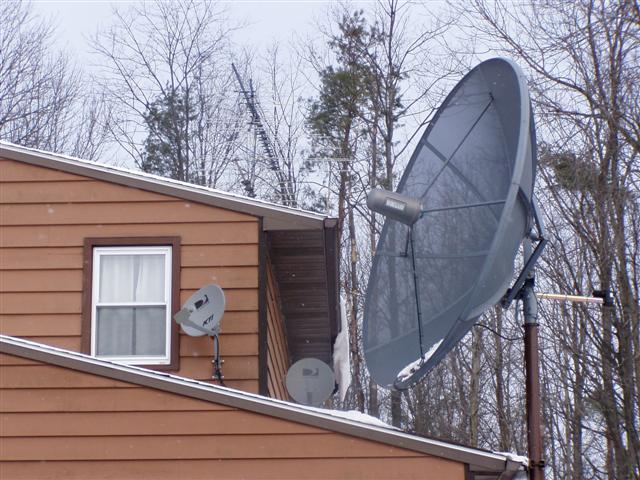

Smiling...no WAF at my house...see picture...the hd8200p is towards the back.
may take the big dish down this summer...do not use it much anymore...painted the pole brown to make it look like a tree...haha...A small WAF touch.
