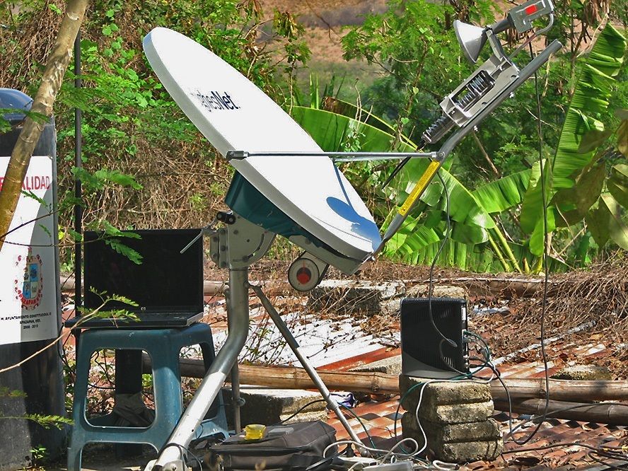

I have recently purchased a HughesNet HN7000S IPS modem and .98 m round dish system from Elitsatnetworks.com and service from www.hughesnet.mx (sworn authorized resellers of HughesNet products). I live in Veracruz, Mexico (19.33 north, 96.56 west). I have used and installed my own equipment for many years, starting with DirectWay in the U.S. in Arizona in 2002. Attached is a picture of the installation of this equipment. I get only a signal strength of 15 no matter where I point the dish in the vicinity of the coordinates for SatMex6.

One of my dificulties is that this new dish (round) my old one was oval has lots of flat surfaces to put my tilt meter but none of them point me to where I found satmex6 4 months ago. I finally figured that the most accurate measure of Elevation is to put a staightedge accross the 2 edges of the dish (with the modem unplugged) and put my tiltmeter on that. This puts me about where I remember I should be. right?

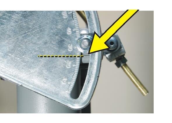

I noticed where you had the elevation gauge and wondered what you were doing there.
Better to use the elevation gauge on the left side of the HughesNet mount. Add a couple of degrees to start, to allow for sag.
Note some types of HN mounts have the marker reference line on the top instead of the bottom. Check yours.

Post a close up photo of the left side of the mount. If there are degree markings on the side of the elevation plate, then there is sure to be a corresponding indicator line or edge that can be seen through the elevation slot.
If there is no indented indicator line, then most likely it's the top edge of that metal piece that can be viewed through the slot.
Also, you do have a decent compass, correct?
elevation guide and compass
I do not see any indentation. It looks like the metal edge behind the slot is what I should use.

I made anothr important discovery. The boom needs to be under some pressure when the bolts ate tightened. The instructions say that this is critical but do not say exactly HOW much pressure the boom needs. Well the second time I took the dish down, dissassembled it and then reassembled it, my husband in his frustration really put a lot of pressure on the boom. (the first time he did not put enough.) Eyeballing it the cone looked like it was aimed a little below the center of the dish. I still was having trouble finding a signal. I loosened the bolts holding the brace for the boom just a little and let the boom "relax" an eighth of an inch. This raised the cone and it looked like it was more centered. Boom without touching the azimuth or elevation I got what I consider to be a good signal in the 40's. Skewed the dish and lost the signal. I had to change elevation and azimuth several degrees to get it back again but the signal was really strong this time. I just could not crospool.
The Hughesnet support people finally wrote and suggested that I wait 5 minutes after I close the signal strength popup before clicking next. Then wait another 5 minutes before requesting a crospol. (yes I know to ask for a manual test and pass most of those before asking for an automatic) This seems too easybut I have not been able to test the theory.
While setting up on the roof the nest day I heard a loud CRACK from the dish. It was a hot day and the bolts had loosened a bit and the boom moved relative to the dish again. Lost that signal all together. It went from 91 the day befor to 15. This time it looked like the cone was aimed a little higher than the center of the dish and sure enough the bottom of the cone is a quarter of an inch closer to the exact center of the dish than the top is to the center. I spent all day trying to get that boom to center but without success so far. I am beginning to hate this dish. My old one had a slot to guide the boom and just one bolt. Get the bolt tight and the reciever is centered.
