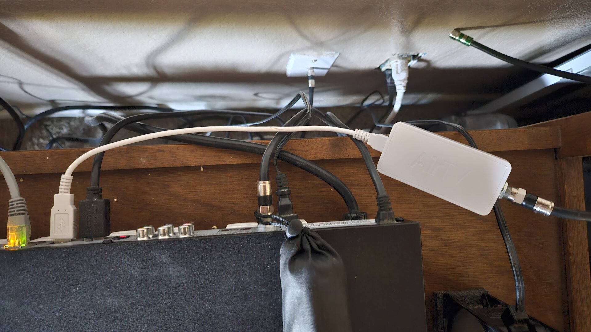

The Dish dual tuner OTA adapter (latest and greatest) looks like this only is black.
The USB cable is built in and is about 12" long. The older dual tuner adapter is problematic (tends to overheat).
Mine is from AirTV but the inards (circuit board) are identical. It is not terribly sensitive.
The older Dish dual tuner adapter has a detachable USB cable.
