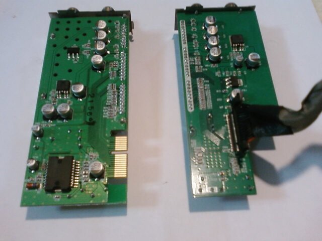

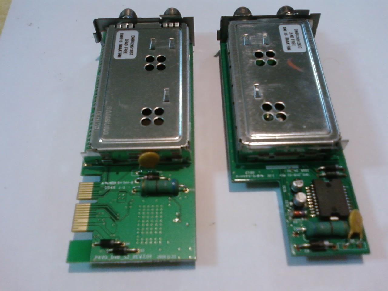

For discussion and FYI purposes, here are the two different DVB-S2 tuners for the AZBox Premium and the Premium Plus. In the attached photos, the tuner on the left is from the Premium Plus receiver. The tuner on the right is from the original Premium model.
The identification numbers that I can read on the tuners are:
Original Premium
DNBU24512|CC
090116 BAAATRM
Premium Plus
DNBU24513|ST
090916 NAAATRM
The Premium Plus tuner has SAMSUNG stamped into the metal shield. The original doesn't have any make shown. I am not entirely certain what the character preceeding the "CC" and the "ST" actually is. It appears to be a straight vertical line, like some delineator, but it could also be a lower case "L". It is difficult to make it out.
The tuner from the Premium Plus has two circuit board edge connectors (eleven contacts on one and seven on the other). On one side of the board, there are two pairs which are doubled - you will be able to see them in the second pix.
The tuner from the original Premium has a removable ribbon cable with 31 pins (or at least there are 31 receptacles -they may not all be utilized).
Another difference is the IF IN and the LOOP OUT F-connectors. On the original Premium DVB-S2 tuner, the LOOP OUT connector is on the top. On the Premium Plus DVB-S2 tuner, the IF IN connector is on the top.

That tuner on the right appears to be exactly like the one that is in my Elite, ie, ribbon cable connection only to the motherboard. That would make sense as the original Premium and Elite probably used the same motherboard but the Premium had an external power supply, which made room for an internally mounted hard drive.
