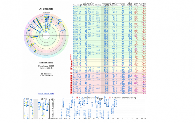

Sure thing. Here's my report.
WJLP is 6 miles away and yet I can't seem to reliably get it in alongside other channels (like WNXY, WBQM, WDVB etc.) that are even closer that I can't get in at all, whereas I have relatively few issues getting WLIW from 29 miles away. I don't really get it, so I'm just kind of curious how this all works and what I might be able to do about it.

Ah, I see WJLP is a VHF-LO station on channel 3. That's probably the issue. Those flat digital antennas don't really do a good job handling VHF-LO.

WJLP is a LOW band VHF station, it's on RF3. That means you need a large (due to long wavelength at that frequency) outdoor low band vhf antenna to get it. It's also very affected by any strong FM radio stations, and any electrical interference nearby.
The little patch UHF antennas can't get it.

Do you have access to the roof of your building? If they'd let you put even a small outdoor antenna out there, or just outside the window of your apartment, you could probably pull it off. VHF-LO is kind of a specialty niche, I don't have any VHF-LO channels here, so I'll defer to the experts on what you could use to pull those stations in ;)

As others have noted, WJLP is on low-VHF and will require a real antenna to receive. At my grandmother's house in Fair Lawn, NJ, I can just barely decode it with rabbit ears, and even the antenna in the attic doesn't do much with it. (You can see the live reception from that location at this address: https://m.rabbitears.info/index.php?request=tvdx_grid&tid=10343612&tno=1 )
WDVB-CD is side-mounted on the Empire State Building and you're in the spot where their directional antenna is falling off. It may not be receivable depending on where it's mounted and other specifics like that which aren't part of the FCC database.
WBQM-LD was running an empty transport stream last time I was in the area. It was on the air, but broadcasting no programming. If that's still the case, you could very well be receiving the signal but not seeing it on your TV.
To my knowledge, WNXY-LD simulcasts with WXNY-LD and WNYX-LD and is thus completely redundant. I wouldn't waste any time on it, and I was unable to confirm that it is on the air last time I was in the area.
