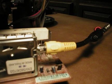

Take the back housing off of your TV. You may have to unscrew the small nut holding the threaded connector to the TV. This threaded connector should connect to the motherboard with a male RCA prong that should be soldered to the component on the motherboard. You will need to carefully cut
& remove the old soldering & wiggle the connector off. This is the hardest part, but it WILL come off with a little trying.
Now get your coax cable and strip off about 2" of the black outside housing ONLY. Your solid copper` interior cable should be protected by a small plastic coating which is covered in braided wire. You'll need to be careful not to cut the braiding off. Untangle the braiding down to where your cut stops and try and get it all on one side of the cable so you can twist it all together and make a nice wire. Now strip about an inch off of your interior plastic sheathing to reveal the small solid copper wire on the very inside.
Get your RCA cable and cut about 6" off of the one yellow side. Follow the same process above to get a braided sheathing wire and a solid copper wire. Attach this yellow wire to the coaxial cable by twisting the two braided wires together and the two solid copper wires together. Use your wire nuts & electrical tape to secure your connections making sure none of the wires can touch each other.
Connect the yellow cable's male prong into the component on the motherboard and attach your coaxial coupler to the male end of your coaxial cable. If you saved the small nut from earlier, you can re-attach this new coupler to the housing on your TV. Screw your housing back on the TV and you should be good to go.

[FONT=Frutiger55Roman,BoldItalic][FONT=Frutiger55Roman,BoldItalic]This TV has RCA input for the antenna. It came with an adapter to connect to a coax cable. If lost, Radio Shack may have one, look for Video Adapter - RCA Male to F-Type Female.[/FONT][/FONT]​
[FONT=Frutiger55Roman,BoldItalic][FONT=Frutiger55Roman,BoldItalic]As others had mentioned this TV has an analog tuner so you will need a converter box for digital OTA.[/FONT][/FONT][FONT=Frutiger55Roman,BoldItalic]​
[FONT=Frutiger55Roman,BoldItalic]To connect a TV signal source to the display:[/FONT]
[/FONT]​
1. Insert coax-to-RCA adapter into the antenna (ANT) jack on the bottom of the display.
2. Connect a coax cable between the adapter and TV signal
source (for example, a cable box, satellite receiver, or antenna).
