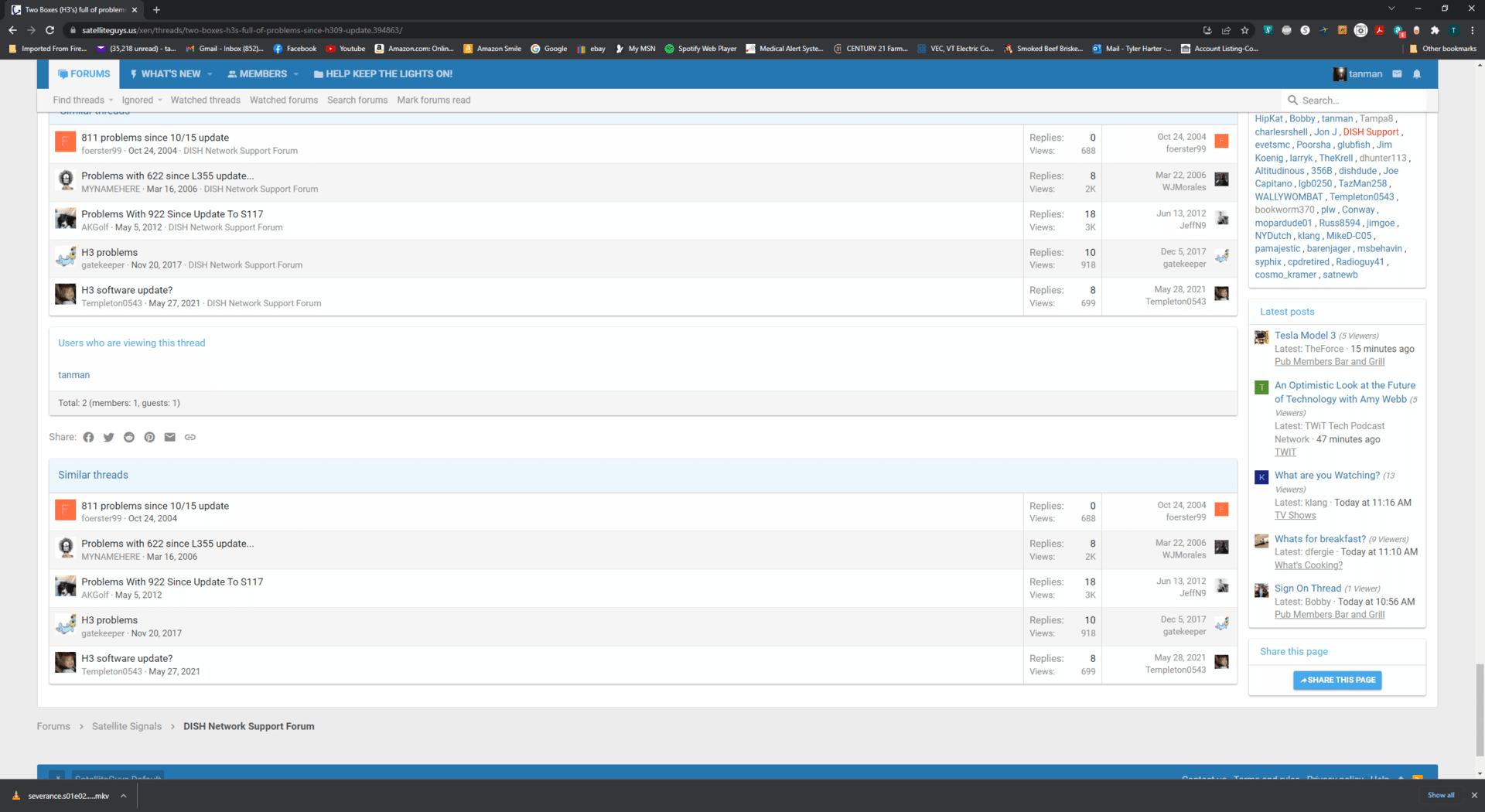

I'm not sure when it started but it seems it is a recent change to this forum to have a "similar threads" area right below the last post.I don't have an issue at all with that (actually could be helpful) but it is slightly annoying that it is repeated right below itself!
  • Two Boxes (H3's) full of problems since H309 update . . . _ SatelliteGuys.US - Google Chrome 2...png
