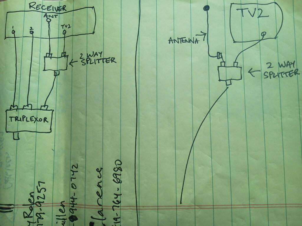

I have a 622 with the diplexer thing on it and a single TV in the bedroom. My UHF remote barely works from the bedroom and then only if I an find a sweet spot to point to. I have reprogrammed the remote channel several times and it makes no difference. Also fresh batteries.
I have also put the UHF antenna on a short coax and set it up higher in the cabinet ... not much better.
Is there a simple solution to make the remote function better?
For some reason it also seems to be worse at night if that is even possible. I'm not in a crowded neighborhood and there are only the two of us in the house so nothing inside is interfering.
Thanks
Get two splitters. Combine antenna and TV2 to line going to bedroom. Un-split at TV, putting antenna at bedroom TV.
Will any splitter (2 x 1) do or do I need something special?
OK ... thanks for the info and help. I have a couple and will do it.
Like this
