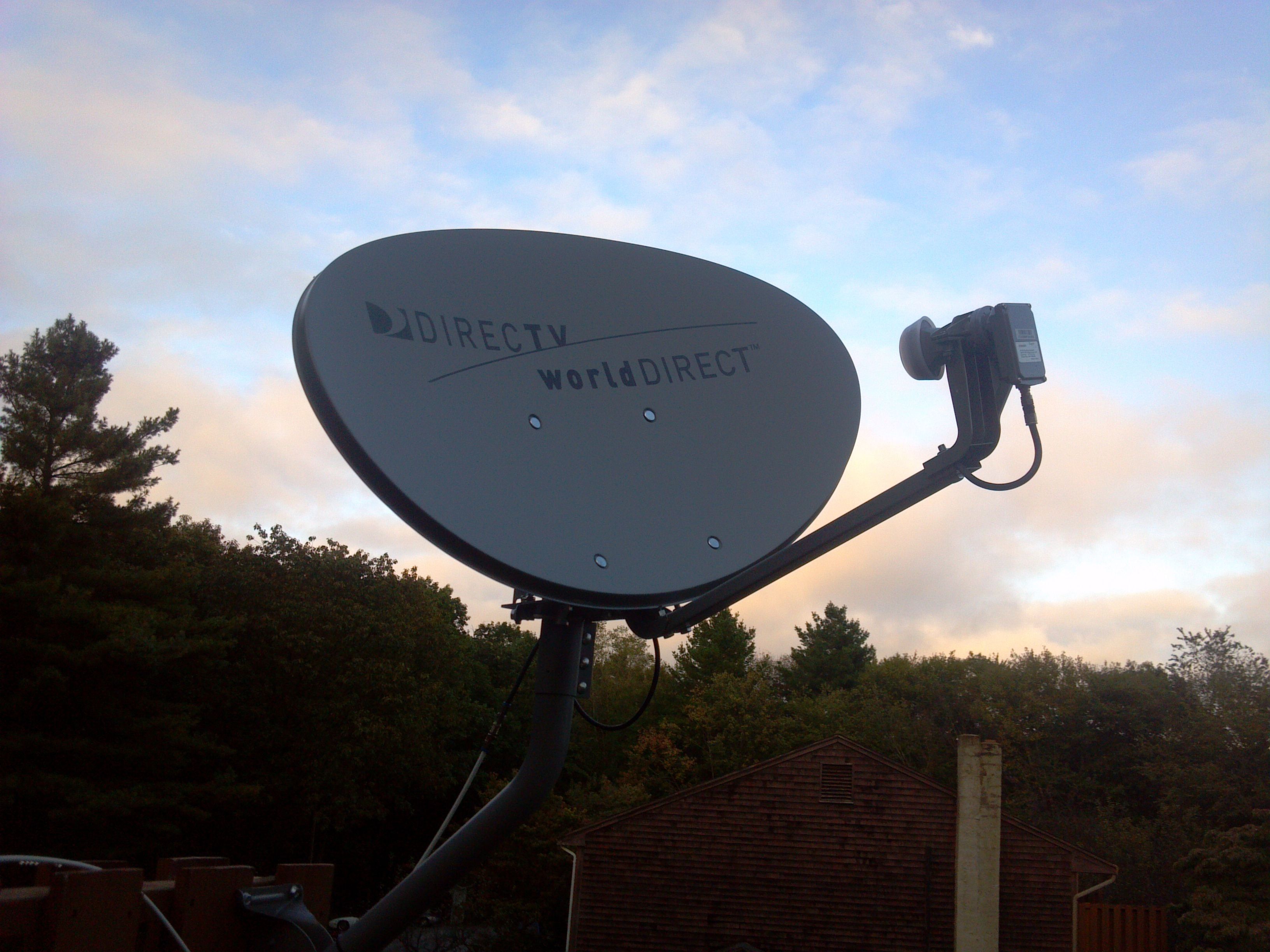

the dish is mounted in the balcony and is stationary so i can't move it

Adjusting dish aiming and LNBF skew does no involve relocating the dish. Just because channels come in from other transponders, doesn't mean that the dish is properly aimed.

Your dish is a bit on the small side for many of the weaker transponders on this satellite. It requires the dish to be exactly aimed to receive a transponders. There is little margin for error with smaller dishes.
Whenever I can't get one or two transponders on Galaxy 19, it is almost always because the dish is just a hair off of the proper alignment. A slight adjustment at your dish with your portable TV and receiver will probably help you bring in those channels with ease :) Is it really difficult to get up to the dish?

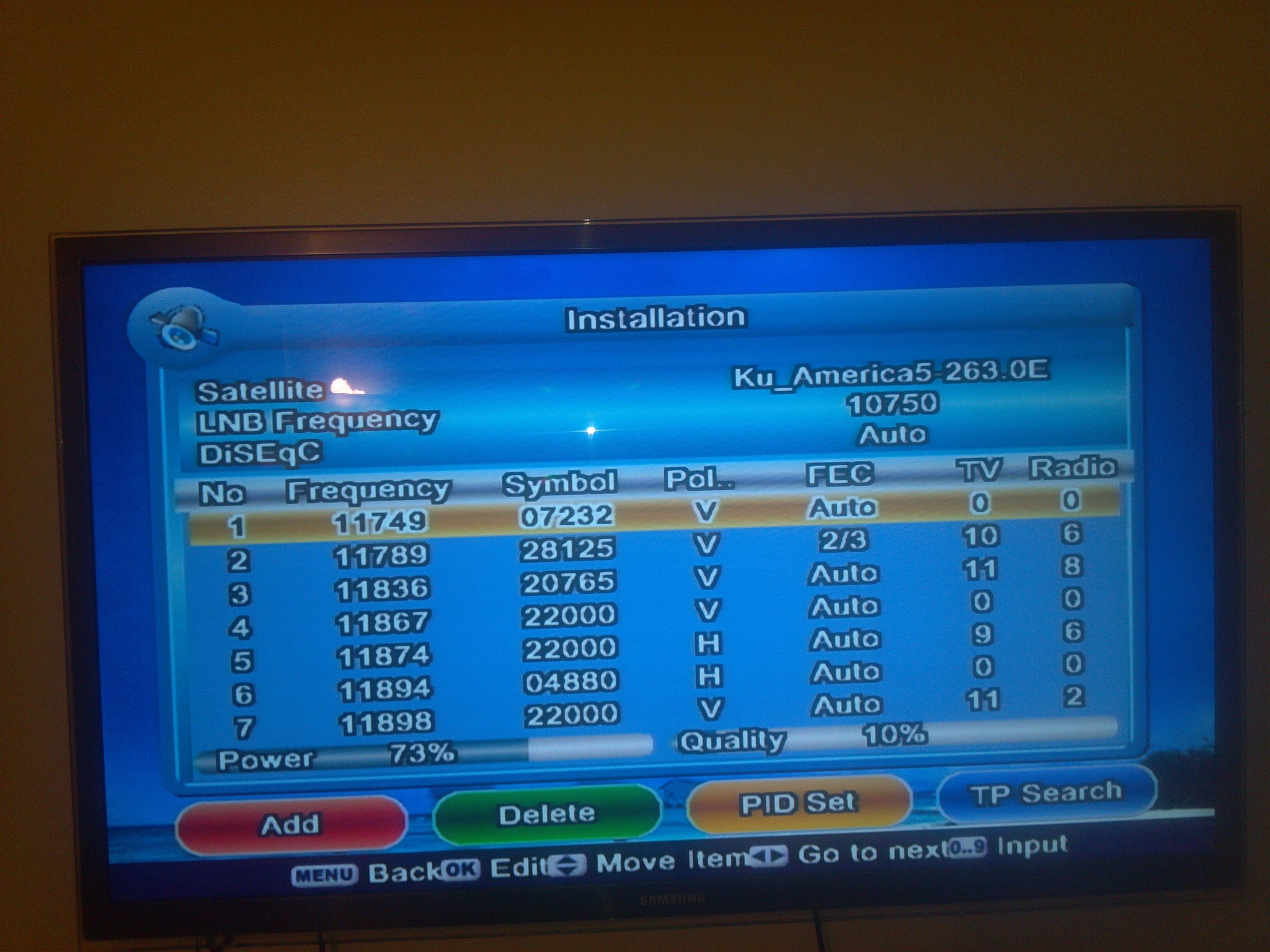

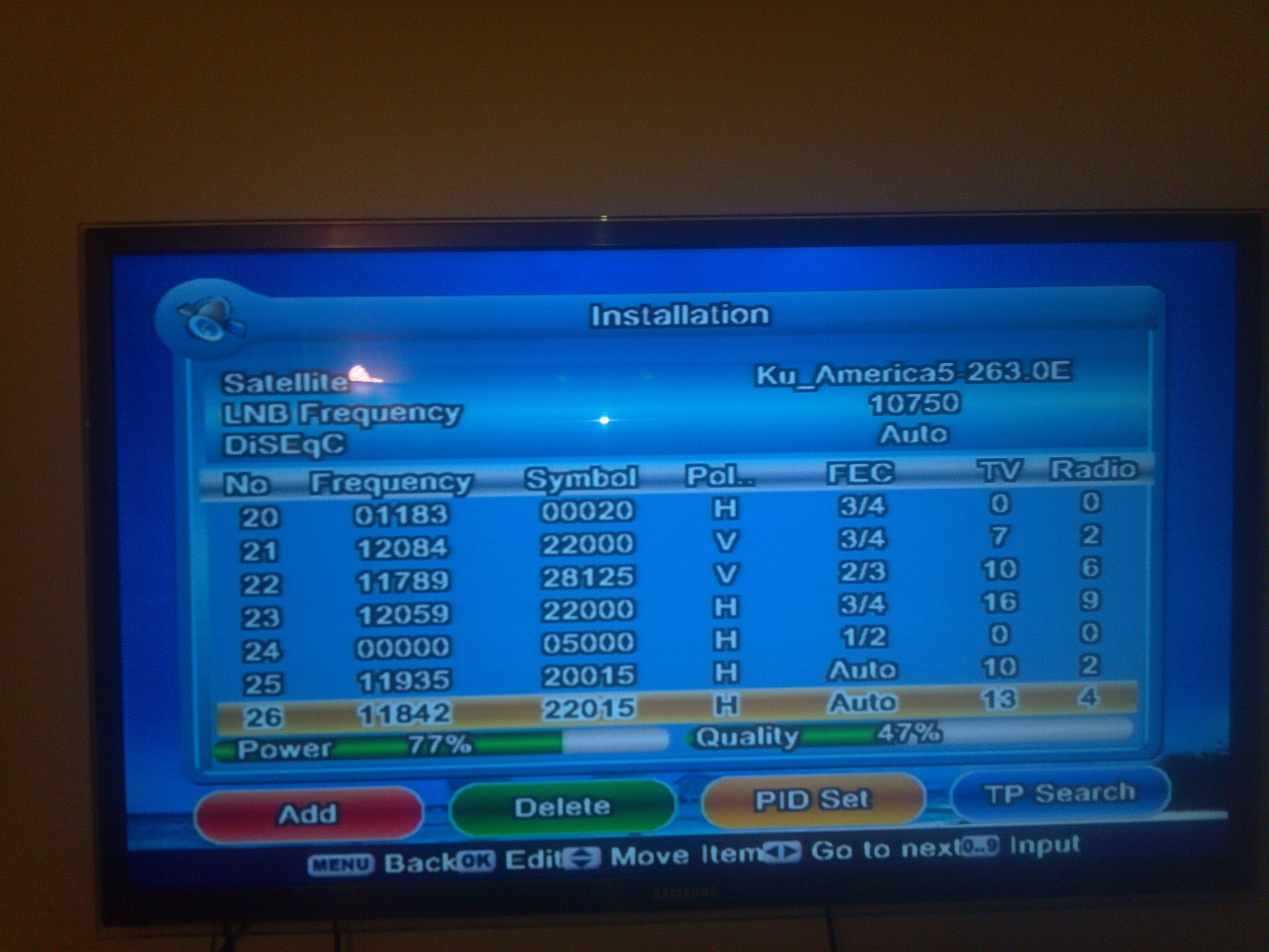

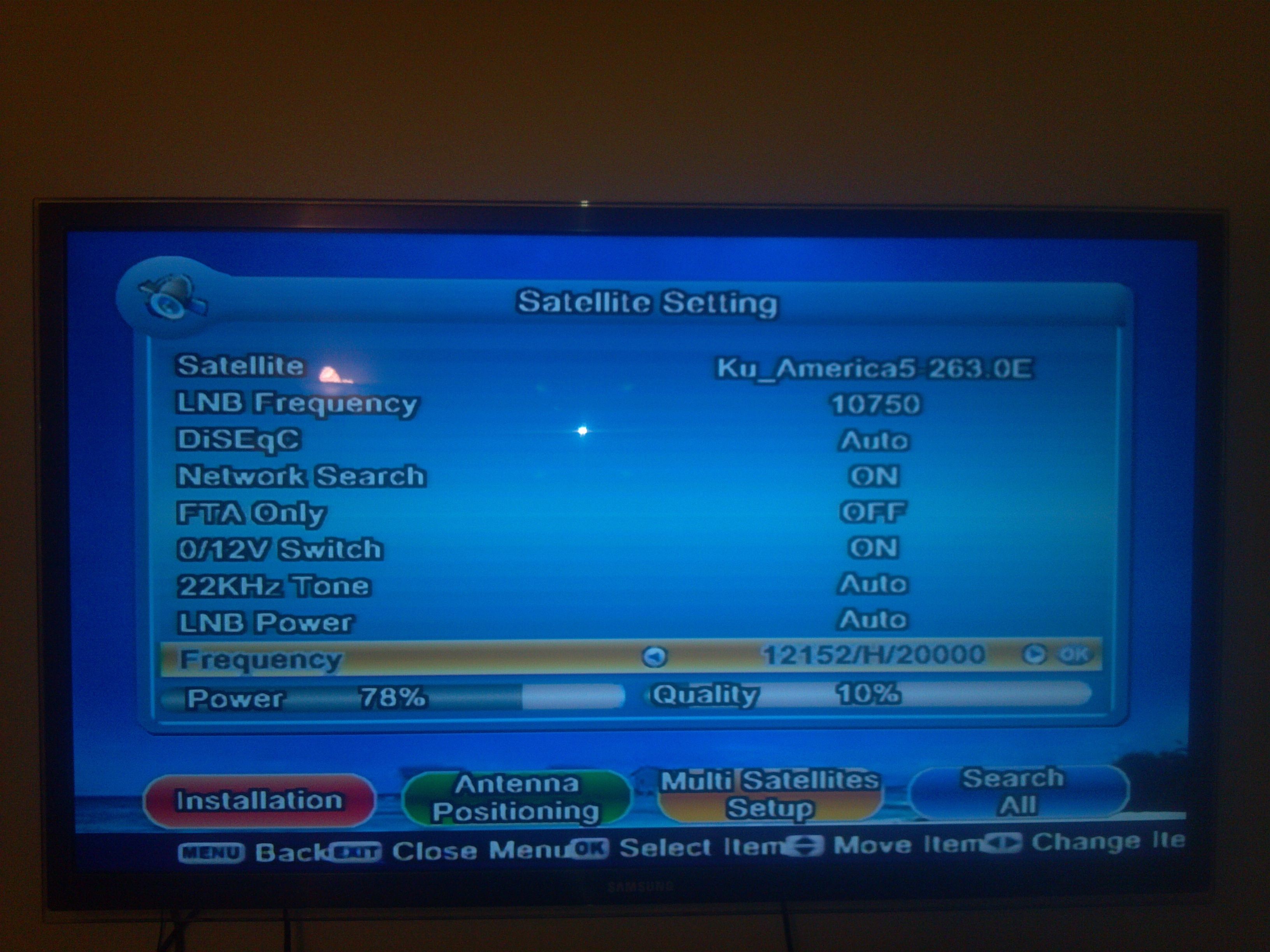

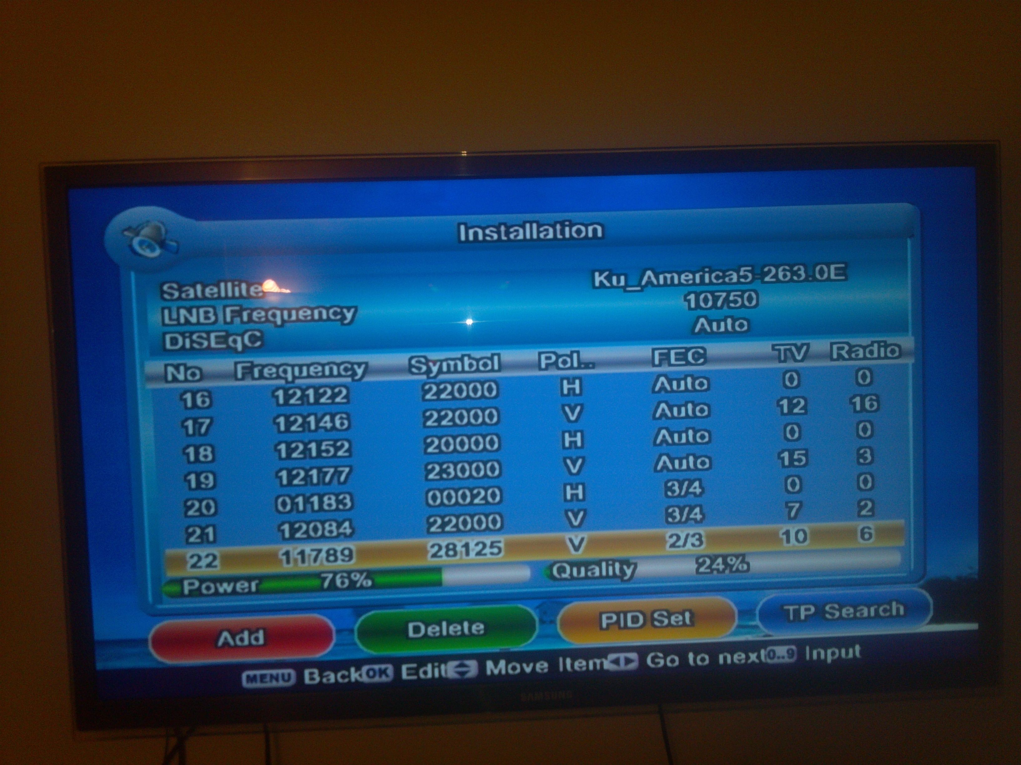

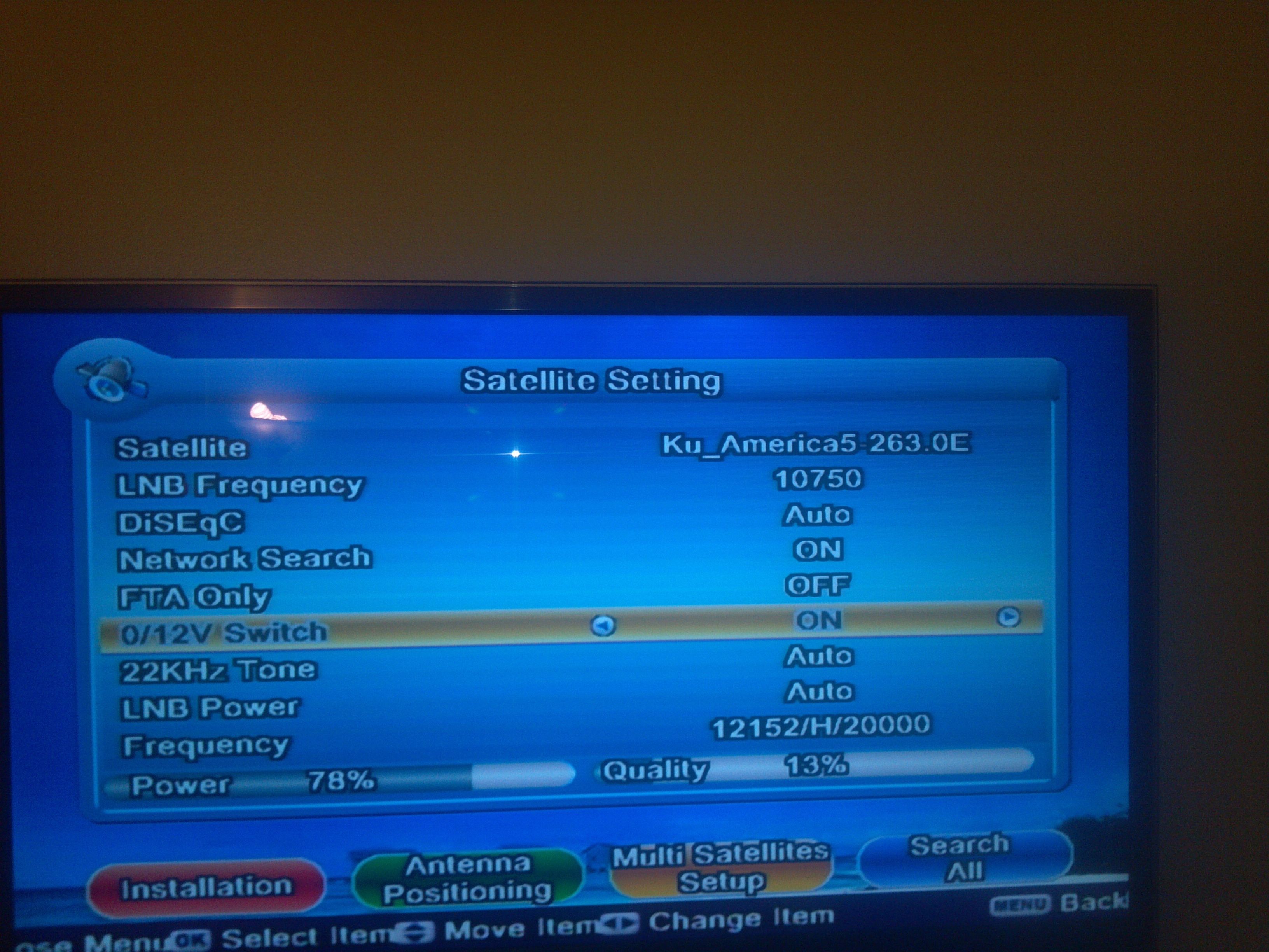

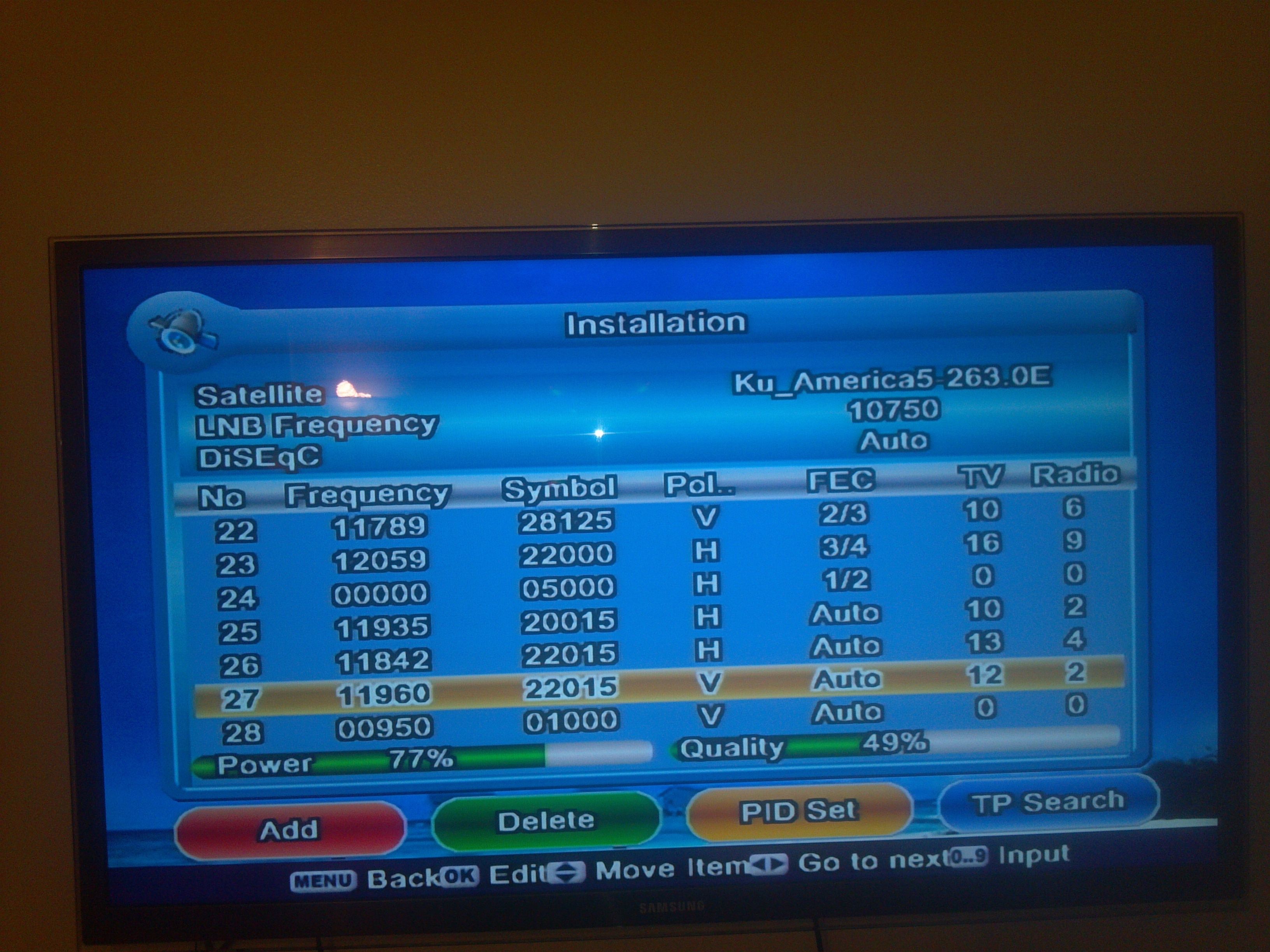

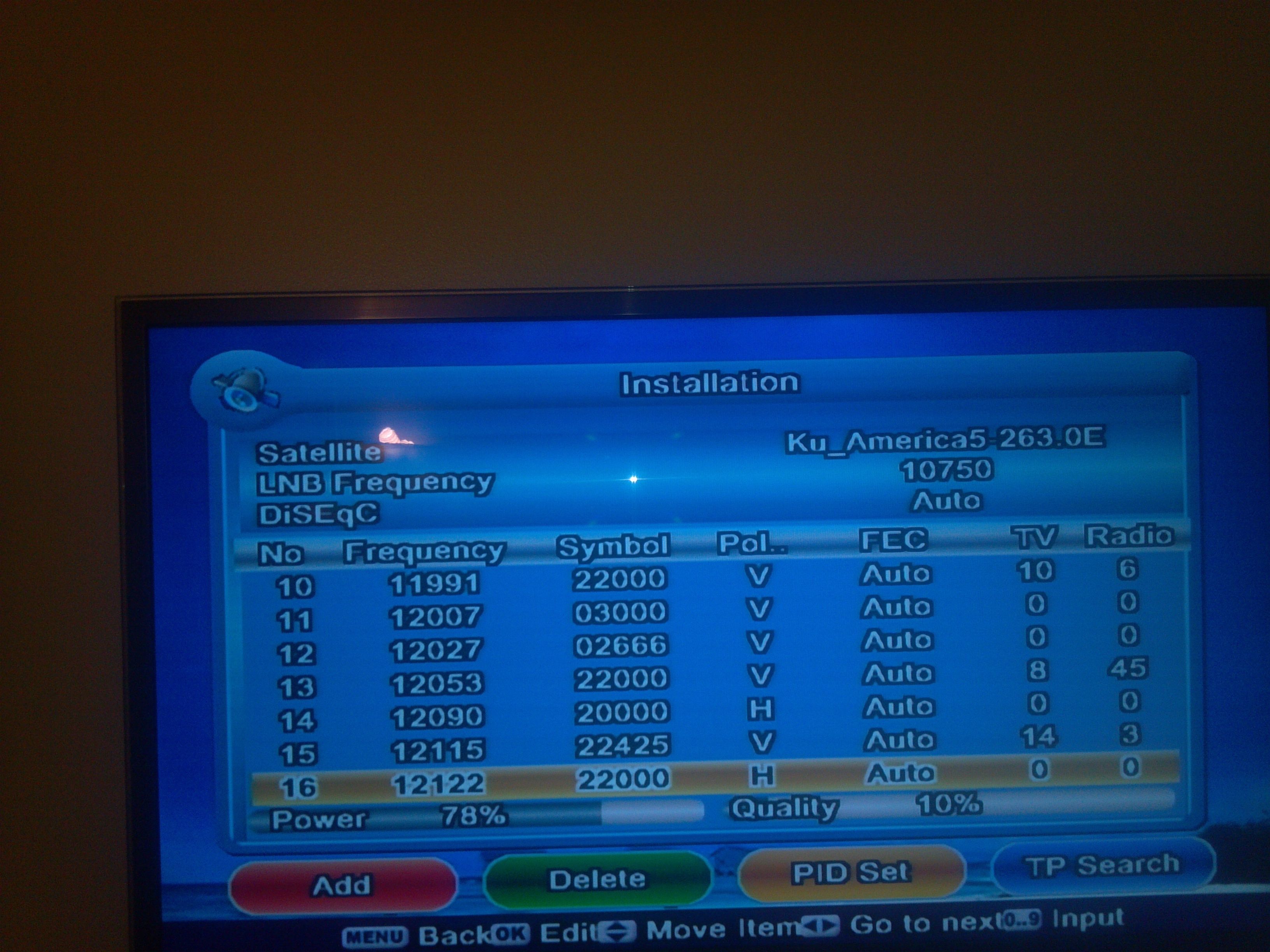

attached are some picture i took .
so pretty much I get all the channels FTA and encrypted from Galaxy 19(25) except for the one from transponder 12152 H
tp 26
Strange??

No, it is not strange.
Follow our repeated suggestions to take a TV out to the dish and make small adjustments to the dish aiming and LNBF skew.
It sounds like you want an easier solution, but we don't believe this is related to any receiver setting.
Time to get out a ladder or hire a technician!
Get into the tune up screen and watch the QUALITY reading on 12152. Position your TV so you can see the screen while at the back of the dish. Gently, but firmly, push on the dish (up down, left right) one at a time and hold for a few seconds. Does any of these tests increase the QUALITY reading? (don't loosen any nuts or bolts for this)
If all directions lower the QUALITY reading it looks like a bigger dish is required.
Looks like the dish is bolted to a wooden fence.
Not the most stable platform, and possibly the source of your trouble.
Appears to be readily acccessable.

Also those numbers for quality look low which is why you are probably losing 12152 TP. I know for me I had to peak the dish on that to get it to be stable
12152 TP is a strong transponder on my setup on my 1 meter dish. When i use the slimline setup I had it about 45% Q you should get about 45 to 55 Q on your setup but take your time to get everything right but that TP is a strong transponder to get in. I watch it before I went to work coming in just fine at my house.
