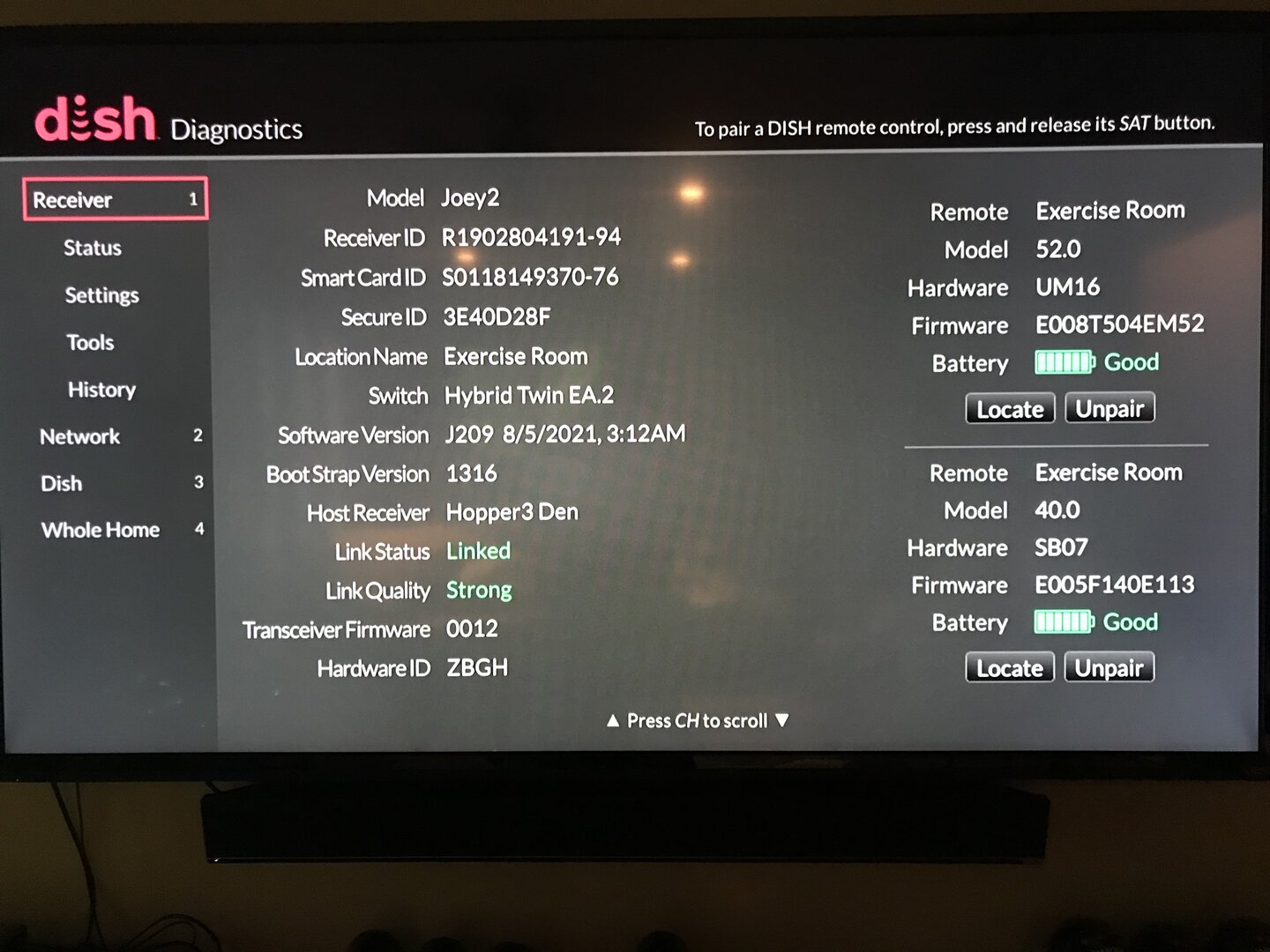

So, I pressed system info on Joey 2. The tv screen changed to Diagnostics showing remote info. Then, I pressed Sat on the narrow side of remote 54.3. (yes, I pulled the clear plastic from battery section.) Then, back. SAT on remote briefly flashed. And, nothing! It won't pair. I even replaced the installed Duracell batteries with new ones. That didn't work either.
I also use older remote (model 40) with this Joey 2. It was very easy to pair in the past. Naturally, I thought perhaps Joey 2 has a limit of 2 remote controls. I unpaired this old remote, tried with remote 54.3. Nope. I paired joey 2 with old model 40 remote. As soon as I pressed SAT button on it, it beeped and info popped up under the original remote (52) on the screen.
When I try to pair 53.4, it never beeps. The lights on remote briefly come on when I press on buttons, but Joey 2 does not respond at all. Also, diagnostics page does not list this remote.

Thanks for the suggestions. Unpairing old remote (40) that I hardly use was very easy. Diagnostics page. Select 'unpair' with 40. Gone. That did not help with linking 54.3 to Joey.
When I press SAT on 54.3, only SAT flashes, nothing else.

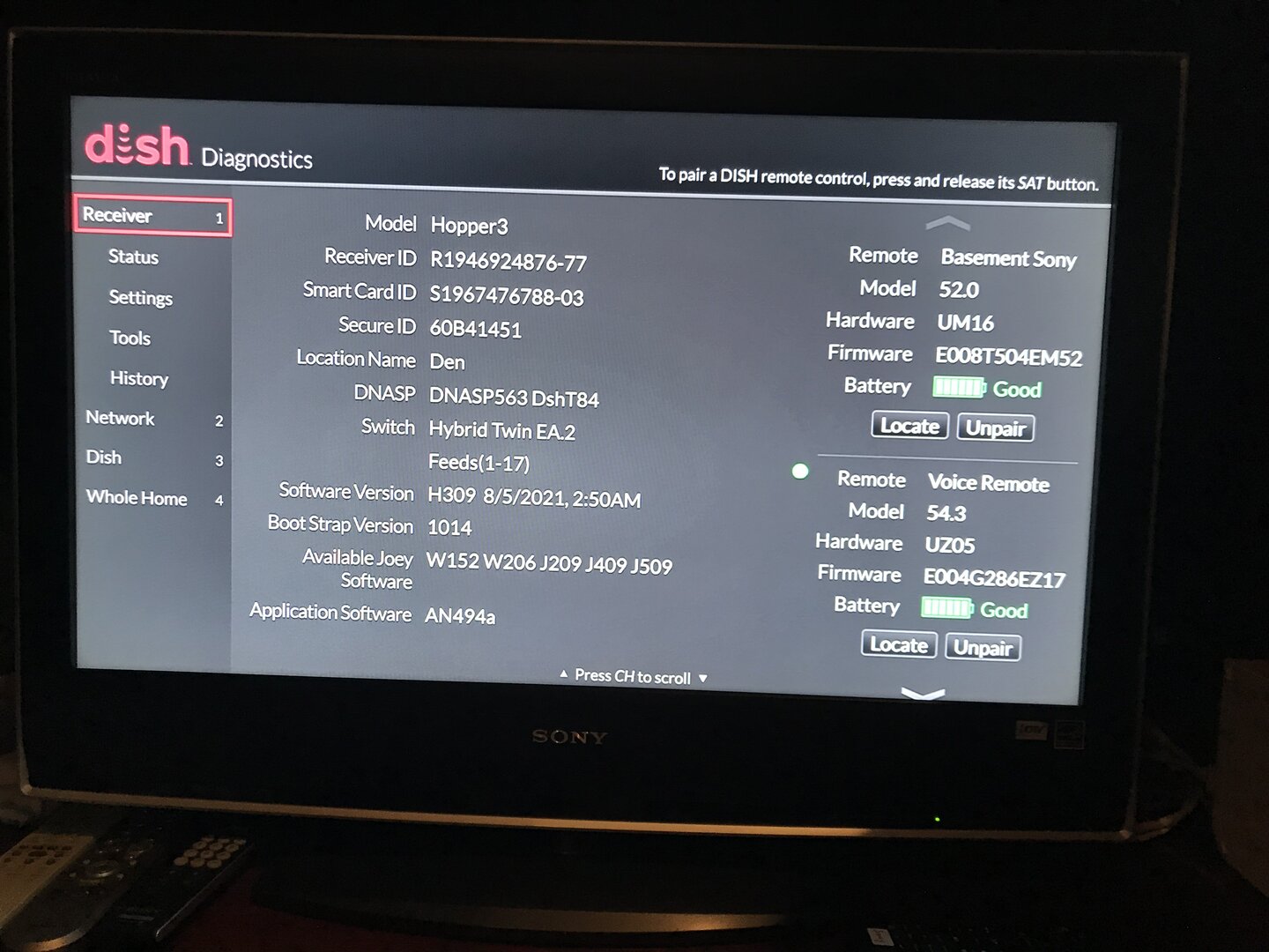

Now, this is getting more interesting. I tried to pair 54.3 with Hopper 3. It worked like charm! Right away. The new remote works fine with Hopper 3.
Unfortunately, my daily tv is connected to that particular Joey.
Does this mean Joey is somehow defective or won't accept voice remote?

Appreciate it Bobby. I paired that new remote with Hopper 3, and it worked. Do I need to unpair before I try it with kitchen Joey? I probably do. Just need someone to confirm this dummy.
I went ahead and unpaired 54.3 remote with Hopper 3 as suggested. ( That was temporary anyway.) It paired with kitchen Joey2! Now, diagnostics for that Joey 2 show 2 remotes, 52 and 54.3. So, it wasn't remote causing trouble.
