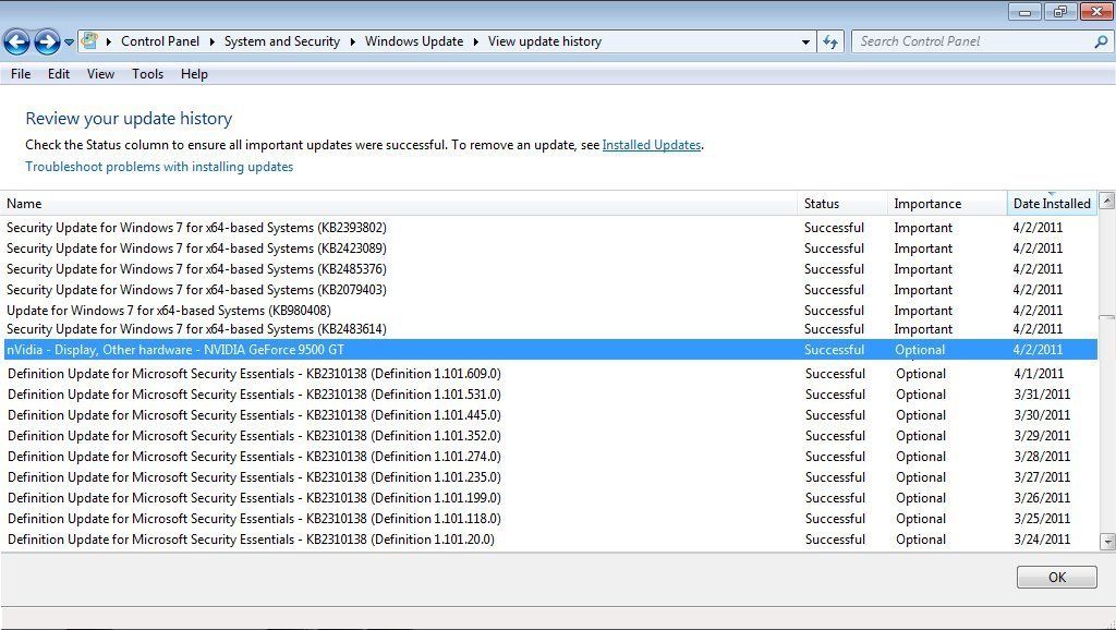

One thing that stood out to me though was the notice that my Nvidia display driver needed updating. Ok, fine. Do it..
After the update (done via Microsoft Update) I got a notice by the microsoft updater that the Nvidia drivers were damaged and needed to be repaired. Oh oh..

I have a screen shot that shows the microsoft installed Nvidia driver but when I go to the other screen that lets you uninstall driver updates, it is not listed by name, only a long list of drivers named KBxxxxxxxx.... :(
No descriptions at all, just cryptic file names that are all pretty much the same thing. It's totally impossible to tell what all those drivers are for and I'm afraid to just start uninstalling stuff at random.

I attached a screen shot of the suspect, or at least what I suspect is the big problem. But really, there are so many other problems that I'm thinking it might be best just to start it over. I just don't know how to go about starting over without losing important stuff..

Wow, rotten luck Dee. I'm no windows expert but I believe I would start with uninstalling the video card driver (windows calls 'em Display Adapters, I think) and reboot. When it comes back up, if it wants to look for a new video driver-point it to the new one you downloaded, where you stored it on the hard drive, and see if that kicks it in the pants. All those KBxxxxx things are updates you downloaded, it could be that one of them borked your OS-it has happened before. I used to stick to only the critical updates when I used windows, and even then-the same thing happened to me before also. Once I think I had to 'uninstall' about 6 so-called updates before I got the computer going again. Then, sure enough, a couple of days later MS put out a "fix" to one of their updates!

Open Device Manager - Display Adapters - your adapter - Uninstall Driver. Reboot and reinstall the driver.
