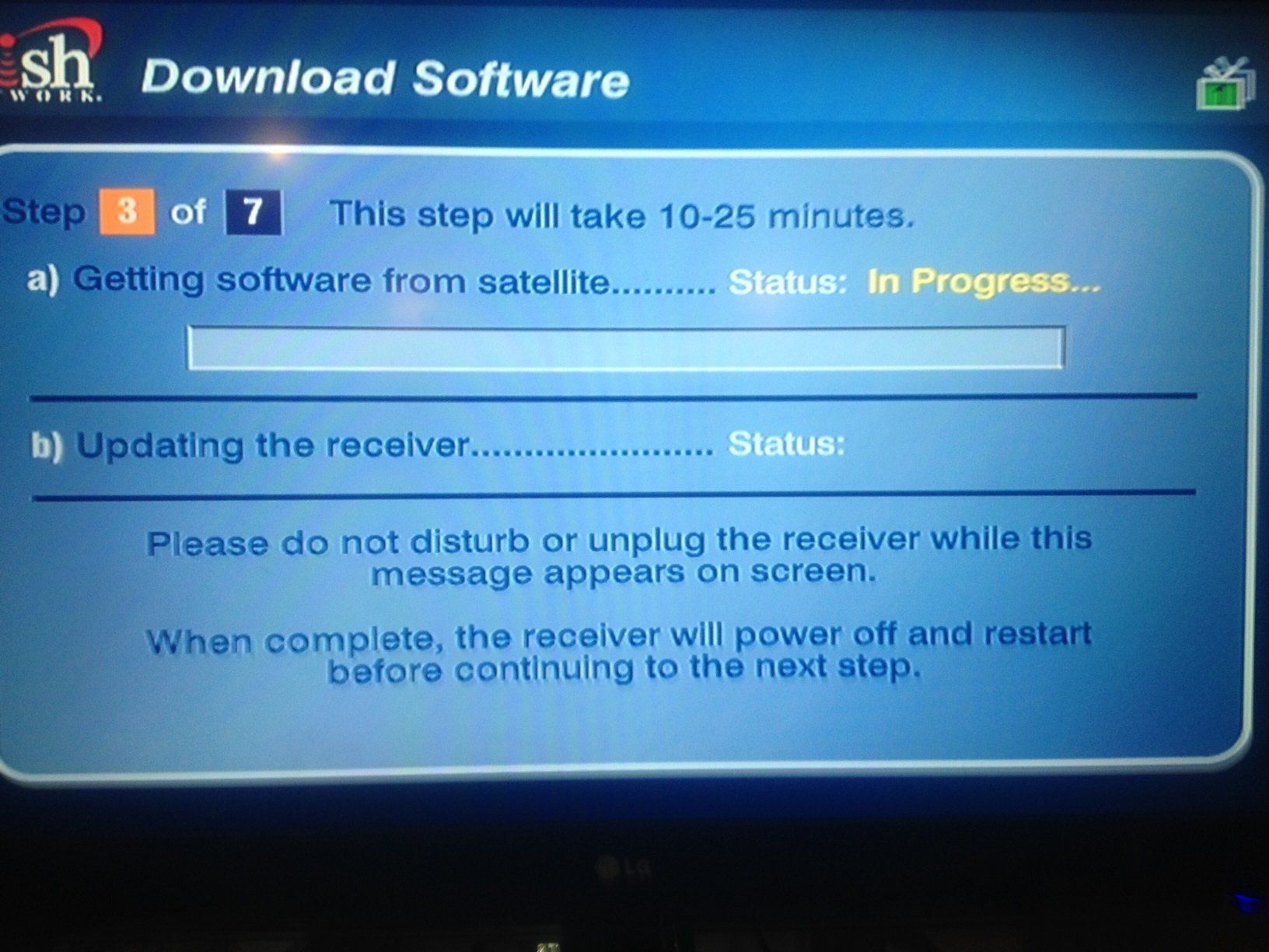

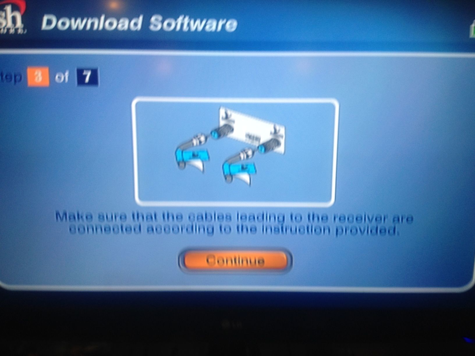

I have already tried to connect both of the ports from the Legacy Twin LNB to the VIP222K and it doest work it hangs on step 3 getting software from satellite and after it hangs for awhile another screen comes up make sure i have it connected. I will supply some pictures.

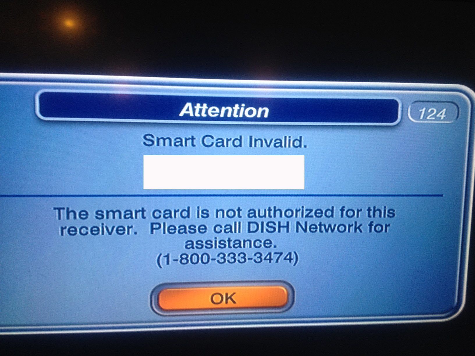

Also the smart card isn't in the VIP222K reciever when it is trying to download software, and i get a error message when i put my smartcard from my DP301 into the VIP222K attached is a picture of the message. I blocked out the reciever number and smart card number.
I assume this error message is just because i haven't registered the VIP222K to my account thru Dish, and really don't want to until i get the connection issue figured out.

When hooked up to the 222 reciever it hangs on task 3 of 7(getting software from satellite) and will eventually display an error telling me to make sure the connections are connected correctly.

I feel kinda stupid. I called my LNB a twin in my first post, but sadley i was mistaken.
What i have is a dual LNBF - which is just a single eye with 2 ports on it. Which i found is really old LOL.
The twin which is what Iceberg said would work has 2 eyes on it and has 1 port for each eye.
Sorry to have wasted your time. I did learn something though. Thanks again.

New receivers start off with the smart card built in and the slot is for when added security measures are needed, also the physical cards are married to a receiver and cannot be moved to another one, that is why the error message.
I was gonna mention that if it was a legacy twin you would have had a 21 switch in the system somewhere. Seems like you figured out what you need. Easiest way would be a dpp twin and just use that same line down to the triplexer on the receiver. Make sure you DON'T try and re-use the old smartcard as it will not work.
