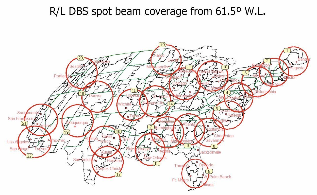

What do you have to tp 15? I'm in Northern VA as well, although 'moved' to NY. I get a lock for tp 15, but I'm wondering if we're under a different spotbeam area for tp 15 other than NY.
I tried deciphering the Rainbow 1 spotbeam map on dbstalk, but 'Area 6' doesn't match up well on the map.

From the other thread quoted above, here are the spotbeam capabilities for the satellite versus transponder number. We are under spotbeam 4, while NY is under spotbeam 3.
01: 1, 3, 7, 15, 17
02: 5, 9, 11, 13, 21
03: 1, 3, 7, 15, 17, 19, 23
04: 5, 9, 11, 13, 21
05: 1, 3, 7, 15, 17, 19, 23
06: 1, 3, 7, 15, 17, 19, 23
07: 5, 9, 11, 13, 21
08: 5, 9, 11, 13
09: 1, 3, 7, 9, 15, 17, 19, 23
10: 1, 3, 7, 15, 17, 19, 23
11: 5, 9, 11, 13, 21
12: 1, 3, 7, 15, 17, 19, 23
13: 1, 3, 7, 15, 17, 19, 23
14: 1, 3, 7, 15, 17, 19, 23
15: 5, 11, 13, 21
16: 1, 3, 7, 15, 17, 19, 23
17: 5, 9, 11, 13, 21
18: 1, 3, 7, 9, 15, 17, 19, 23
19: 5, 11, 13, 21
20: 5, 11, 13, 17, 21
21: 1, 3, 7, 15, 17, 19, 23
22: 5, 9, 11, 13, 21
Thanks again Mike!
Note that adjacent spotbeams do not have any transponders in common. So, if we are receiving anything under spotbeam 4 for transponder 15, then it's coming from either spotbeam area 3 (for NY) or 5 (for North Carolina).
There are a few confusing items. Dish appears to use different numbering for the spot beams than the original Rainbow 1 maps used (see attached map). Also they uplink 2 spots from each uplink center. These are internal numbers, and I am sure they mean something to Dish, so when you see the map for R1, be aware that the Dish numbers are different than the numbers that appear on the map. The numbers posted above from my earlier post represent the spot TPs based on this attached map.
Also be aware that the circles are just estimates of the spots from early data on the satellite design before launch and represent approximate coverage based on a certain power level and estimated dish size.
It is also not clear what Dish will do with the space from TPs 17 (NY) and 21 (Boston). They may convert to spot beam usage. Dish will have to make a decision of more local markets verses more national HD. You will notice in the above list E12 can use TP 17 over 13 spots and TP 21 over 9 different spots. So a potential of 30 LiL HD market TPs or 12-14 national HD channels.
TP 16 cannot be used in spot beam mode, so it looks free, unless they want to move content from 19, or 23 to TP 16 to make one of them spot.
Not having AMC-14 really hurt Dish, they now have to decide between more national or more LiL HD. Right now TPs 17, 19, 21 and 23 could work in either spot beam or national content, we will have to see what Dish decides to do with them.

I also get low 30's for 17, 19, and 21. I actually get a 45 for tp15. Bizarre given that it seems I shouldn't get a signal. NoVA is between the NY and NC spotbeams, assuming that the NC spotbeam carries tp15 as well.
